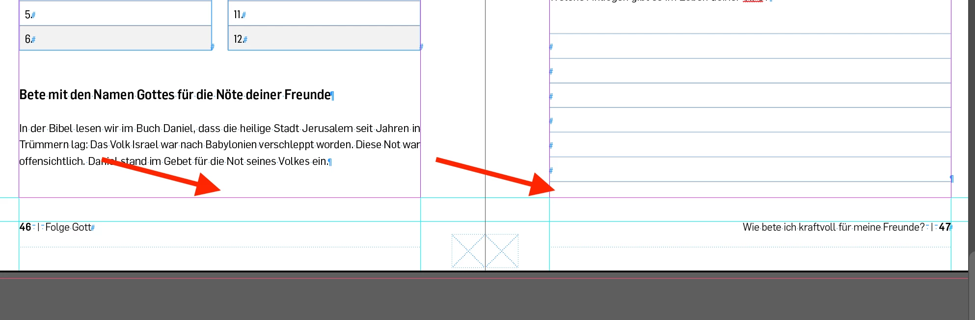

I’m a bit unsure how to explain this question, but basically, on many of my pages, the text doesn’t fully extend to the bottom. I think this is mainly due to the way my layout is set up and my efforts to avoid widows and orphans. I’ve noticed that "famous" books also have this issue, so I assume it’s something I just have to accept. However, it feels like it’s happening too often in my book. Is there a way to fix or adjust this, or do I just need to accept it?
I am unable to adjust the copy.
Thank you very much for any help!

As @James Gifford—NitroPress said - you've too many elements that affect the text flow.
If you want to fill text to the last line - you would've to play with text - expand - to push something further down - or contract - to bring something back from the next page.
On your top example - you could expand your text on the right slightly - to make extra line.

In flowing text like novels and nonfiction narrative, it's a mark of good design to have all lines aligned across columns and pages, and to have text lines right to the bottom of each page.
In any more complex layout, with headings, tables, and varying types of formatting, empty lines at the bottom of pages are accepted as the tradeoff for not doing a huge amount of work to balance the use of every style in every combination.
Having good page esthetics does not necessarily mean geometric rigor and precision, that is.

Thank you for the advice! I will definitely see if there are possible improvements, but overall, I won’t stress as much about it.
