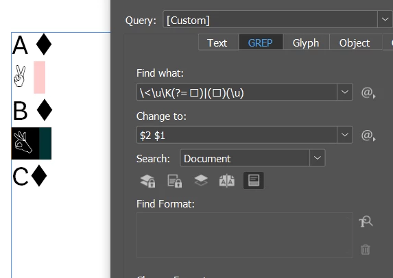

When I do this grep search it works
\<\u\K(?=)|()(\u)
But it changes the font ---
Never noticed it did that before
Thought it only swapped 2 with 1
Odd.
Robert at ID-Tasker
May 4, 2024
@Eugene Tyson
Because when you change found result - InDesign is changing text contents - so any "extra" formatting is lost.
That's why I've suggested look ahead / behind - or simply replacing this glyph with some unique text.
