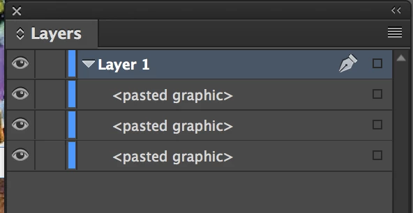

This is not a new problem. I found this InDesignSecrets.com post from 2006 which points out the pasted graphics don't show up in the Links panel. Pasting basically takes control of the process from InDesign.
http://indesignsecrets.com/copy-and-paste-vs-place.php
If you want an Embedded Graphic, you select a linked graphics and choose to Embed it from the Links panel menu. Then it shows up in the Links panel with a special icon.
However, a pasted graphic does show up in the Layers panel as a <pasted graphic>:
There is no preflight option, but here's a couple things you could look for in Preflight:
* Choose IMAGES and OBJECTS and look for low resolution images using Image Resolution. They are almost certainly low res images
* When I tested with images from Photoshop and Mac Preview, Preview made the graphics transparent. So you can also turn on Transparency Not Allowed. Photoshop doesn't make the transparent when you copy and paste.
Good luck.
