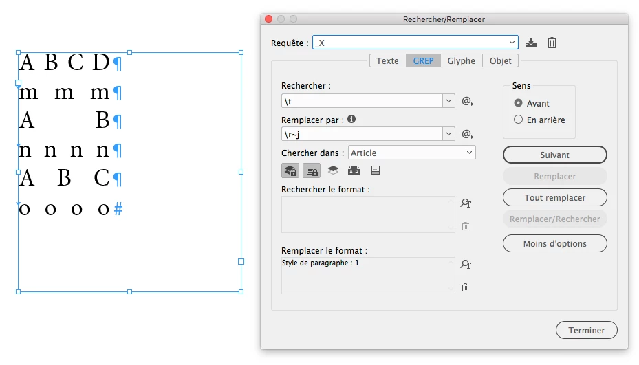

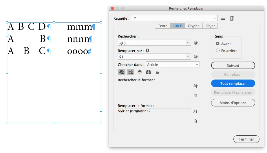

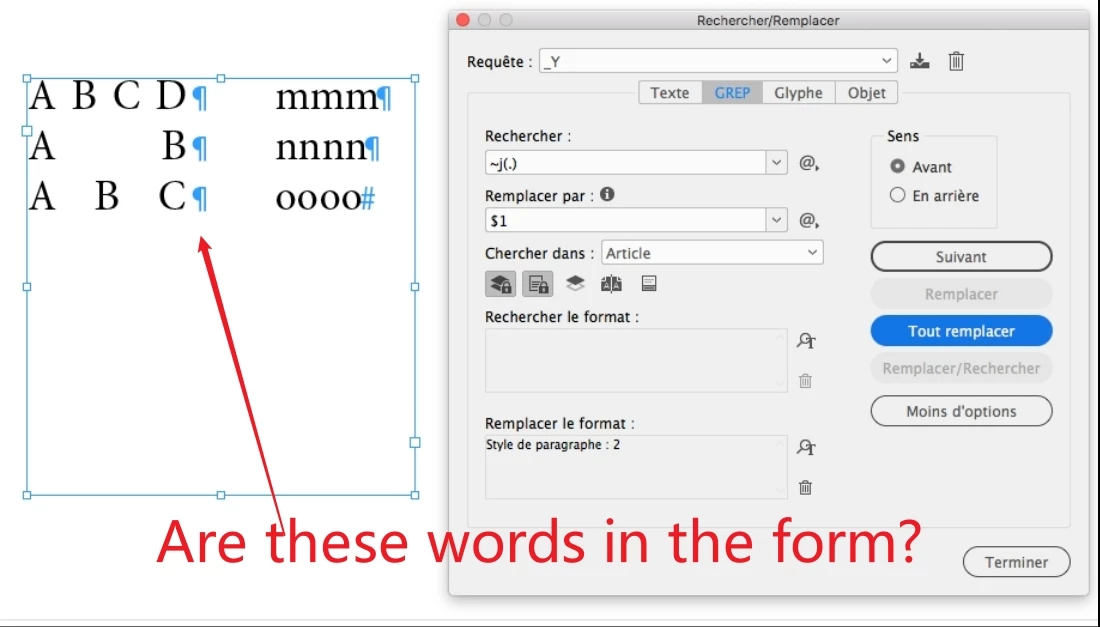

FRIdNGE
January 22, 2021
Just 2 para styles and 2 Grep Find/Replace!
(^/)  The Jedi

And what's the picture?
Is it a form?
I don't want to use a form?
I think the best is paragraph style + grep, calling character style

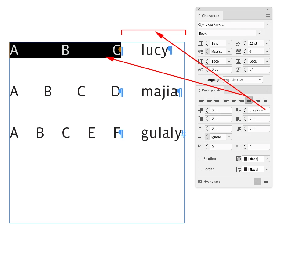

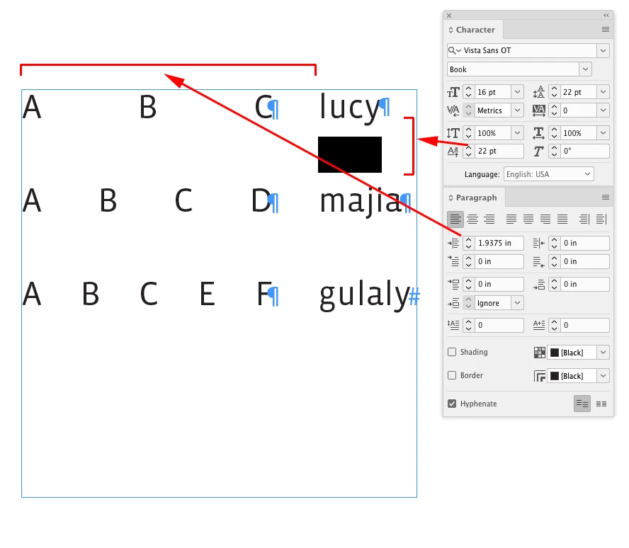

rob day
January 25, 2021
The line is two paragraphs with a baseline shift applied to the second paragraph to align it with the first paragraph. You could do it but I think a table is going to be easier to edit:
Set the first paragraph to fully justify with a Right Indent to clear the width of the second paragraph:
Set the 2nd paragraph to Align Left with a Baseline Shift equal to the Leading, and a Left Indent large enough to clear the first paragraph:

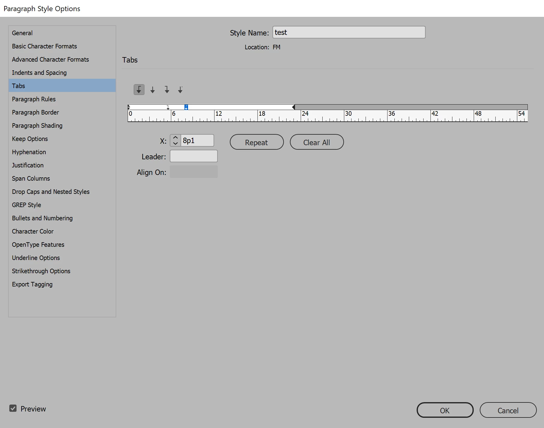

January 22, 2021
I would recommend using tabs. Create a paragraph style for this text, then in the options for it, go to Tabs. There you can set places for where you want each name to line up. The example I set up for you below shows the first tab as being right aligned (look very closely at the top of the arrow shortly before the 6) and the second one being left aligned (currently hightlighed in blue because it's selected). So you will need to put a tab character in before the first name and between the first name and the second name to get them to line up at the tab stops you created. You can drag and drop these tab stops to modify them, but I find it easier to do once you have your text on the page and can watch it move. If you want to have dots going between them, that's what the Leader box is for. You can just do a "." or you can do " ." (space then period) to have it spaced out more, etc.
Hope this helps!
January 22, 2021
Sorry, if you're new to tabs, you click on the gray arrows above the ruler to pick which alignment you want (see the example above) and then click where you want it on the ruler. You can adjust the alignment of whichever tab you have highlighted in blue by clicking on a different grey arrow. You can adjust the tab position by dragging and dropping it elsewhere on the ruler. And if you no longer want that tab, drag it off the ruler and it will go away.

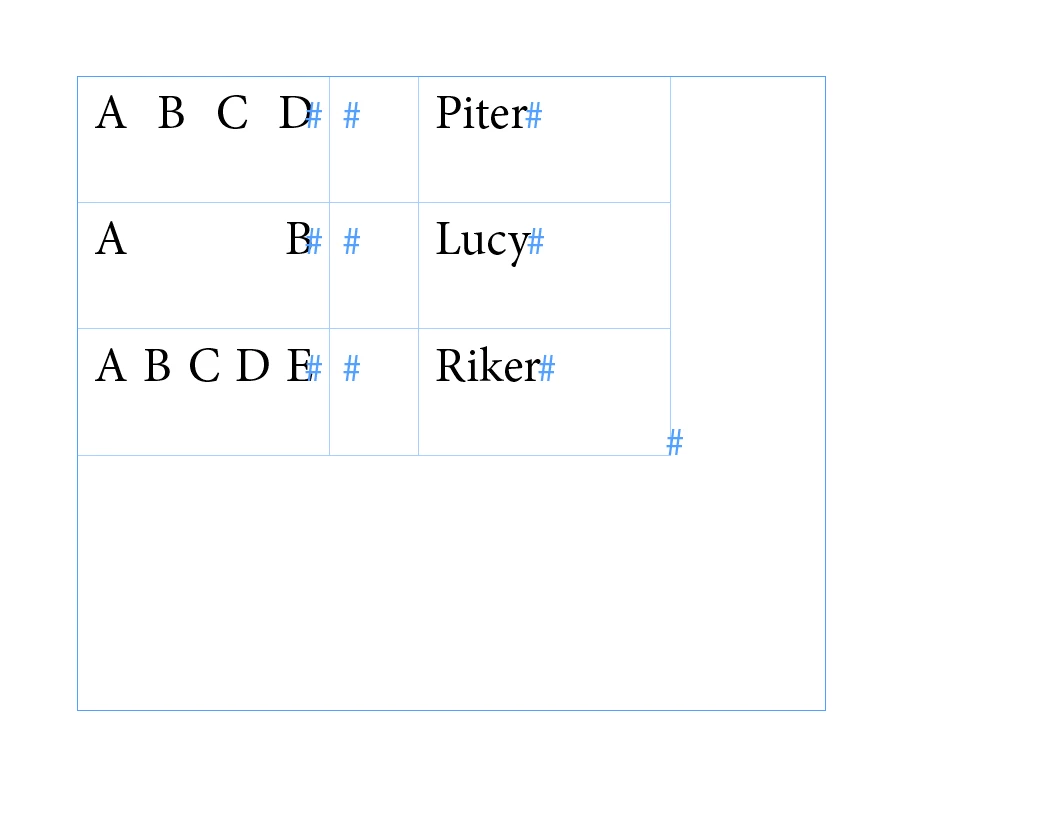

Scott Citron
Brainiac
January 20, 2021
The first thing I would do is create a table for this text. Doing so would allow you to delete the En or Em Spaces you've used to separate the two columns.
