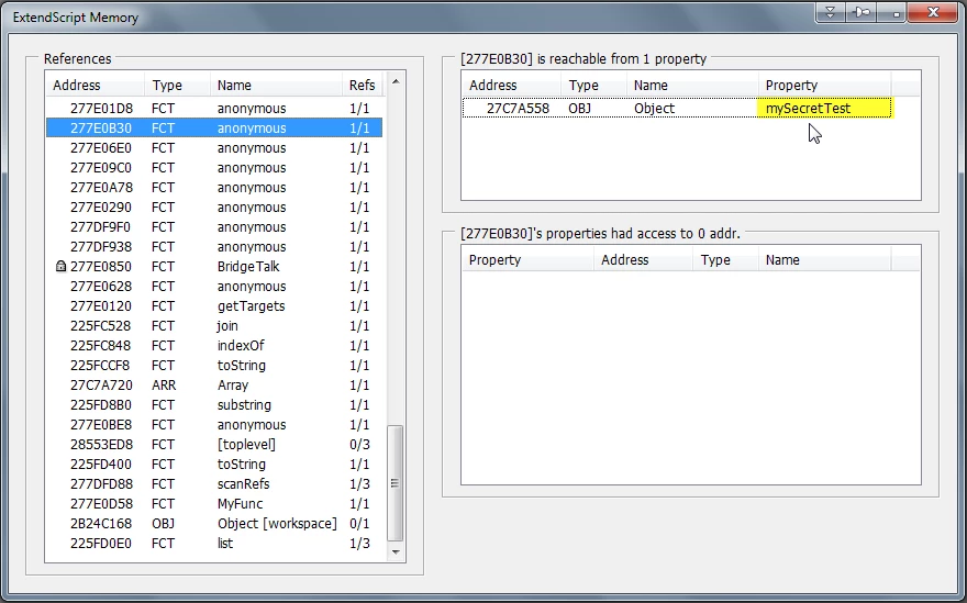

P.s. Marc any idea what this is or how to investigate it's properties?!
Also where did you see about $.list I didn't see that documented anywhere? Are the any other undocumented $ functions?

@ Trevor
According to your own screenshot, mySecretTest is a property that refers to an anonymous function which you can access from an object located at [27C7A558] in your ExtendScript memory. I guess that this object is $.global.indesign. It contains a lot of preloaded properties and methods. $.global.indesign.mySecretTest.toSource() reveals that this is an empty function (no effect).
Tip: use $.scanRefs(0) to ignore this huge set of preloaded objects that mainly come from ESTK's workspace.
> Also where did you see about $.list?
My own investigations on hidden stuff ;-)
Nice ones in that scope are $.list(), $.listLO(), and $.summary().
Il also noticed that $.objects (hidden numeric property) returns the count of created objects.
