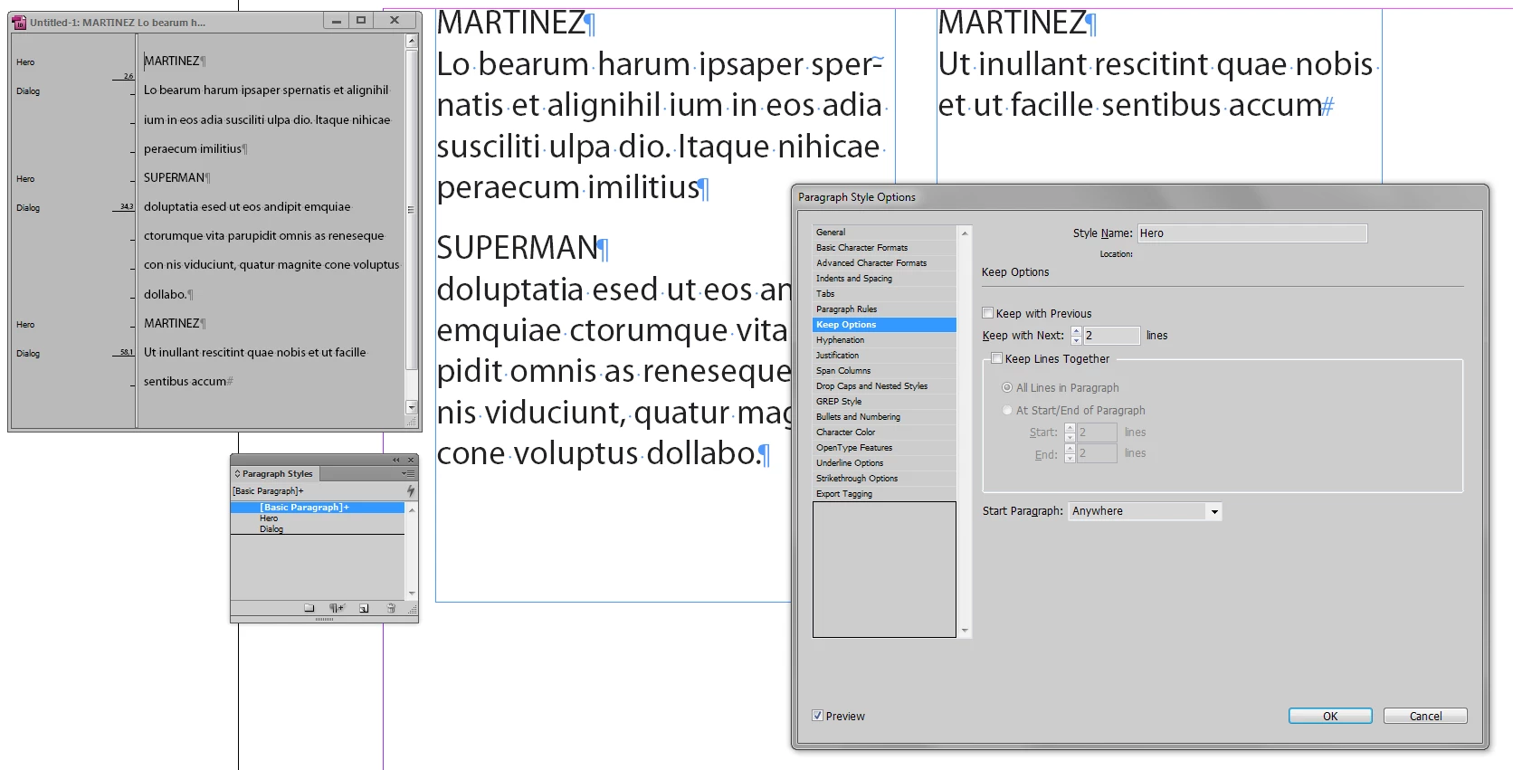

I am formatting a play in InDesign CC and having problems. When I close-up one line it throws others off.
  • February 5, 2017
  • 2034 views
Here's an example. Superman's dialogue should be separated from the line for Martinez above it.  When I separate the lines, it throws other lines off on other pages. So when I fix these problems, it just creates others.
MARTINEZ
Why forced?
SUPERMAN
The paper was bought by Rupert Murdoch.
MARTINEZ
And now?
    Correct answer winterm
    When I use the return key the spacing becomes correct, but then other lines are thrown off.  I will try creating a new paragraph style.
    I was thinking I might try turning off "allow shuffle"  ?
    Thanks for your help.

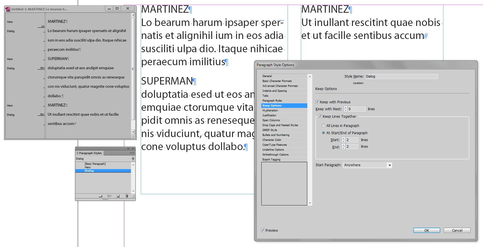

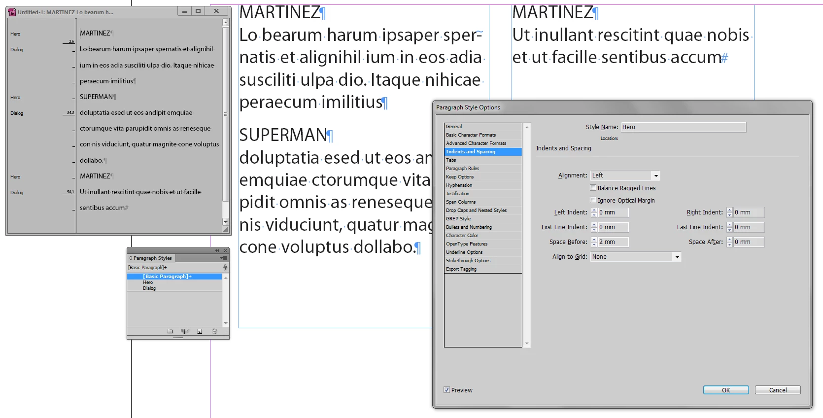

    Some basic highlights how to handle text like yours...
