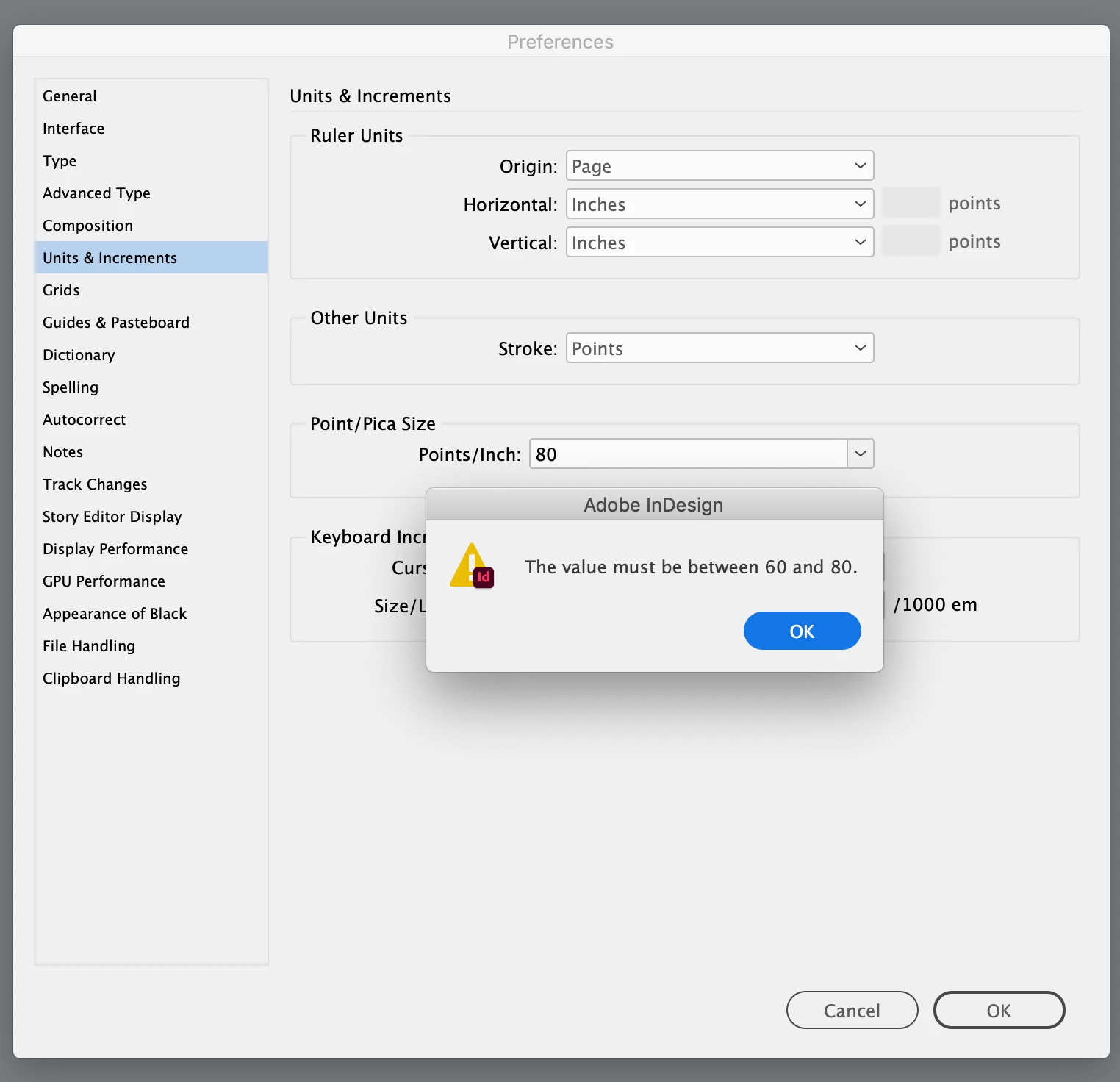

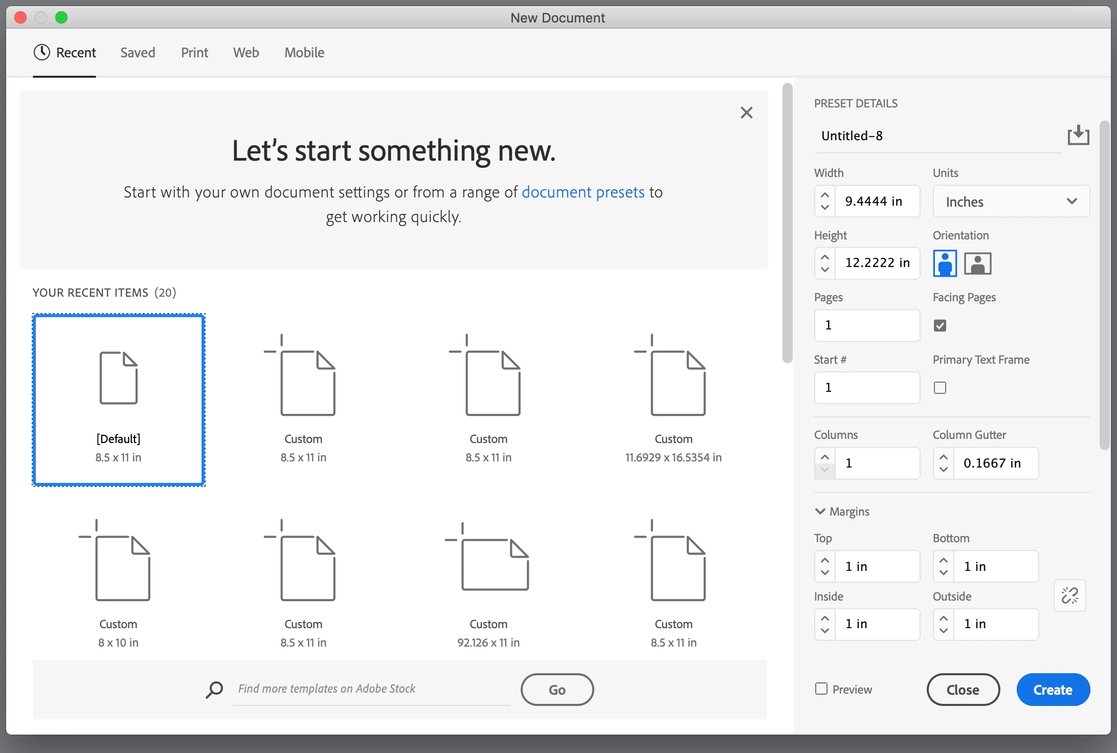

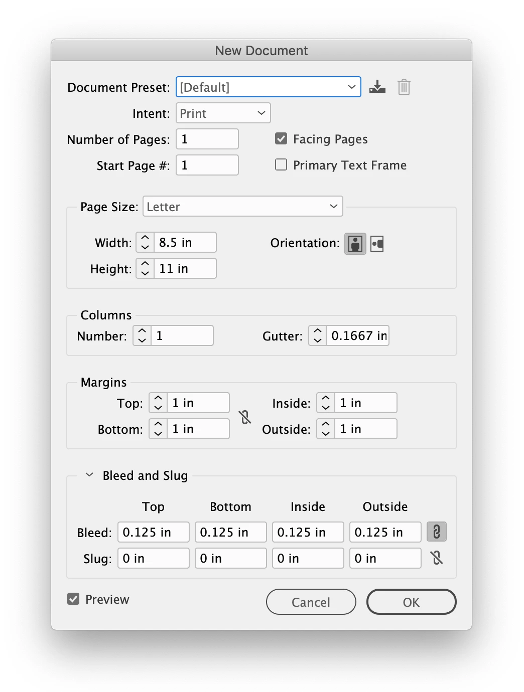

Hi Uwe, It’s not obvious, but Points/Inch can be user defined—any number between 60 and 80:
If I set it to 80, I get this for Letter:
But with the Use Legacy New Document Dialog set in General Prefs I get this:
