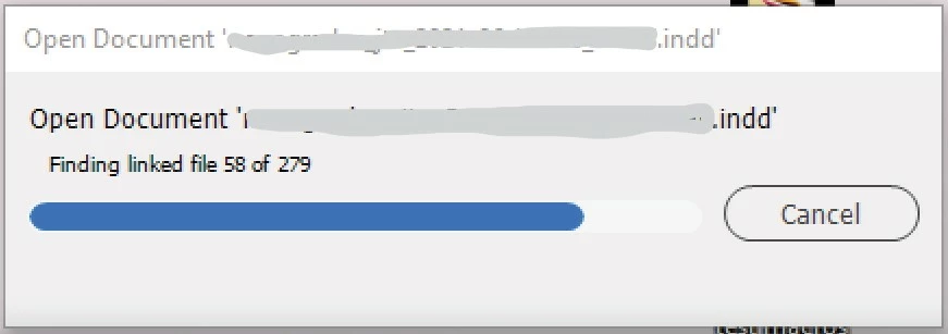

When I open them it says it is finding 279 linked files or more sometimes even though the file actualy only has a dozen or less.(please see atached images)
Why does it say I have so many linked files when I do not? Is it leftover data? can it be cleared?
Here is the loading screen when it is opening my file. "Finding linked file 58 of 279"

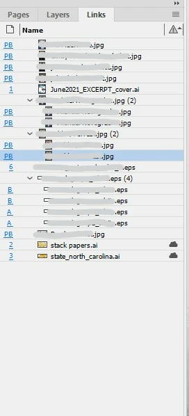

This is my links panel showing that the file actually only has 17 links.

UPDATE!   Since making this post, I have figured out the only solution. Its not as easy as changing a setting, but it is as easy as saving the file differently. A file that used to take me 45-60 minutes to open, now only takes about 2 minutes each time.
The Problem: We reuse the same file over and over again in our organization. Every month, we "save as", "FileName_Month", and I layout our magazene, and then the next month, I save as again, basicly overwriting the file each time but as a new file. The issue is, Even though I'm saving a new file and the file size might be smaller than the previous month, each time, indesign is holding on to little pieces of excess artifact data in the background that it stores in the file and doesn't know how to get rid of for some reason. Over the corse of a year or many years(in our case) the excess data in the file gets a really bulky and confusing for indesign to open.
The solution: Once every few months(or when your file starts to get slow), save the file as an .IMDL file(its a cs4 file) and then resave that as your normal indesign file again. This will cause indesign to recreate the entire file from scratch deleting any extra leftover artifact data in the background. Like i said before, A file that used to take me 45-60 minutes to open, now only takes about 2 minutes each time. When opening times start to get slow again, I just redo the process again.
This also seems to fix: weird issues where indesign crashes when you copy or delete a corrupt piece of text. If your file is acting weird and there is no obvious solution, this is always worth trying.
If this works for you, please let me know in the comments!
July 13, 2022
you're right. This seem to resolve the issue. Thanks

I know this is a year old but I'm having the same issue. Do these files have tables in them? Indesign seem to count each row in the table as a "file".

I see a lot of EPS files. EPS should not be used in modern age. It can also slow down a project.
