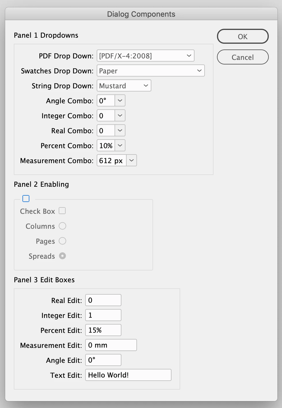

I use this a s a template for all the dialog class objects:

* Make the  dialog
* @ return void
function makeDialog(){
    //the dialog name
    var theDialog = app.dialogs.add({name:"Dialog Components", canCancel:true});
    with(theDialog){
        with(dialogColumns.add()){
            //Panel Dropdowns and Combos
            with(dialogRows.add()){
                    staticTexts.add({staticLabel:"Panel 1 Dropdowns", staticAlignment:StaticAlignmentOptions.LEFT_ALIGN, minWidth: 150});
            with(borderPanels.add()){
                    staticTexts.add({staticLabel:"PDF Drop Down:"});
                    staticTexts.add({staticLabel:"Swatches Drop Down:"});
                    staticTexts.add({staticLabel:"String Drop Down:"});
                    staticTexts.add({staticLabel:"Angle Combo:"});
                    staticTexts.add({staticLabel:"Integer Combo:"});
                    staticTexts.add({staticLabel:"Real Combo:"});
                    staticTexts.add({staticLabel:"Percent Combo:"});
                    staticTexts.add({staticLabel:"Measurement Combo:"});
                    pdfDropdown = dropdowns.add({stringList:app.pdfExportPresets.everyItem().name, selectedIndex:3, minWidth:80});
                    colorDropdown = dropdowns.add({stringList:app.swatches.everyItem().name, selectedIndex:2, minWidth:80});
                    foodList = ["Mustard", "Relish", "Ketchup"];
                    foodDropdown = dropdowns.add({stringList:foodList, selectedIndex:0, minWidth:80});
                    angleCombo = angleComboboxes.add({stringList:["0", "90", "180"], editValue:0, maximumValue:360, minimumValue:0, smallNudge:1, largeNudge:10, minWidth:50});
                    integerCombo = integerComboboxes.add({stringList:["1", "2", "3"], editValue:0, maximumValue:100, minimumValue:0, smallNudge:1, largeNudge:10, minWidth:50});
                    realCombo = realComboboxes.add({stringList:[".1", ".2", ".3"], editValue:0, maximumValue:1, minimumValue:0, smallNudge:.01, largeNudge:.1, minWidth:50});
                    percentCombo = percentComboboxes.add({stringList:["10", "15", "20"], editValue:10, maximumValue:100, minimumValue:0, smallNudge:1, largeNudge:10, minWidth:50});
                    measureCombo = measurementComboboxes.add({stringList:[pageWidth.toString(), "600", "800", "1200", "1800"], editUnits:MeasurementUnits.PIXELS, editValue:pageWidth});
            //Panel 2 Enabling
                    staticTexts.add({staticLabel:"Panel 2 Enabling", staticAlignment:StaticAlignmentOptions.LEFT_ALIGN, minWidth: 150});
            enablePanel = enablingGroups.add({checkedState:false, minWidth:150})
            with(enablePanel){
                    staticTexts.add({staticLabel:"Check Box"});
                    staticTexts.add({staticLabel:"Columns"});
                    staticTexts.add({staticLabel:"Pages"});
                    staticTexts.add({staticLabel:"Spreads"});
                    ckBox = checkboxControls.add({checkedState:false, minWidth:150});
                    with(radiobuttonGroups.add()){
                        colRadio = radiobuttonControls.add({checkedState:true});
                        pageRadio = radiobuttonControls.add({checkedState:true});
                        spreadRadio = radiobuttonControls.add({checkedState:true});
            //Panel 3 Editable
                    staticTexts.add({staticLabel:"Panel 3 Edit Boxes", staticAlignment:StaticAlignmentOptions.LEFT_ALIGN, minWidth: 150});
                    staticTexts.add({staticLabel:"Real Edit:"});
                    staticTexts.add({staticLabel:"Integer Edit:"});
                    staticTexts.add({staticLabel:"Percent Edit:"});
                    staticTexts.add({staticLabel:"Measurement Edit:"});
                    staticTexts.add({staticLabel:"Angle Edit:"});
                    staticTexts.add({staticLabel:"Text Edit:"});
                    realEdit = realEditboxes.add({editValue:0, maximumValue:10, minimumValue:0, smallNudge:.01, largeNudge:.1, minWidth:50});
                    intEdit = integerEditboxes.add({editValue:1, maximumValue:100, minimumValue:0, smallNudge:1, largeNudge:10, minWidth:50});
                    percentEdit = percentEditboxes.add({editValue:15, maximumValue:100, minimumValue:0, smallNudge:1, largeNudge:10, minWidth:50});
                    measureEdit = measurementEditboxes.add({editUnits:MeasurementUnits.MILLIMETERS, editValue:0, maximumValue:1000, minimumValue:0, smallNudge:1, largeNudge:10, minWidth:90});
                    angleEdit = angleEditboxes.add({editValue:0, maximumValue:360, minimumValue:0, smallNudge:1, largeNudge:10, minWidth:50});
                    textEditField = textEditboxes.add({editContents:"Hello World!", minWidth:150});

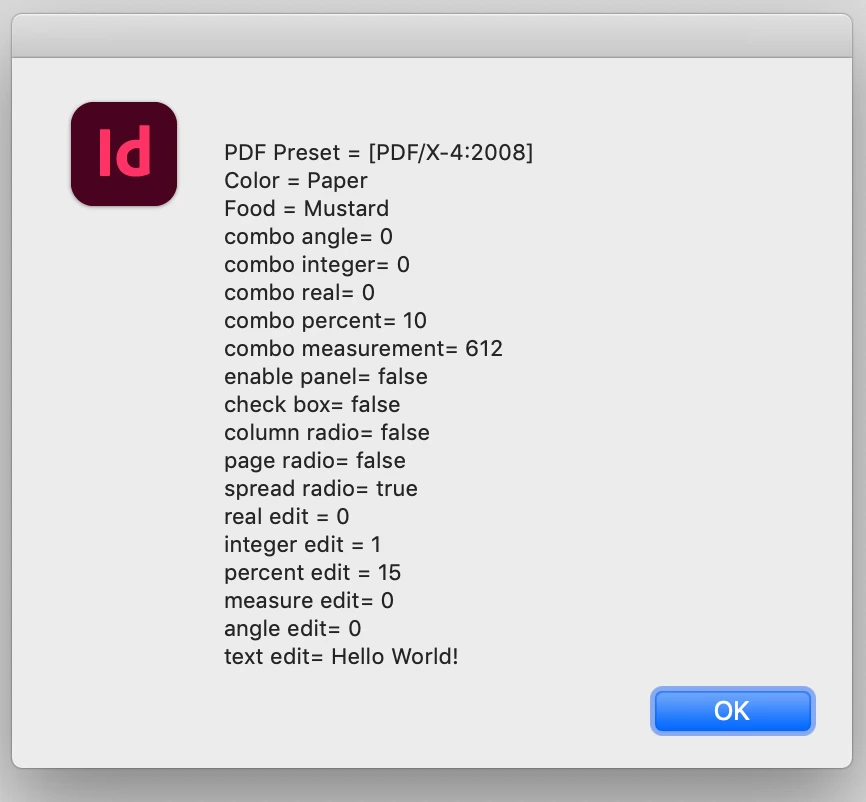

    //the returned dialog values
    alert("\nPDF Preset = " + pdfDropdown.name +"\nColor = " + colorDropdown.name +"\nFood = " + foodDropdown +
    "\ncombo angle= " + angleCombo + "\ncombo integer= " + integerCombo +"\ncombo real= " + realCombo +
    "\ncombo percent= " + percentCombo + "\ncombo measurement= "+ measureCombo +
    "\nenable panel= "+ enablePanel + "\ncheck box= "+ ckBox +"\ncolumn radio= "+ colRadio + "\npage radio= "+ pageRadio + "\nspread radio= "+ spreadRadio +
    "\nreal edit = " + realEdit + "\ninteger edit = " + intEdit + "\npercent edit = " + percentEdit +"\nmeasure edit= "+ measureEdit +
    "\nangle edit= "+ angleEdit +"\ntext edit= "+ textEditField)
    //reset
    app.scriptPreferences.measurementUnit = AutoEnum.AUTO_VALUE;
The output values returned to the main script
