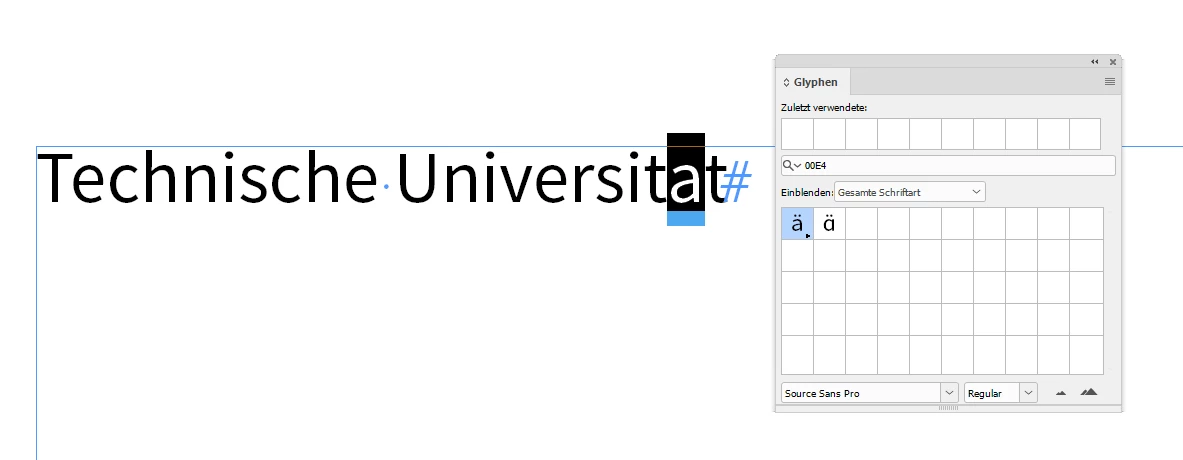

So, I need an umlaut above an "A" (it's a German thing)...
I'm highlighting the "A", then double-clicking the umlaut symbol in Glyphs, but it's just inserting the umlaught before the "A" - not above it.
Strange, that this was what worked in the past, but no longer.
Any ideas how to remedy?

Hi Bradley,
there definitely is an a umlaut ( ä ) with that font.
Search for Unicode 00E4 in the Glyphs panel. When found double-click to apply the found glyph:

You  do not see the ä in the glyph panel?
bradleyd1453121
June 16, 2020
I don't see the "a" with the umlaut above it - only the umlaut seperately - which I should be able to simply double click while the "A" is highlighted and have it applied that way.
