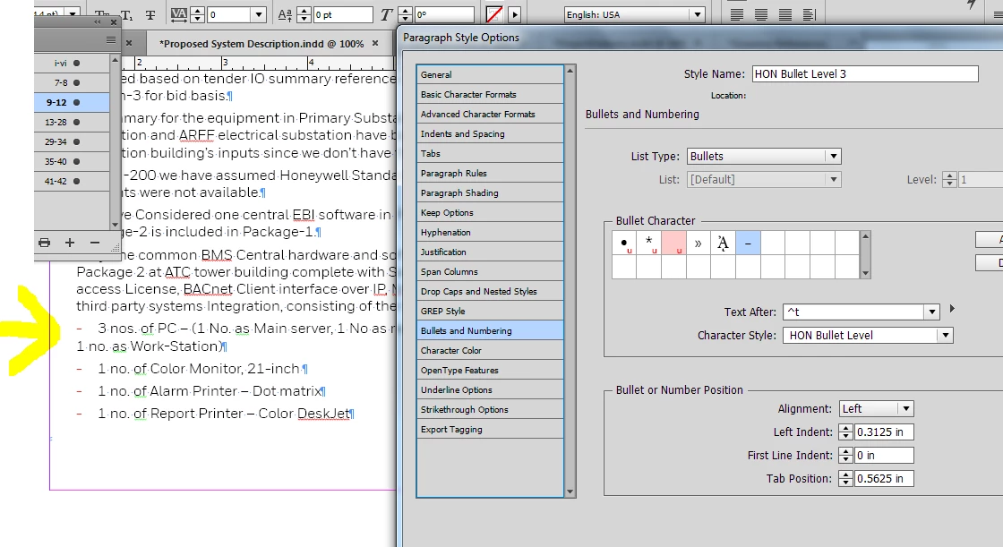

Hello
I've been facing issues with indentation of bullets. The foll is an example. The text on the second line of the bullet does not align with the first line.
I've been able to get it to work sometimes by ensuring that the 'left indent' and 'first line indent' negate each other... but im clearly missing sthg... for that approach doesn't work always, as in this case where the second line is aligning almost with this first line... however, the bullet has been bumped to the left margin... and trying to change the 'tab position' just doesn't help.
Any guidance on the right workflow for this would be appreciated.
Regards

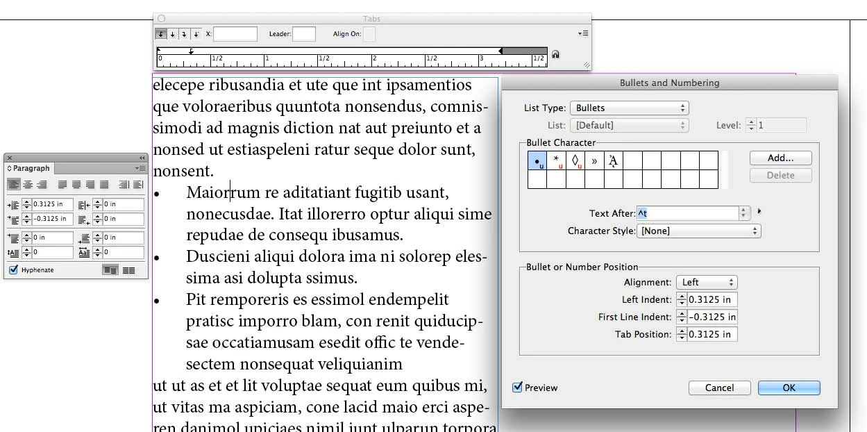

    Correct answer Barb Binder
    Oh hello!
    winterm is correct when he says your tab should be equal to the left indent. Here's a little more info:
    1. Use the left indent to set up the left side of the entire bullet paragraph.
    2. Use a negative right indent first line indent to pull the bullet back out towards the margin—partway or all the way
    3. Use the left indent value for your tab position (or leave it blank and it will default to the left indent value)
    So if the left indent is 18 pt, set the tab to 18 pts or leave it blank:
    (I prefer to measure in points. In your case both should be 0.3125")

    Barb Binder
    Barb BinderCommunity ExpertCorrect answer
    October 12, 2017
    Oh hello!

    October 12, 2017
    Your settings should look like this:

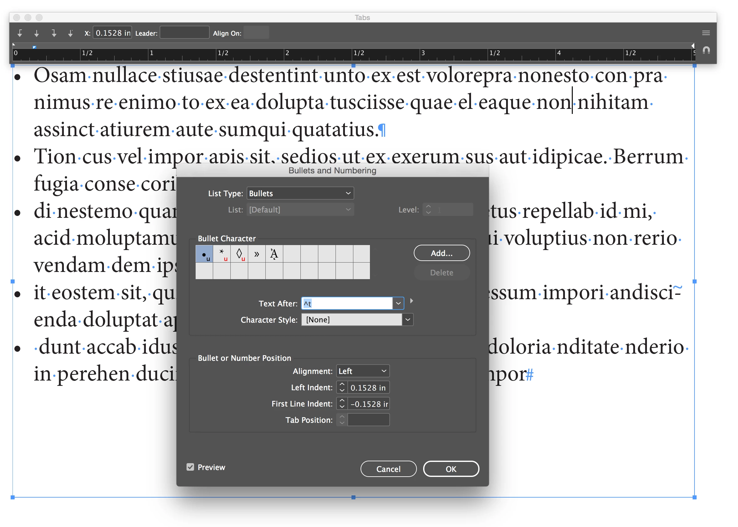

    Or you can leave the Tab Position blank. The first line indent (In InDesign) also functions as a tab stop, so it's not needed unless you want your tab to fall to the left of the indent.

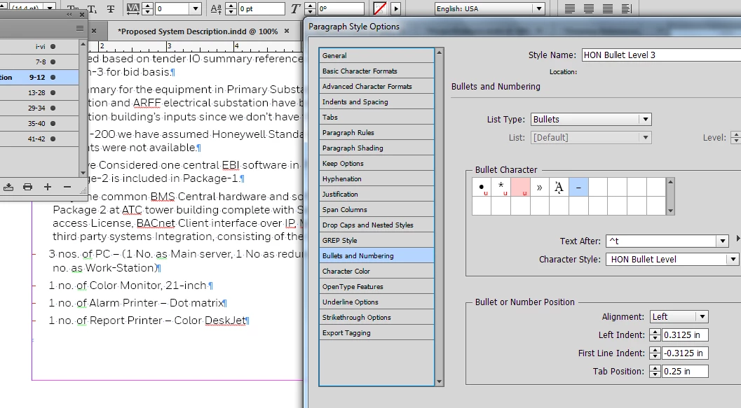

    Thank you, but im afraid that doesn't work.
