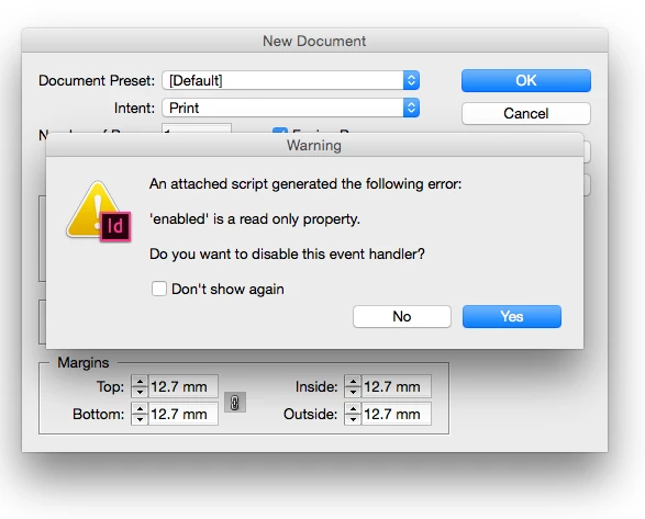

     I am trying the startup script using the below code.  But its throwing the attached warning.
#target indesign
#targetengine 'onOpen'
(function() {
  app.eventListeners.add("afterOpen", afterOpen);
  function afterOpen(myEvent) {
        var doc = app.activeDocument;
        app.menuActions.itemByName ( "$ID/Export..." ).enabled = false;
        alert(doc.name);
     Is it possible to disable indesign's menu item "Export" and "Print"?
