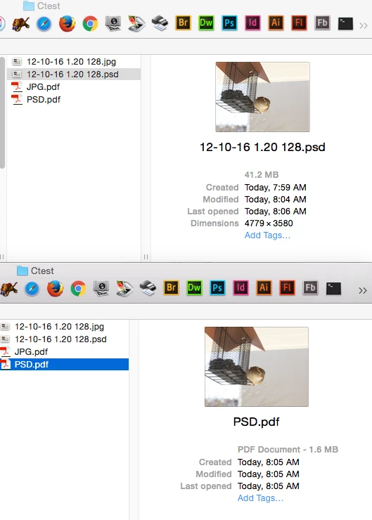

If you really think it might help to go back to Photoshop and Illustrator to shrink down the original graphics, that's what you have to keep in mind. All of the portfolio content must total around 3MB or less before you even put it into InDesign.
It is counter intuitive, but compressing placed images doesn't help in any meaningful way with the final PDF size and can create a double compression quality problem, because ID takes the placed pixels as they are and uses the PDF compression settings on export. A placed JPEG would get re-compressed (existing compression artifacts and all) on export.
It's even possible to find an image where placing a JPEG version produces a larger PDF. Something like this where the placed 41mb PSD did better on export than the same image placed as a high quality 1.7MB JPEG:
Placed PSD export to default PDF/X-4. PDF page is 1.6MB
Placed JPEG PDF page is 1.7MB

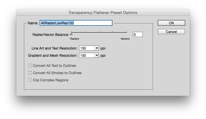

Flattened pdfs tend to be slightly bigger (FWIW, just my own experience), so it may be not a good idea when you're after smaller size. On the other hand, complex vector drawings can add a lot of MBs to your pdf, indeed. Consider rasterizing them before placing in ID?
Just to clarify, if there are vectors that are adding a lot of weight to the PDF you can force them to rasterize via the flattener preset—you don't have to take the time to rasterize them in the ID document. So add any transparent object to the master pages and use something like this as the flattener preset:

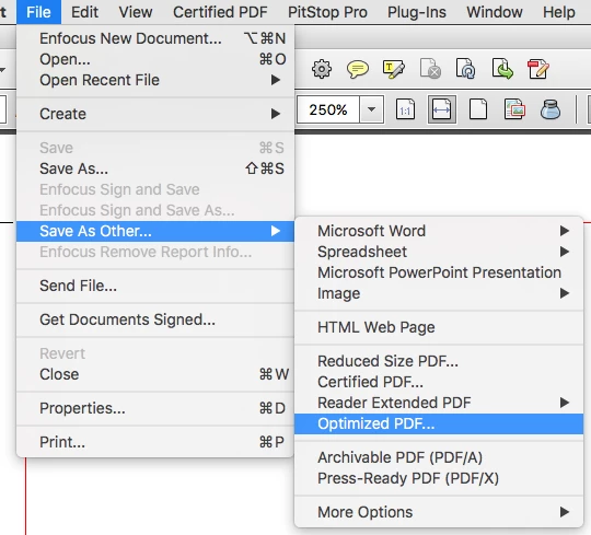

tpk1982
Brainiac
January 28, 2017
Optimize your PDF, it will works
