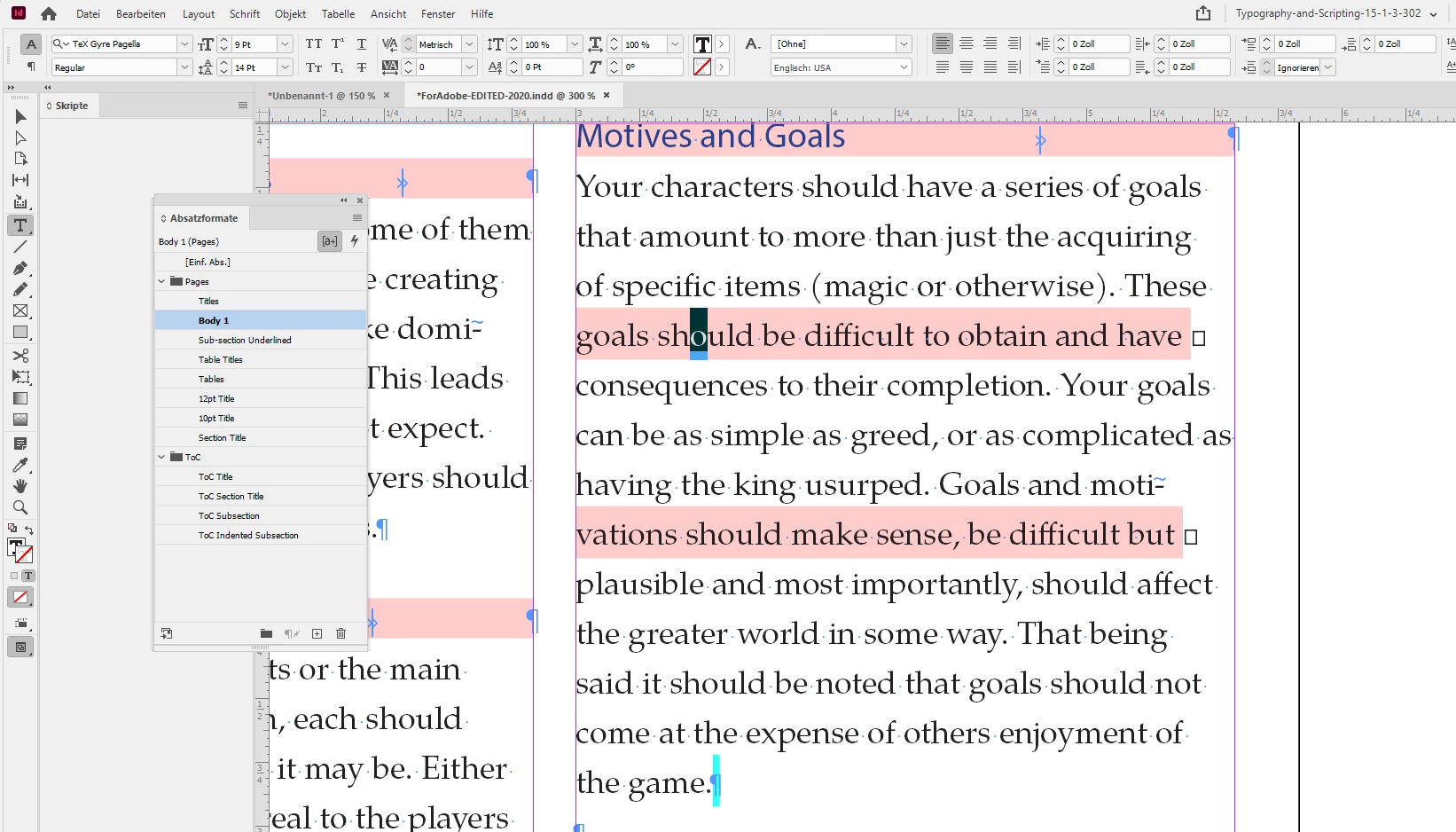

I'm trying to cut and paste from my main document (in OpenOffice) to InDesign. I'd say that 98% of the text is fine but occasionally I get random sections of text highlighted in pink with tiny squares next to them (see attached pic below). I don't believe this to be a missing font issue because I will have an entire paragraph with this particular font be perfectly fine. While another has roughly 3/4 of the text normal and the other 1/4 highlighted in this way. I can't simply change the font because I need that font I have for the body text. So far rewording the text has worked (to an extent) but after a certain point it will randomly highlight again. Any help would be greatly appreciated. Thanks

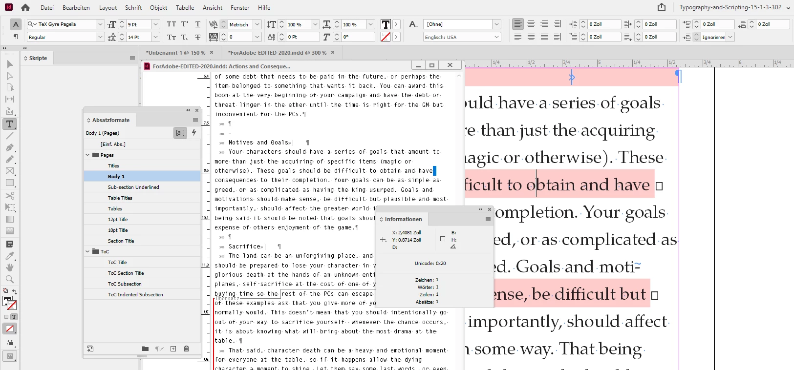

Made the fonts available through a Document fonts folder and see the same issues like you do in your InDesign document:
There is no style override with characters or the paragraph in this line of text.
I have Style Override Highlighter enabled. Also invisible characters; where InDesign already has issues to render the little widgets for the blank characters if you look closely. The character at the end of the line is a mystery. Let's use the Story Editor window and the Info panel to detect what it is:
Info says it's a plain blank character at codepoint 0020.

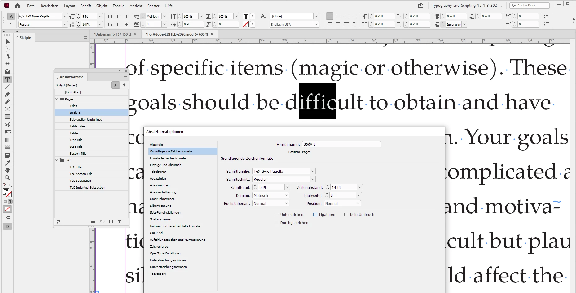

The weirdness begins if I open the Glyphs panel and inspect every single character of the word "difficult". Nothing unusual when I start with the "d", the "i", but then with the selected "f" InDesign becomes a bit strange. Something's wrong with that ligature "ffi" in that OpenType font:
And you may notice that the same happens a few lines below. Also with the word "difficult" and the following blank characters.
Can we fix the issue if we turn off Ligatures in the applied paragraph style? Yes!
So that's it. A bug in the font.
I would contact the makers of the font and report that InDesign has issues with ligatures.
