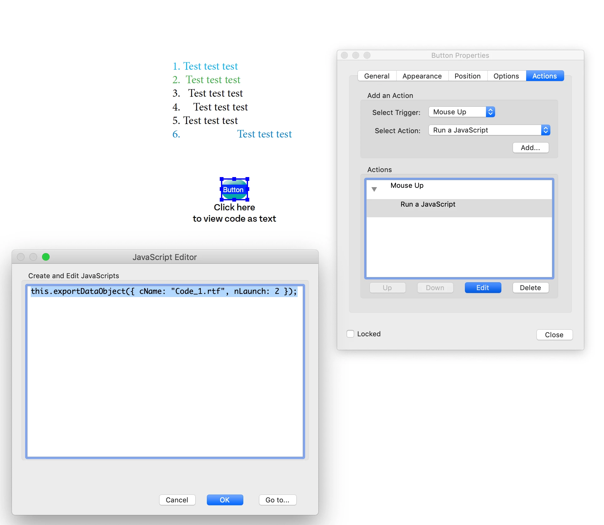

Here is a possible work-around, although it involves some work. Copy each InDesign code and paste into a text editor and save as a .rtf file (rich text). Attach it to the PDF. Add a button in InDesign under each code. In Acrobat, edit the button to run a JavaScript that will open the attached .rtf file to allow for copy and paste, with the spaces and colors intact. In this example, the name of the attached rtf file is Code_1.rtf
The user would need to use Acrobat or Reader to use the buttons. You can add a message to your PDF that would only appear if the PDF were opened outside of Acrobat or Reader, the message would say something like: This PDF must be opened in Acrobat or the free Adobe Reader for full functionality.

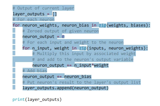

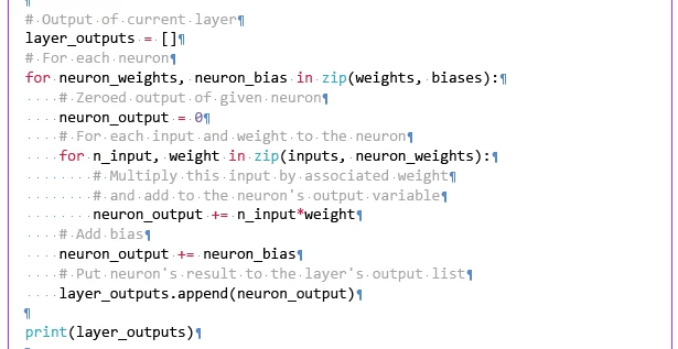

This is how it looks like in InDesign:
The font is Consolas (fixed char width) and the text is colored to match the code syntax highlighting in the Sublime Edit.
After exporting to pdf and a try to copy the code, you can see that spaces are not preserved:
It looks like there is just a single space.

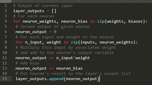

How it looks like when we copy it from the pdf file and paste into Sublime Edit:
How it supposed to look (bottom part shows the spaces there).
Basically, we need these space characters to be there for readers to be able to copy the code and paste it into the code editor.
