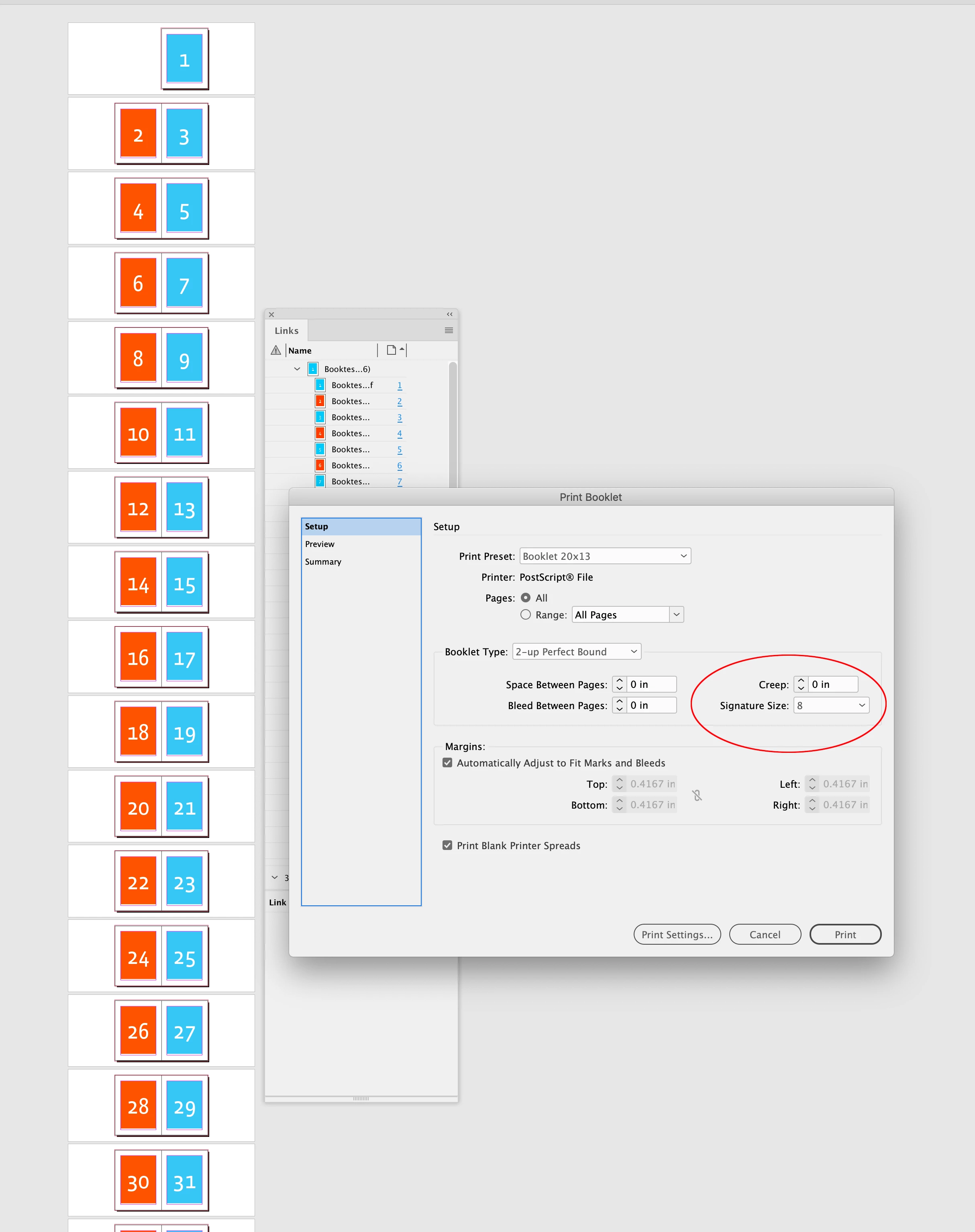

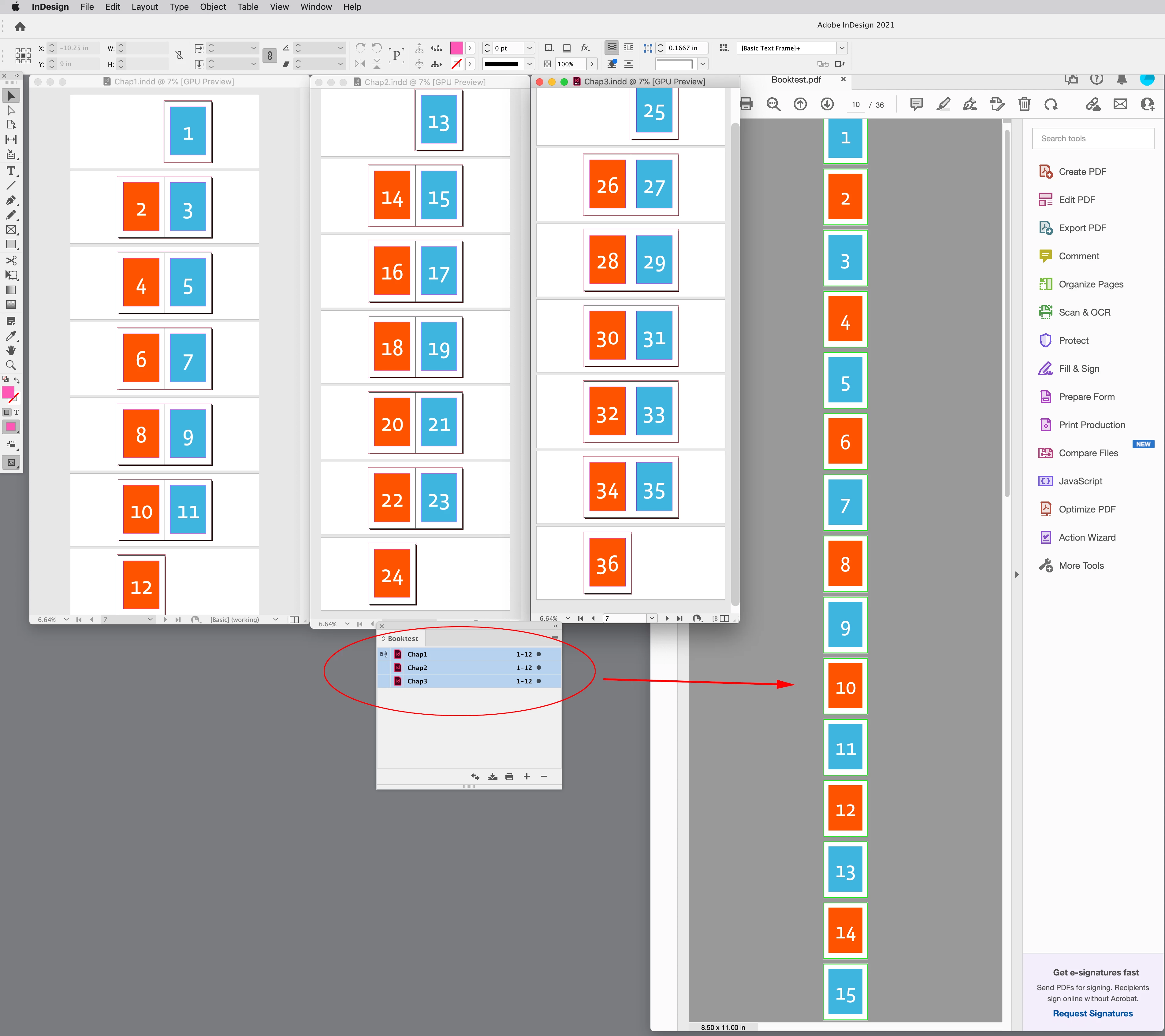

Hi @Oreri , another option would be to Export the entire 368 Book as a PDF, and then place the PDF back into a new InDesign document using the PlaceMultipagePDF.jsx Javascript, which you will find in the Scripts panel Samples folder. Then you could print signatures from a single document using Print Booklet.
If there is any complex color in the Book documents, Export the book as PDF/X-4 and make sure the color settings for the scripted full document match the Book chapters’ color settings.

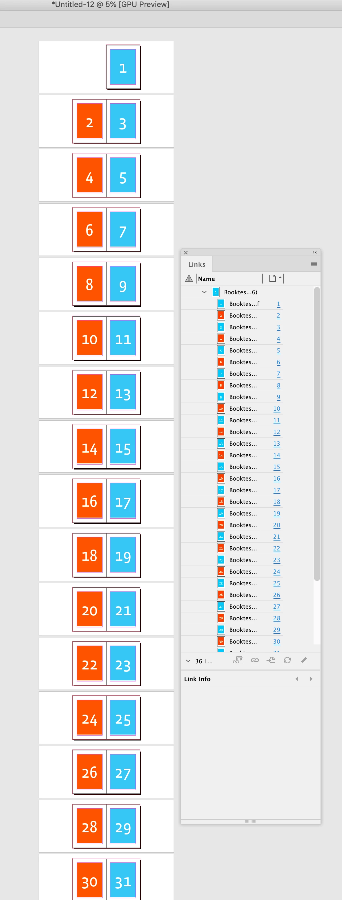

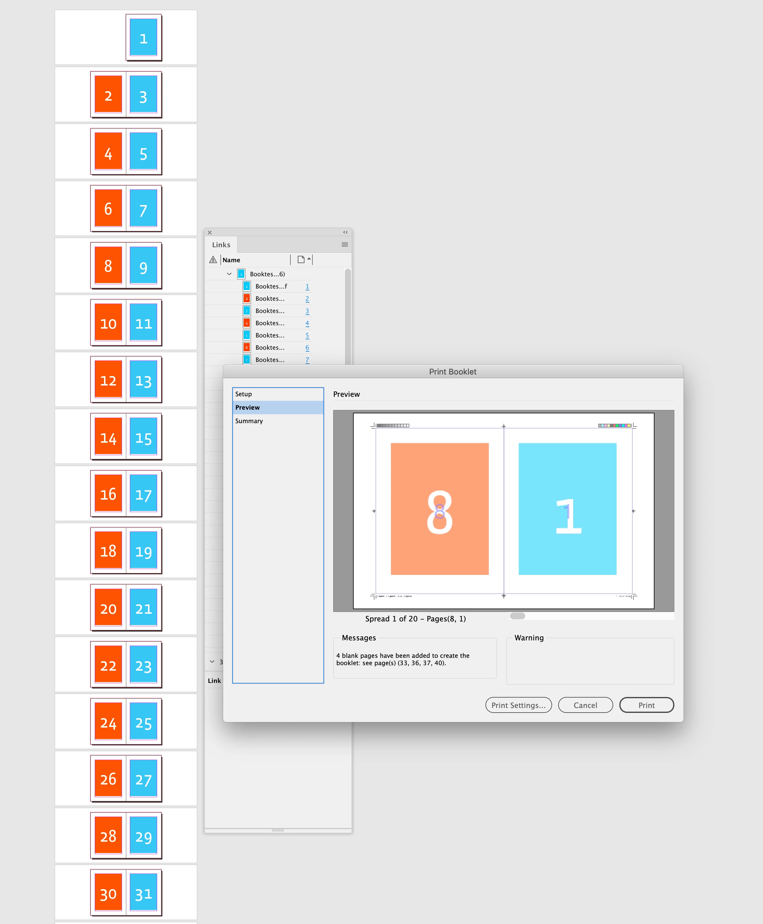

I just tested a Book to PDF, back to Indesign via PlaceMultipagePDF.jsx, Print Booklet workflow and it seems to work fine:
