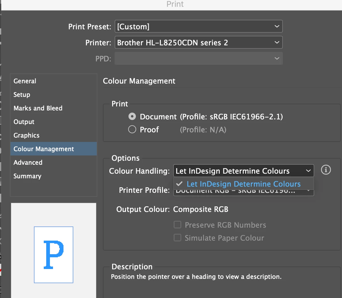

If I choose my printer the only printer profiles I get are RGB, and the only output I get are 'Composit RBG' or 'Composit Grey'. As shown in screenshots:
I think that I want to print in is either composite CMYK composit or Seperations (one colour at a time? offset press?). However those options are greyed out.

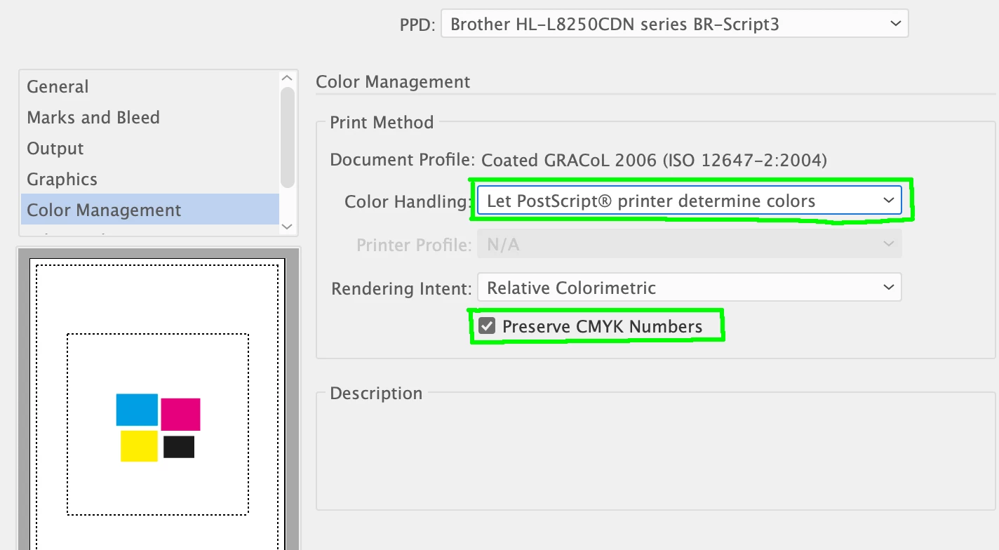

Did your HL-L8250CDN come with BR-Postscript? In which case, you might have better luck achieving what you want by installing the BR-PS driver for the printer (as I have to test this). That will give you the ability to print CMYK separations, but that's not what you want, as these will print out in Black for each separation.  However, the benefit of using the BR-PS driver is that you can create a graphic in a pure colour, say Cyan, and it will be sent through as the spec'd value of Cyan, assuming you let the "Postscript Printer manage colors" and "Preserve CMYK numbers" which will ignore any Colour management settings/profiles you have set.
This is not to say any Printer adjustments you have made in the printer itself won't have any affect on your output, but this is your best case scenario.

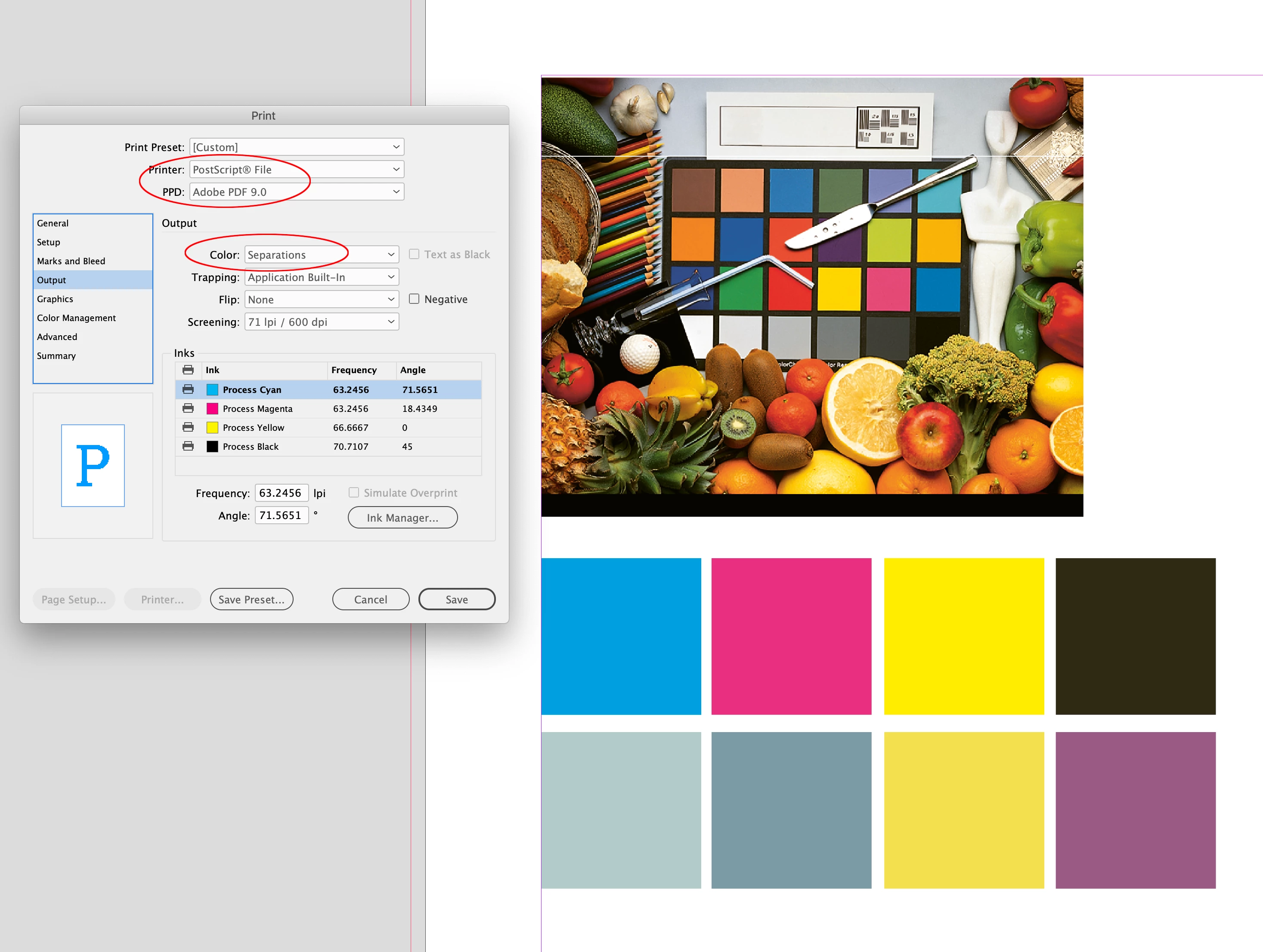

Hi @prints_of_george , Composite "RGB" driven print drivers don’t let you print separations—a postscript RIP or driver would.

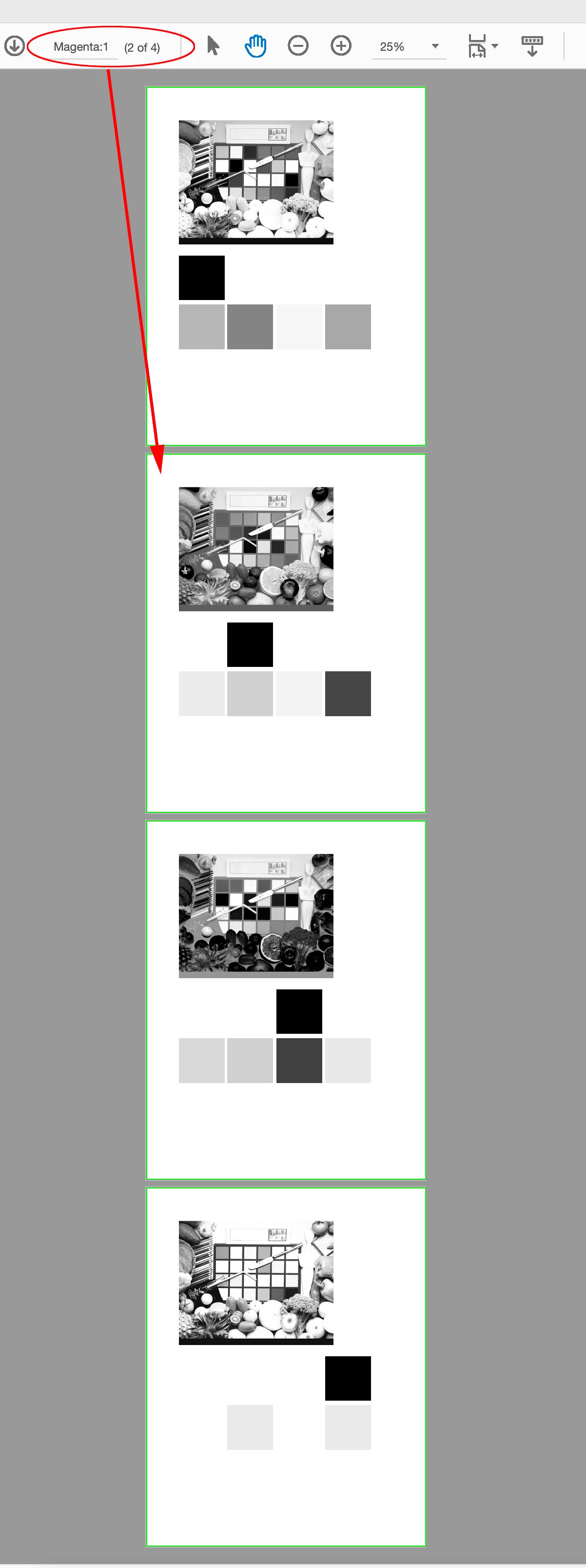

You can print Separations to a Postscript file using the Adobe PDF 9.0 PPD:
The .ps file Distilled to a 4 page PDF:

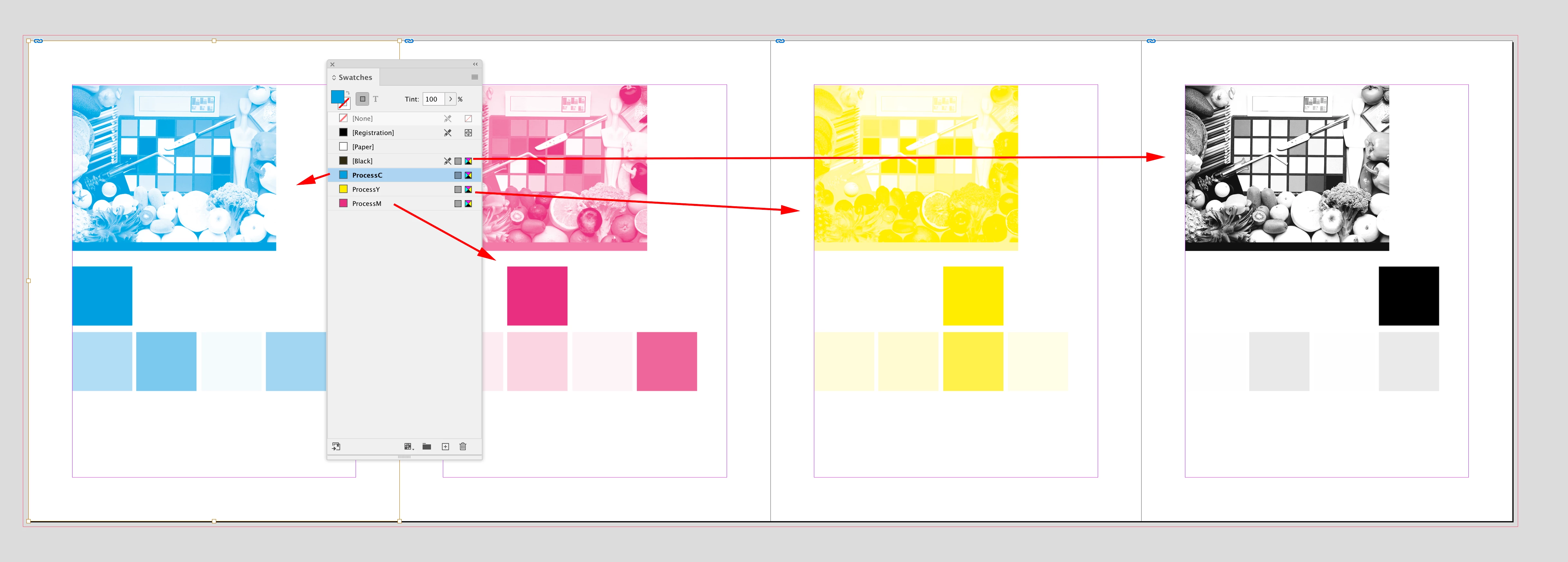

If I wanted to print a color representation of the separations, I could open the 4 PDF pages into Photoshop, save them as flattened grayscales, place in InDesign and assign the grayscales the C, M, Y, or K Process colors:

Right, with a few exceptions all composite color printers have "RGB" drivers and color manage the output of document CMYK colors—the document values are not what get printed. How well the any printer simulates profiled CMYK color depends on the accuracy of the driver’s color management.

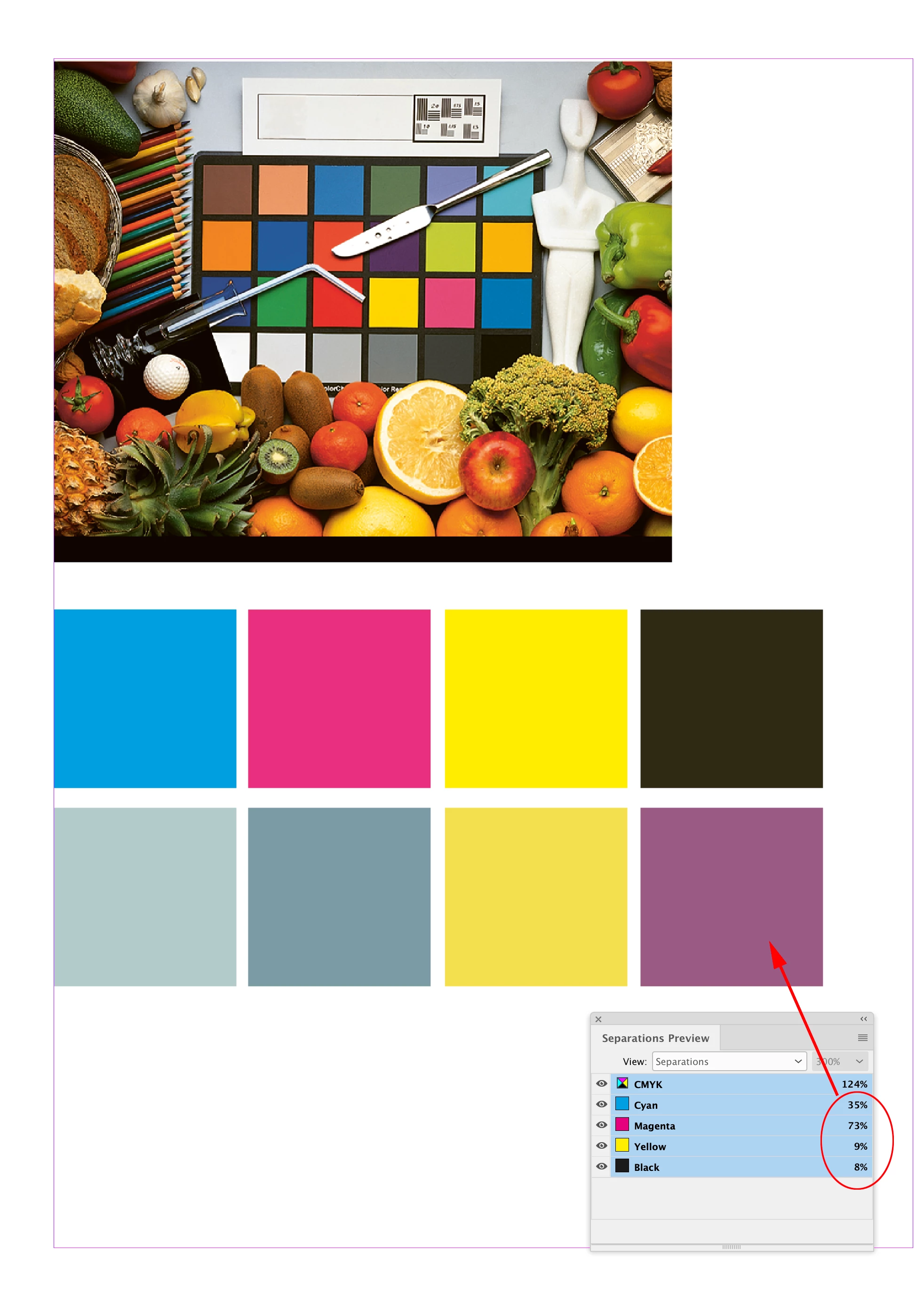

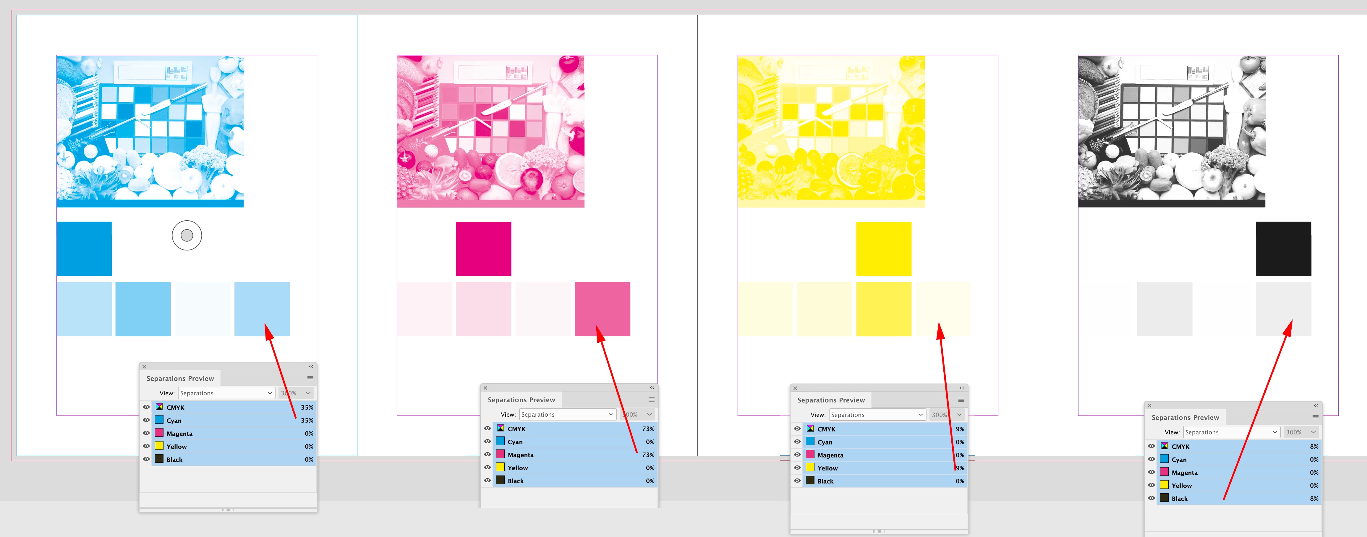

In my example the output to the PostScript Separations was set to Document CMYK, so the gray values in the PDF pages match the values listed in ID document’s Separation Preview.
I placed the grayscale PSDs in a document with the same CMYK profile, so the applied process color values also match the original.
Sampled color from the document:
The applied 100% process CMYK colors also match:
The composite printer might not accurately simulate the separations’ appearance, but if that’s the case it wouldn’t be able to simulate the appearance of the original composite page either.

prints_of_george
October 17, 2022
Thanks for your reply.
InDesign wont allow me to select Let Printer Manage Colors/Colours.  I'm going to experiment with the .PS postscript files as they seem to result in the biggest change to the finals colours
