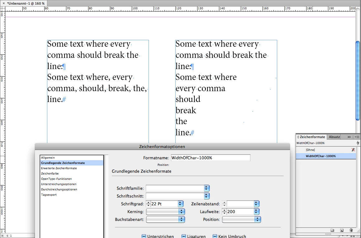

    Last resort:
    Maybe you are able to create a character style where the comma is formatted with 1000% width and with a larger point size and no fill and stroke. Depending on the width of your text line this could work like that:
    Download the IDML for this little experiment from my Dropbox account:
    Dropbox - CommaBreaksTheLine-GREPStyle-CS6.idml
