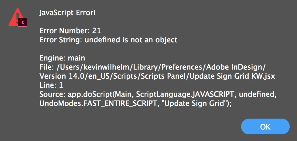

We had previously had a developer write a script to update text box content with properties from Create Cloud assets. The script had been running fine in CC 2018, but it now throws an error in CC 2019. It's been years since I was working in JavaScript, and I'm a newbie to this forum, so I'm hoping someone might have an easy answer on this that I'm just not seeing.
When the script runs, it's giving me: Error 21 (Error String: undefined is not an object) at line 1
I have that exact same line in other scripts and do not run into the issue. Should I have some other argument listed instead of "undefined"? Any insight would be great.

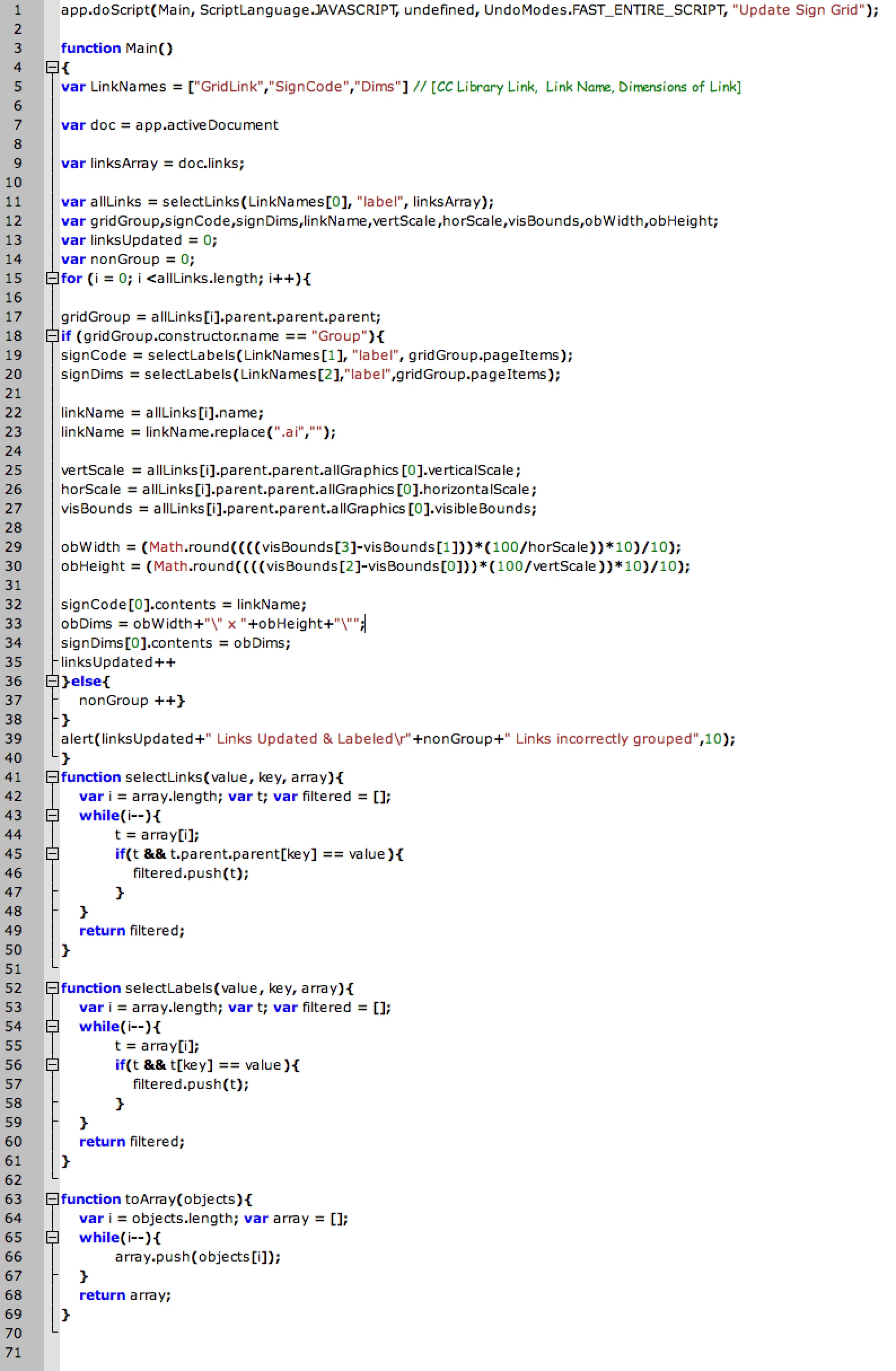

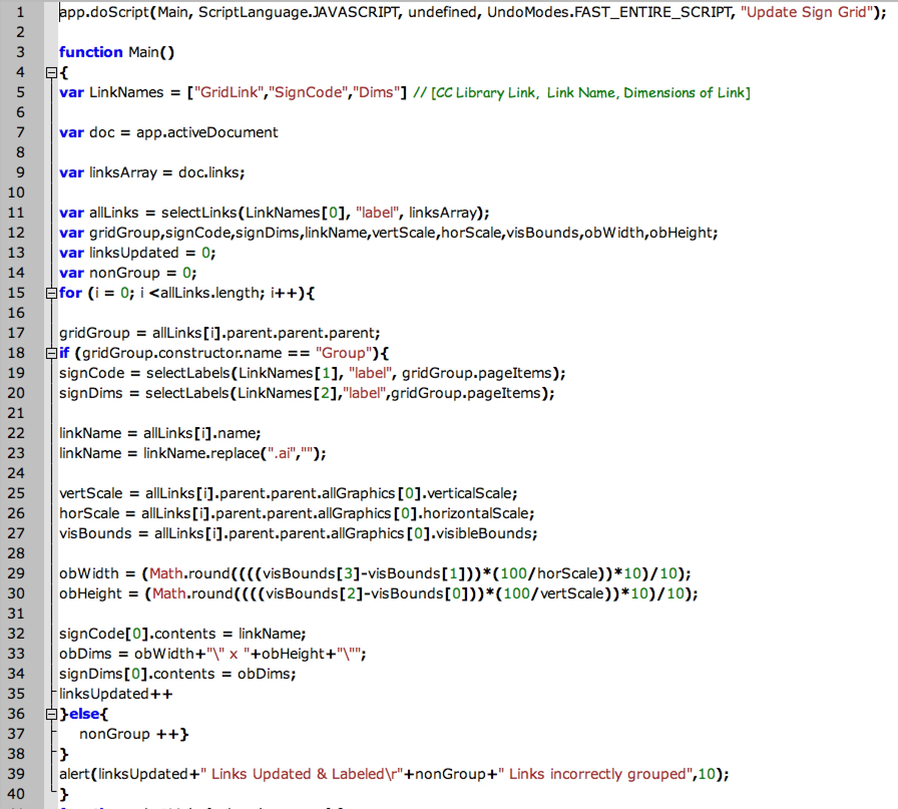

Here is the script:

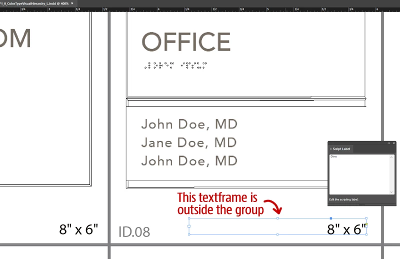

Hi Kevin,
Although there are minor issues in the script, the main reason behind the 'undefined is not an object' error is not related to CC 2019. You would have encountered the same message in CC 2018.
Looking closer, you'll find that your document doesn't fit the specification—and the script is not strong enough to address the problem.
Here is the thing:
Page 1.02 of your sample document, the ID.08 link has a parent group with the expected code frame, but the dims frame is not part of that group, as it should.
Unfortunately, your script doesn't check whether its selectLabels() function actually returns a non-empty value. While parsing the above structure, it fails to feed the signDims array, and then the statement (line #34) signDims[0].contents=obDims; meets undefined and causes the well-known error.
There are other vulnerabilities in the code. For example, it should at least check that the objects to be updated (via the contents property) are actual TextFrame instances. And that's easy to do: instead of browsing the PageItems collection of the current group, just browse its TextFrames!

This should be a bit safer.
Marc

March 6, 2019
Hi Kevin,
hard to tell what's going on because you did not post all the code.
What does function selectLinks() exactly do and return?
Uwe
kevinw43110616
March 6, 2019
Sorry about that. Newbie move. Here is the entire script:
