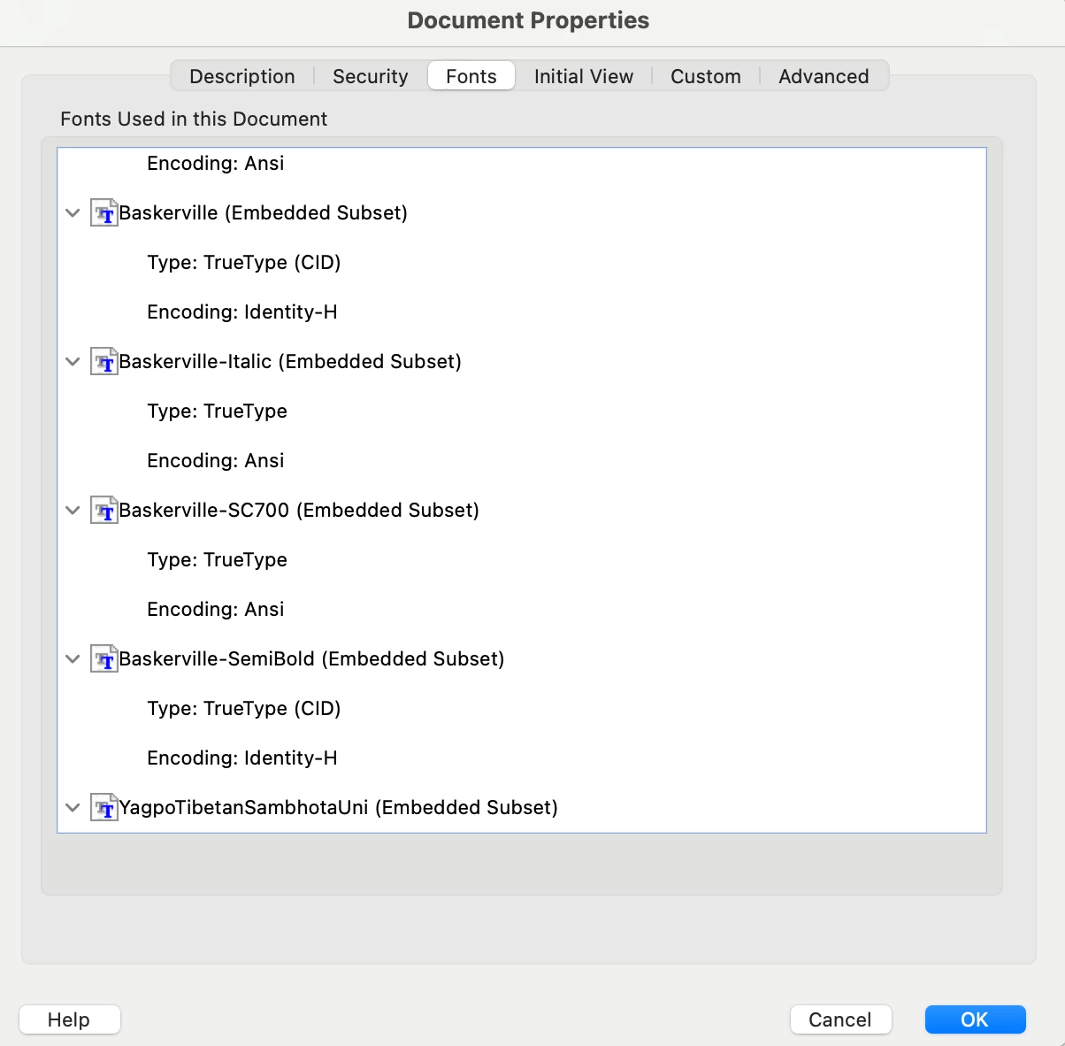

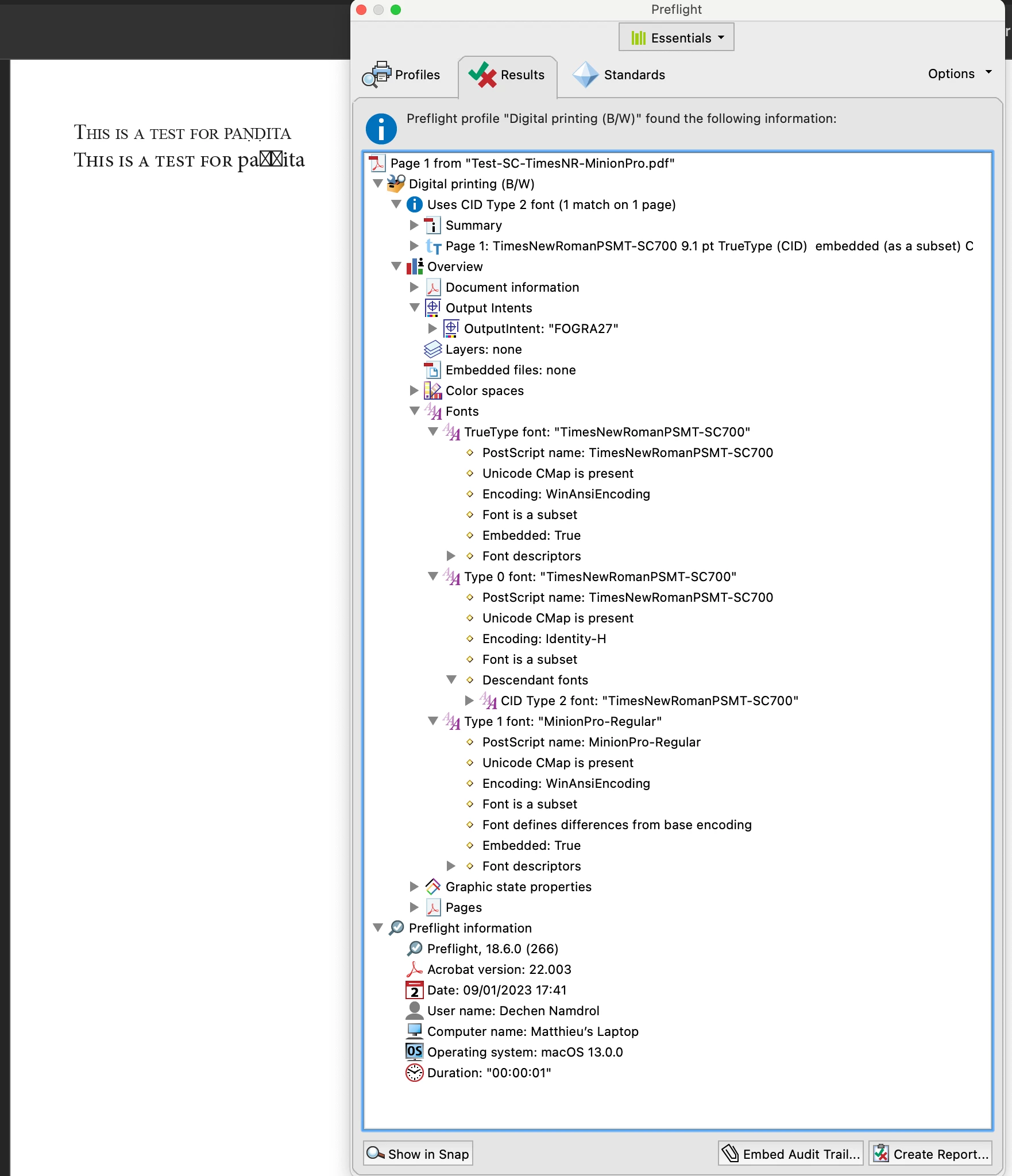

I would like to know if there is a workaround to the issue that InDesign does not properly embed the Small Caps it creates when the font does not come with its own small caps. It is a major issue for printers (or when importing the PDF in Illustrator for instance)... and the only workaround is to create outlines whenever Small Caps are used.

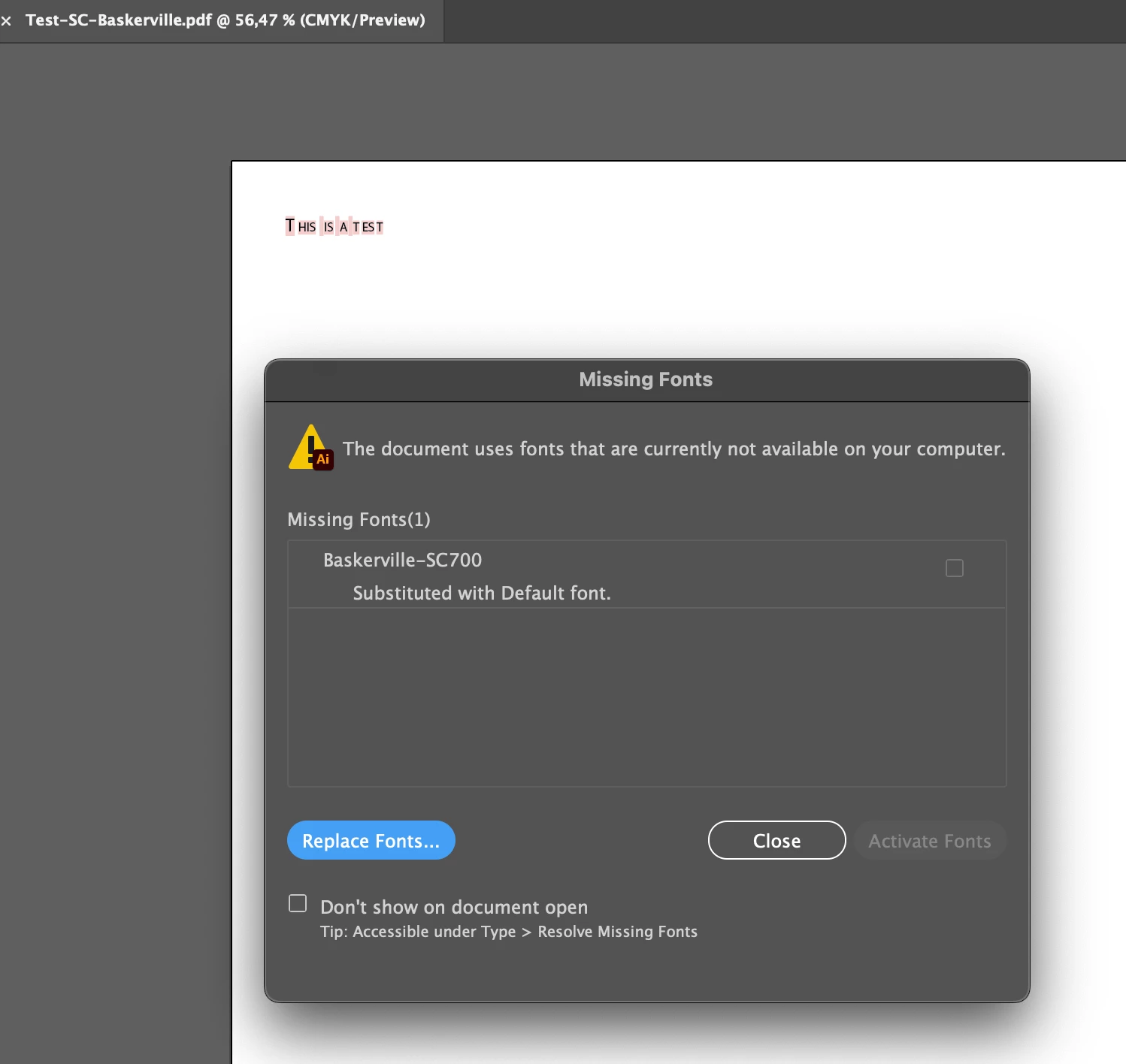

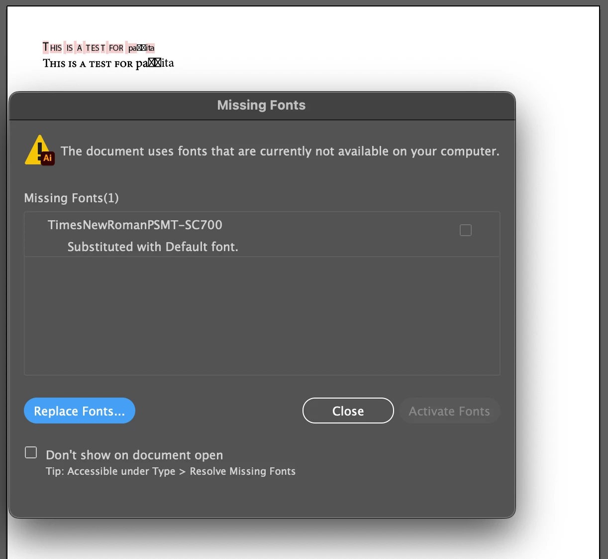

Besides, I do not understand why Acrobat mentions that the Baskerville-SC700 is embedded (see screenshot) while Illustrator has a warning when opening the file, explicitly mentioning that the font is missing (and asks for a replacement font).

I also attach a screenshot of the error message when importing the file in Illustrator.

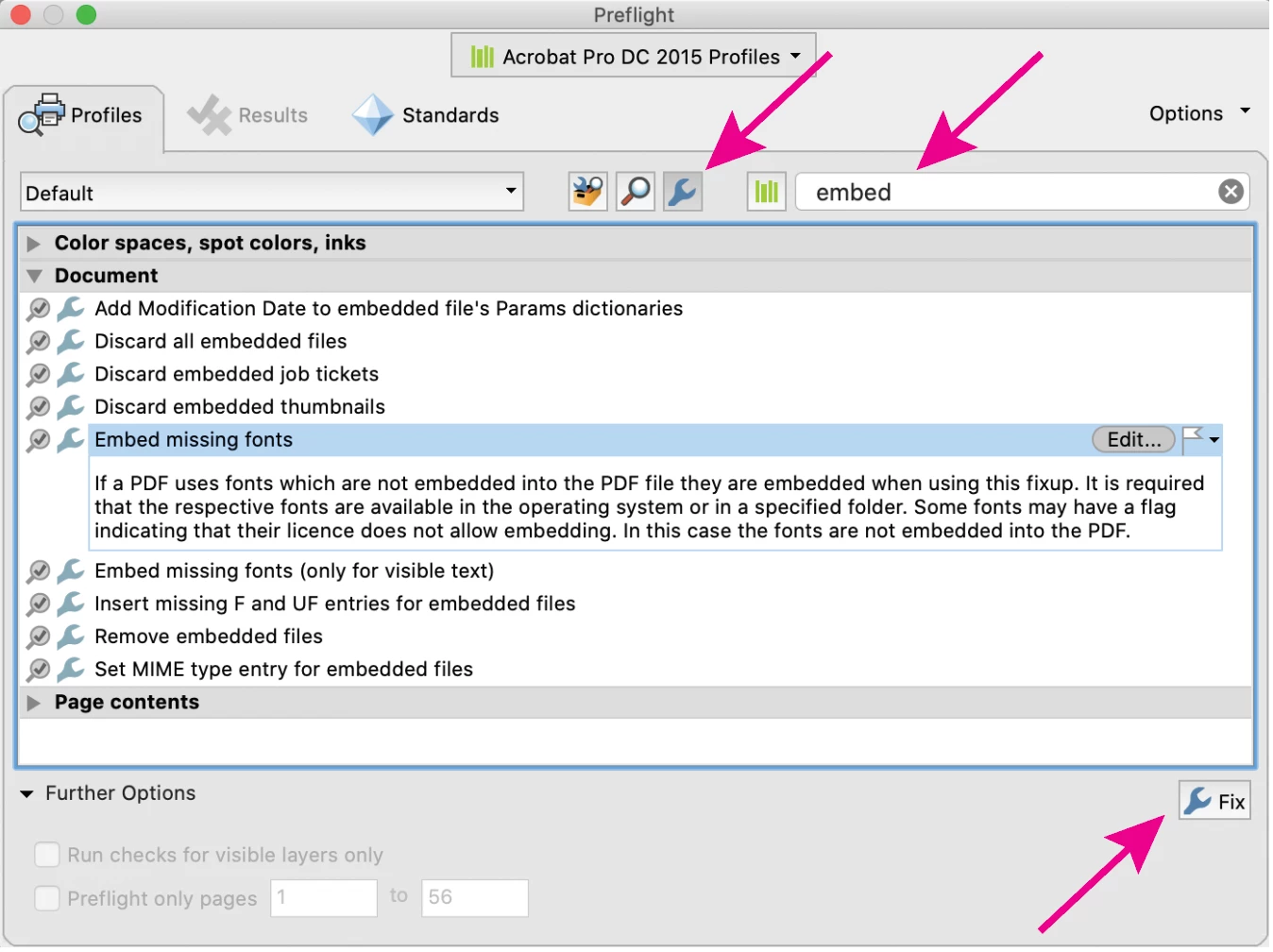

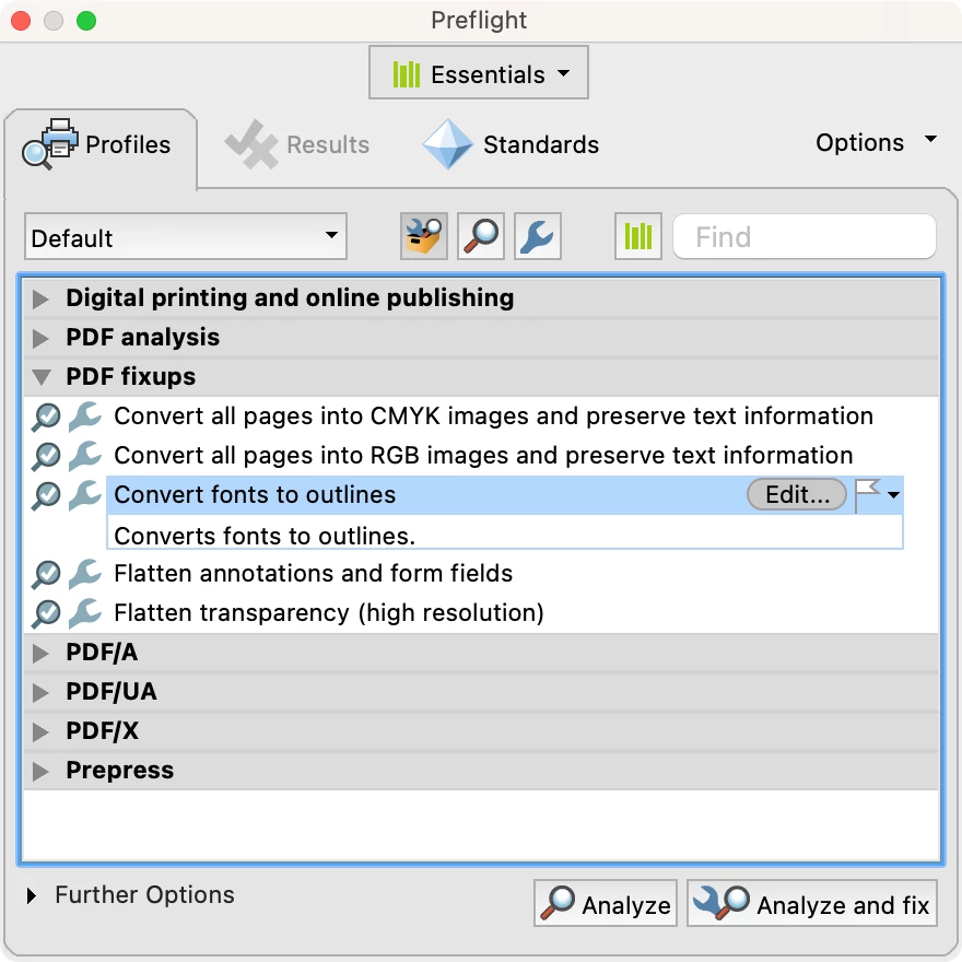

Your only way to get this right is to open the PDF in Acrobat Pro and convert all fonts to outlines using Acrobat's Preflight function. There is no way around this. And if file size grows with that process, so what? That does not matter at all…
When in Acrobat Pro, go to Print Production > Preflight:

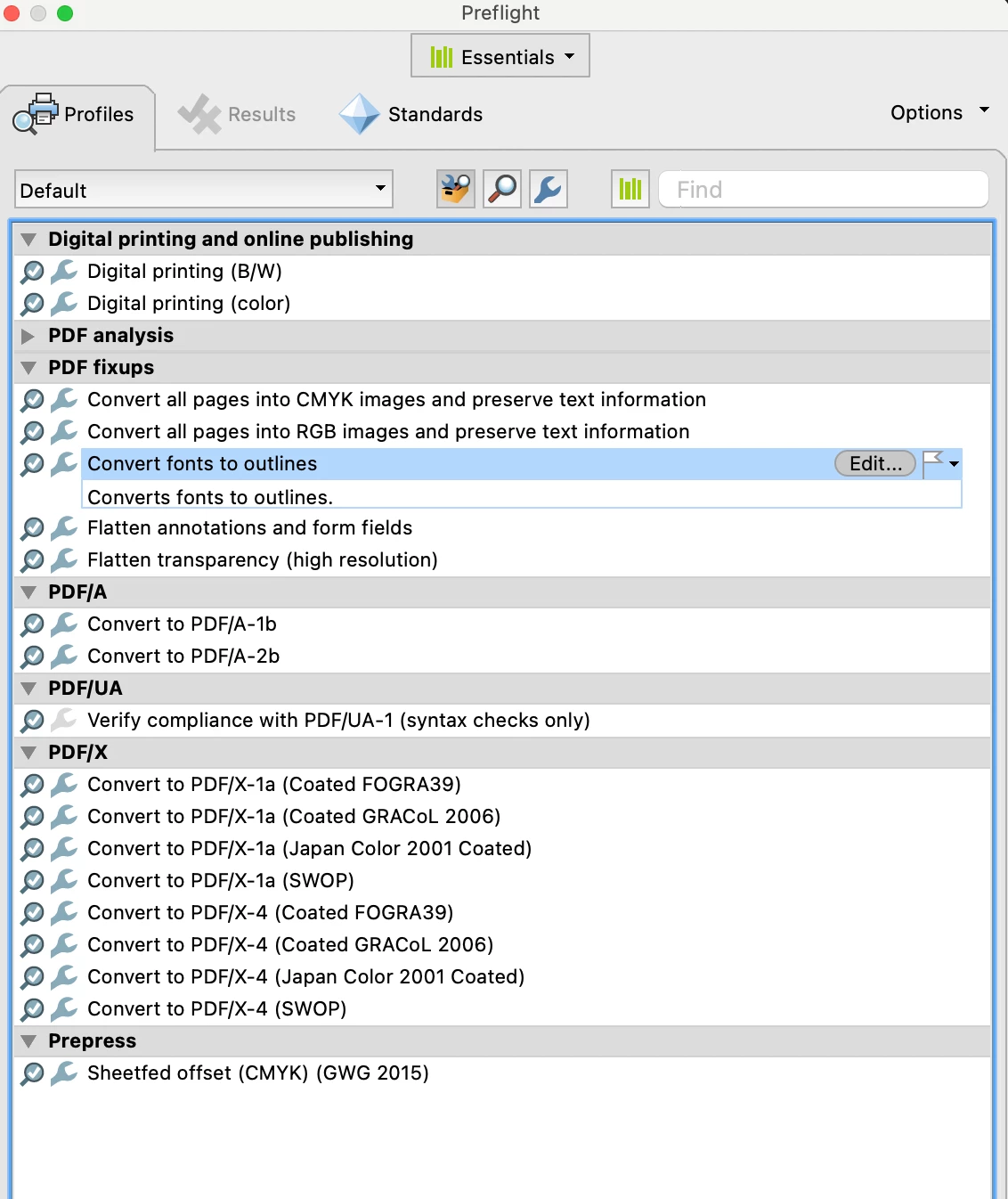

Anyway, the only solution I have found to manage this issue is to convert fonts to outlines using Acrobat, as explained in https://creativepro.com/outlining-fonts-the-2016-edition/.

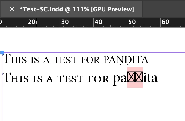

When a font does NOT have built-in Small Cap glyphs, InDesign fakes them according to your Advanced Type Preferences (e.g. ID's default 70%). When ANY font is subset in a PDF, small caps or not, the subsets will be given a custom name, such as "PostScript name: CRDRWI+Baskerville". This will identify itself simply in your PDF Document properties as Baskerville. For your "fake" Small Caps, the font is written as "CRDRWI+Baskerville-SC700"... this is so that when the font is rendered into a PDF, it takes the normal Baskerville font and resizes the capital letters to 70%.
When you open this file in Illustrator, yes it will say SC700 is missing because this version of font does not exist outside of the PDF; It was never meant to be. It is, however, actually and truly just Baskerville. If you do a Replace Font and replace the "missing" with just plain old Baskerville, everything will pop back into line. You will also notice your 12 pt type small cap letters are now sized 8.4pt.
As weird as this sounds, this is how ID has always written code for small caps in its PDFs since the beginning of program.
The font is embedded in the PDF, which means Acrobat can display text using that font and print that text. It can also convert the type to outlines using Preflight…
Opening the file in Illustrator for editing is a different task. Illustrator needs the font installed in the OS or through Adobe Fonts for the font to be available to Illustrator. Illustrator can convert the PDF to outlines if you place it and embed it in a file, but it cannot edit text using an embedded font.

"Besides, I do not understand why Acrobat mentions that the Baskerville-SC700 is embedded (see screenshot) while Illustrator has a warning when opening the file"
You must be aware of the following: Regarding possible font license restrictions Adobe Illustrator does NOT use embedded fonts when opening a PDF.
Adobe Illustrator always and only uses installed fonts and if the font isn't installed (or not recognized) AI needs a replacement for the missing font.
This is not a bug, it's by design, because Adobe don't want trouble with the rights holders of the fonts.

Illustrator is not a universal pdf editor, nor should it be used to confirm fonts in a pdf are properly embedded. If Acrobat shows all fonts are embedded, there should be no printing issues. I don't know why Illustrator is showing the font issue, but I suspect it's a red herring and should be ignored. Have you tried running an Acrobat preflight to embed the fonts? (Tools> Print Production> Preflight). Can you attach a sample pdf so we can take a look?

Now, to reproduce the issue at your side is easy. I am attaching two ID files (actually one would be enough), and some screenshots (of ID for one of them showing the issue with diacritics), of the message when importing in Illustrator for both ID files). I need a font that includes diacritics (dots under letters for instance), which limits the fonts I can use.
While I do not have the export issue with Minion Pro (which seems to include Small Caps in itself), that font does not include diacritics, so I cannot use it for my work. Times New Roman (like Baskerville) does include diacritics, but does not seem to include Small Caps... But in the end, if InDesign offers the possibility to use Small Caps, I believe it would be natural that other Adobe publishing apps like Illustrator recognise these Small Caps, just like Acrobat does...
And I have looked into the preflight panel, showing exactly what Acrobat shows me: fonts are embedded (see screenshot and txt report). But as you wrote, this is not a validation: the issue is there, when importing in Illustrator, as well as with the printer (I was really arguing strongly with the printing company based on that argument, without any positive outcome: I had to create outlines...).

This said, I think I found a workaround thanks to your post reminding me of the use of preflight: it requires the use of the Preflight "PDF fixup", called "Convert fonts to outlines" (see screenshot), but it increases the document size significantly. And anyone without Acrobat will still not be able to solve the issue, which I believe should be fixed at the level of InDesign (why fix an issue created by one Adobe app with another Adobe app?).
