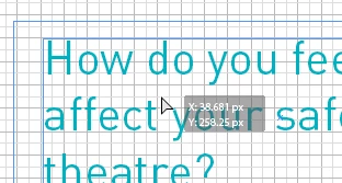

I can't snap to document grid, I have an 8x8 document grid set-up, but even with only snap to grid on my content always offsets itself from the grid
The offset seems consistent but I can't change it. I've reset preferences but the issue still occurs.
Thanks

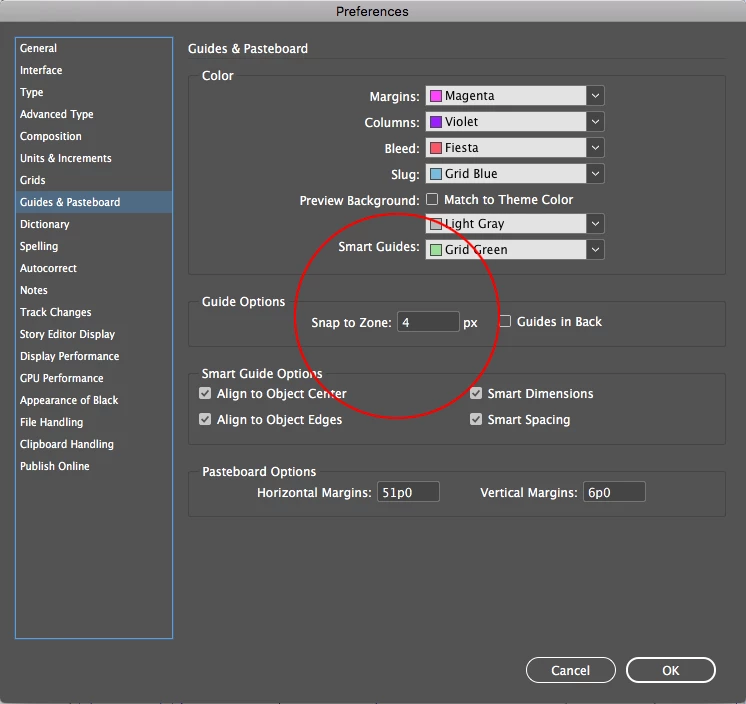

I've got this problem as well, except I've got it with my guidelines and margins. I make a new text box and it offsets itself right next to my guidelines. Same for images and vector shapes.
I've also changed the Snap to zone option under Guide Options, but that does not seem to help at all.
People saying you should zoom in can go tell Adobe to fix this problem instead. I've not got time to zoom in on every textbox as the book I am making has 180 pages with multiple text boxes and images on each page.

I'm thinking that maybe your Snap to Zone is too low? The default is 4px which is pretty tiny especially with modern high resolution monitors. Try going to Preferences > Guides & Pasteboard, and increase the Snap to Zone value. This will cause it to "jump" to the grid from a farther distance.

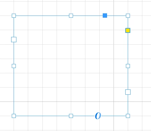

BarbBinder Mike Witherell Here's a copy of the file, the green boxes have the issue though you can sometimes get them on grid in this, its tricky and still offsets by by 0.6XX
Dropbox - issue.indd
This is definitely going to be some really simple setting isn't it.

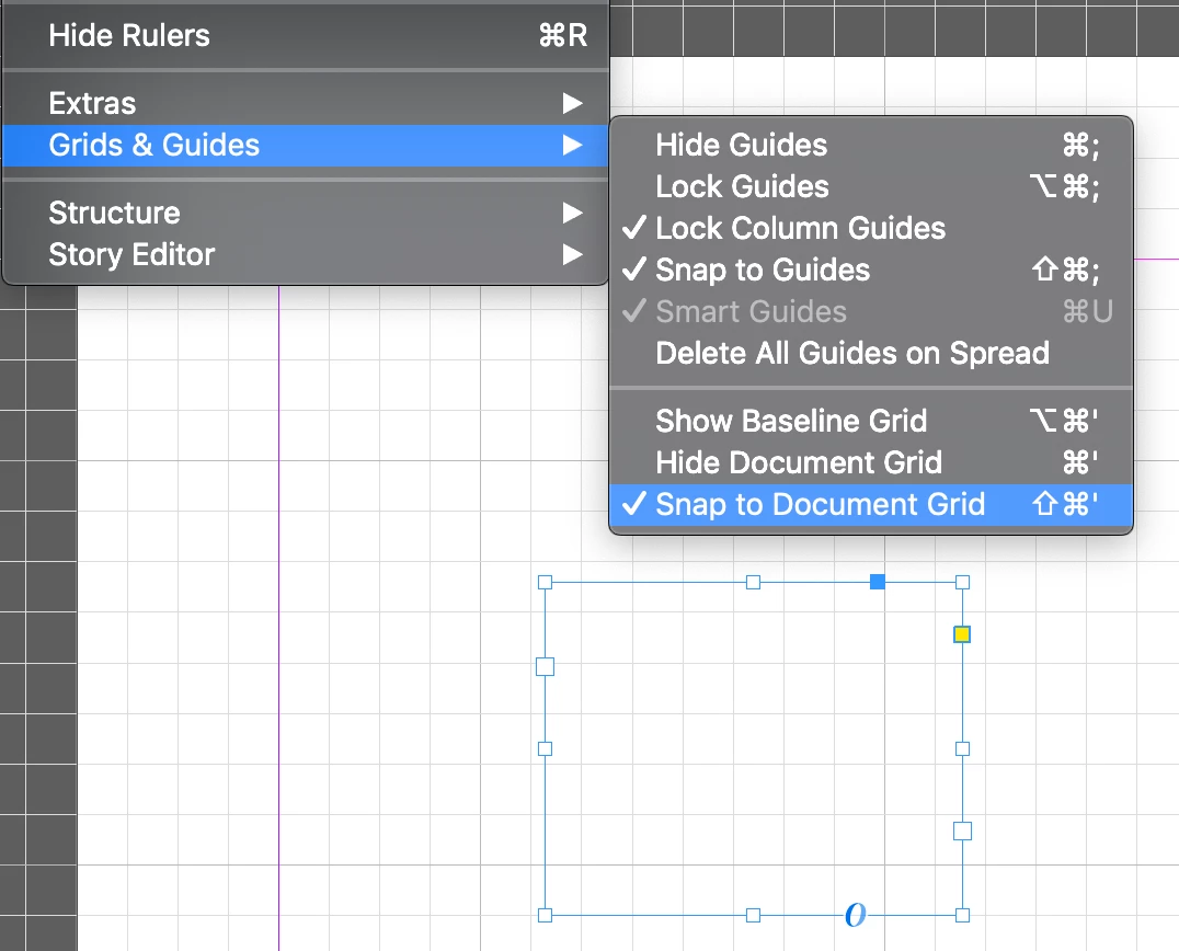

Hi noobkanon:
Even with my grid defined, visible and snap to grid enabled, I can still move frames off of the grid.
However, the grids are magnetized so once I move my frame closer to the grid, it will snap right to it. Same with resizing.
Is your snap on? Can you feel the pull of the grid as you approach it?

@Mark, having baseline grid settings don't have any affect
Hi BarbBinder​,
The snap is there it seems, but it snaps offset to the actual grid. You can fight it by zooming in and it will flicker back and forth between the actual grid and the offset it grid but always snaps to the offset.
