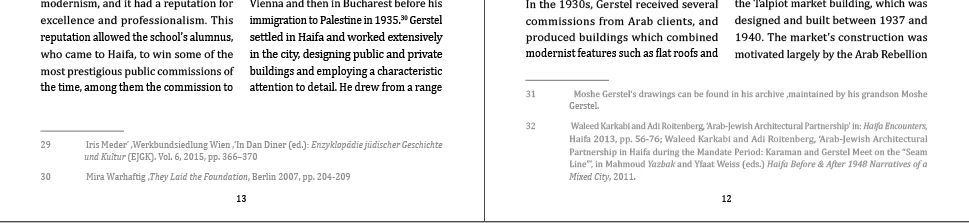

For some reason, the space between my body text and footnotes is unequal, as can be seen here:
Has anyone encountered this issue? I've tried aligning the text boxes differently and nothing happens...

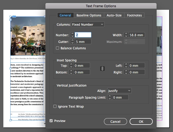

Full frame:
Text frame is justified:

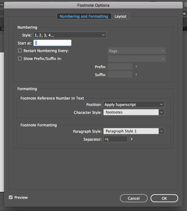

Footnote settings:

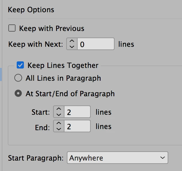

As Barbara suggested, this is due to "Keep Lines Together" option.
If we look at the second paragraph on your left page (the one that ends with "monumental Talpiot market", we can see that there is not enough space for the two last lines to fit in the left column.

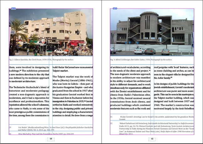

As Jane said, it would be helpful to see the entire spread with the frame edges showing.

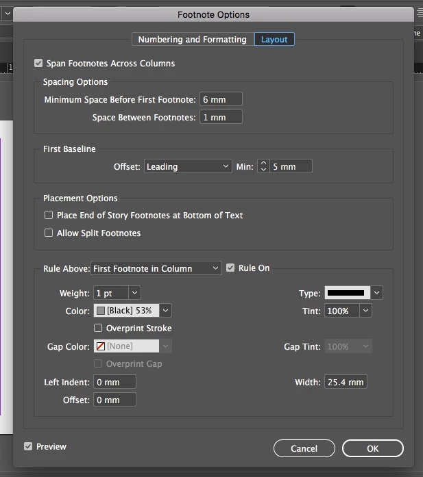

The minimum space above the first footnote is set in Type > Footnote Properties > Layout, but you might have Keep settings on that are causing the paragraphs to break where they are, or maybe there's a footnote in the first line of the 2nd page, and if the note can't fit at the bottom of the left page, InDesign will push it to the top of the next page.

June 7, 2017
Show your frames. Are they in the same place? If yes, then it's a paragraph level setting or a frame setting.
