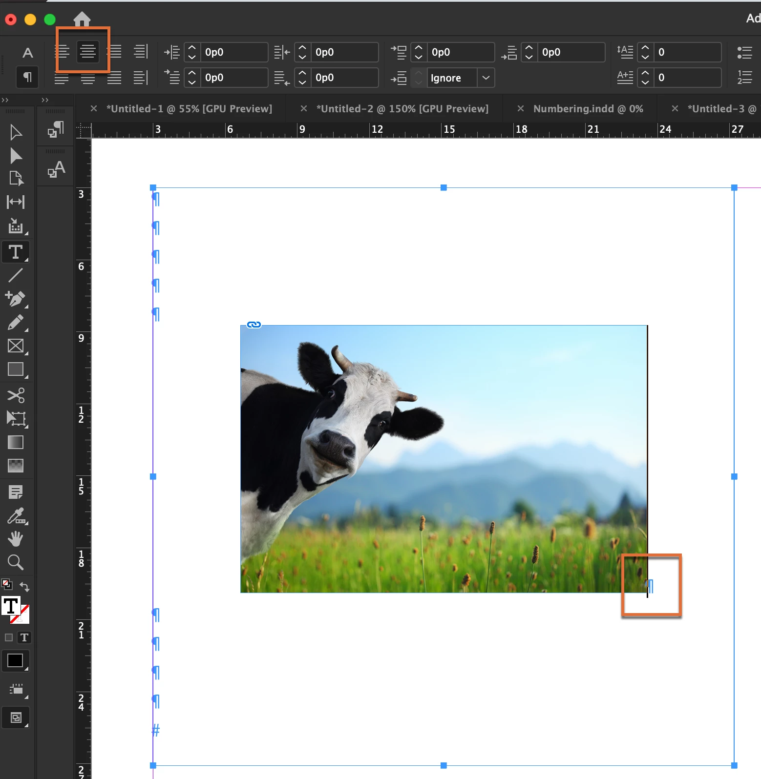

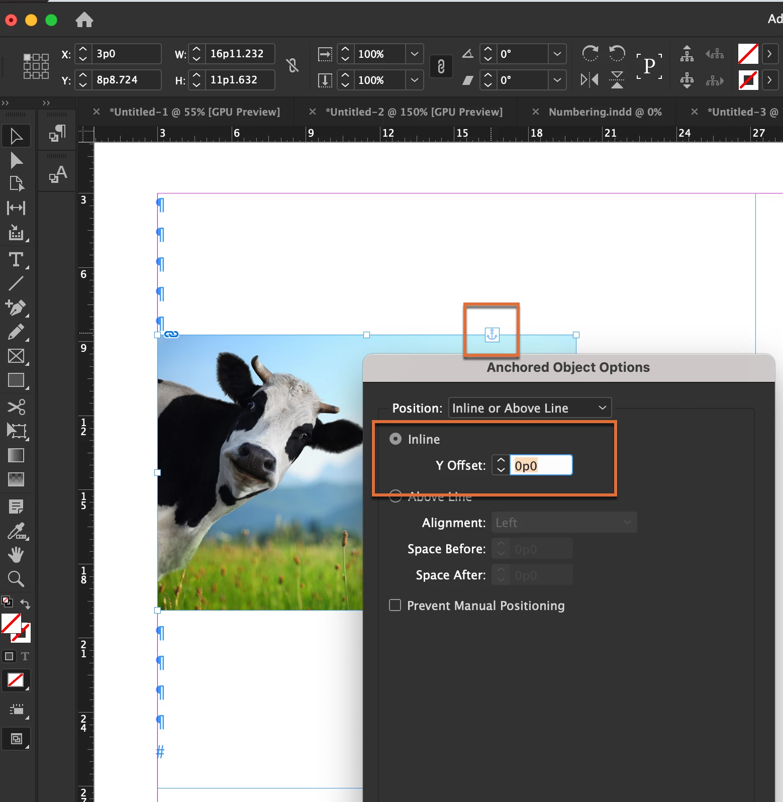

I see—you are using an anchored image. That's why text wrap isn't working the way you expected it to.
What is the goal? To get the ¶s to move above and below the image? If so:
  1. Opt+click the anchor symbol in the top right of the image frame.
  2. Change the anchor position to Inline.
  3. Then click on the ¶ holding the image.
  4. Change the paragraph alignment to Center.
~Barb

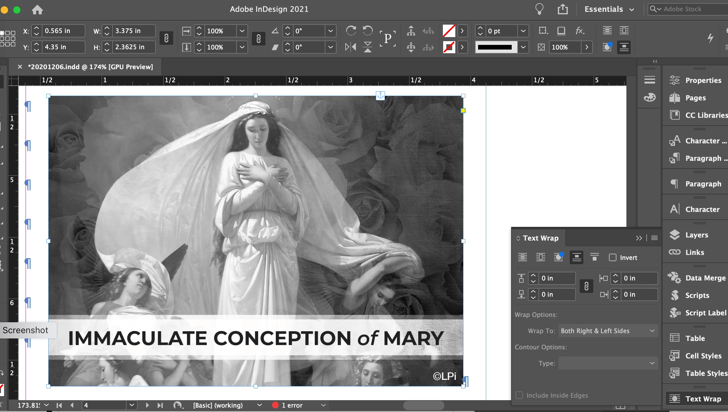

Here's what I have...

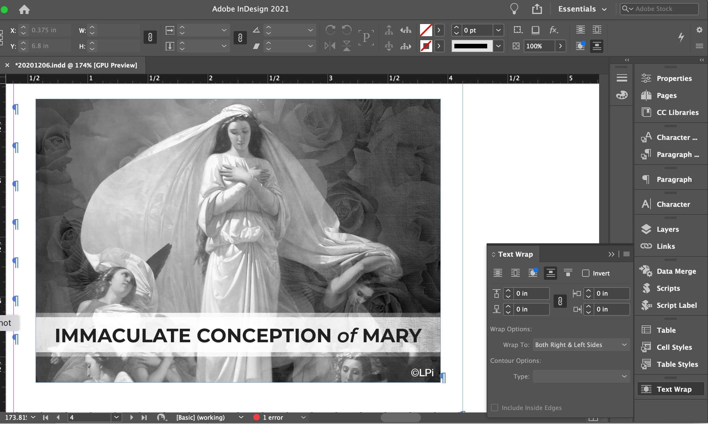

pas2005Author
November 28, 2020
Just realized the image wasn't selected in the previous image.
Barb Binder
November 28, 2020
A screen shot with the frame selected and the text wrap dialog box visible would be helpful here. And try sending the image frame to the back.
Let's confirm that you are specifing text wrap correctly before we move on to troubleshooting a corrupt document, or rebuilding InDesign's cache and preferences.
