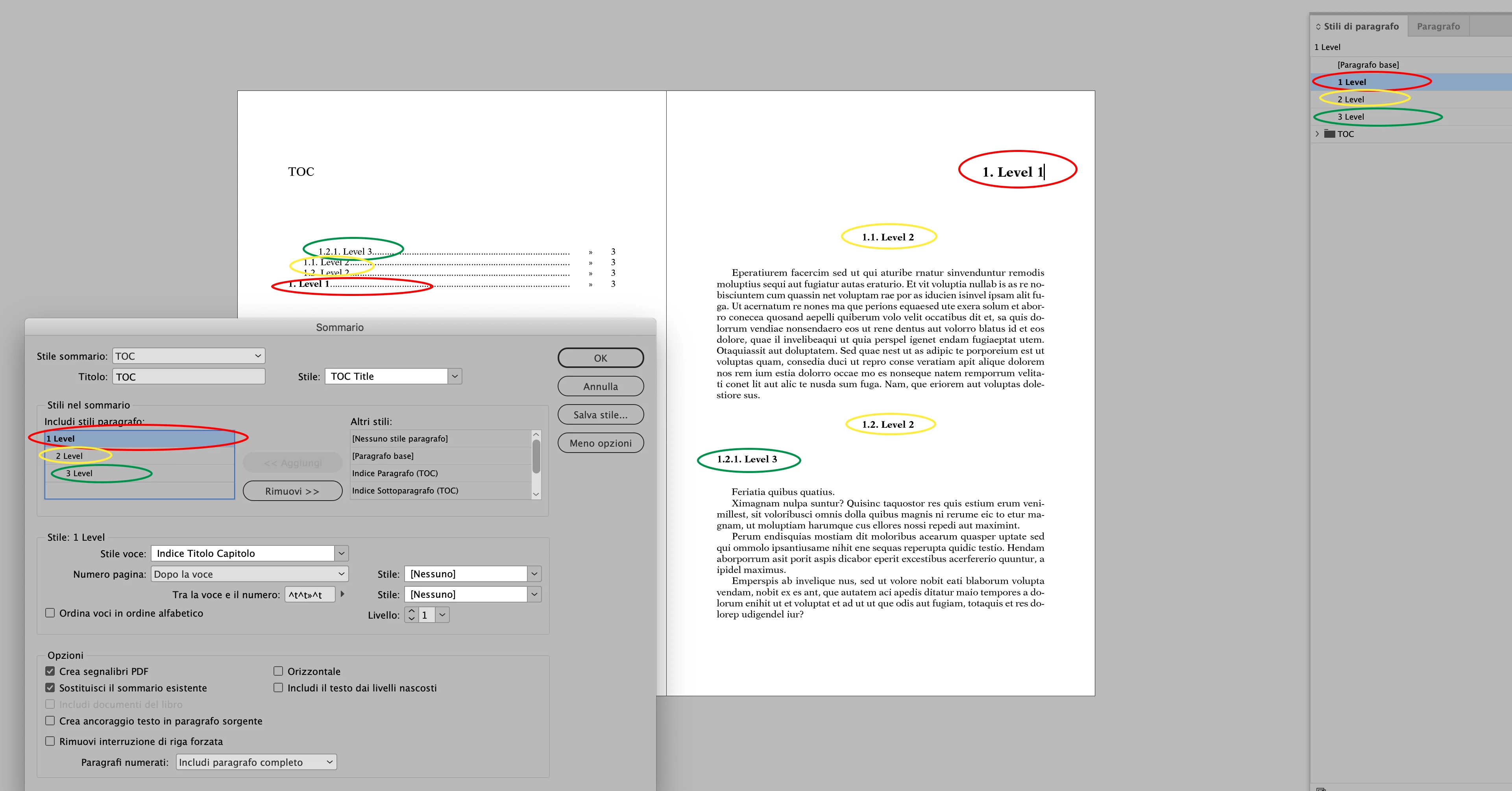

A doc has 3 styles of interest on the title page, ChaptNum, ChaptTitle, and ChaptSubTitle.  They are all on the same layer and the frames are not connected.  These styles are then arranged on the TOC setup as shown above.
ChaptNum (level 1)
   Chapt Title (level 2)
       ChaptSubTitle (level 3)
 When the TOC is generated the order is reversed.
ChaptSubTitle
   ChaptTitle
       ChaptNum
How can I fix this?  (New to ID)

Exactly. Without seeing your file I can't know your settings but I assume you did just like I described above. In that case (disconnected text frames) indesign reads from top left to bottom left and then from top right to bottom right

if this is your issue as in my screenshot then the frames (non connected) of level 1 are more to the right than the other levels and the frames of level 3 are more to the left

From your TOC set-up screen I would have expected to see Level 1 at the top, but instead it is at the bottom, so what you are saying is that since the text frames are not connected the position of the text frame on the page determines where they fall in the TOC? In my example, the ChaptNum style would have to be further left on the page than the other two OR the text frames have to be connected. AM I understanding you correctly?

Since you have the 3 independent "paragraphs of interest" in separate text frames, most likely the problem is the stacking order in the Layers Panel.
  • Open the layer in the Layers Panel.
  • Drag/drop the 3 frames so that the 1st one in the order is at the bottom of the stack, etc.
  • The layer should look like this:
    • ChaptSubTitle (level 3)
    • Chapt Title (level 2)
    • ChaptNum (level 1)
InDesign and other programs often process the items based on the stacking order, and it's bottom-up. That is, the bottom most item is read first, second from the bottom is read next, etc.

I arranged the Layers Panel as you suggested above, but when I set the TOC up the results remain unchanged.  I haven’t found anything that will change the order in any way.  I can however, apply TOC Styles to the TOC, change the tabs, leaders, and the page numbers are correct, it’s just the order that I can’t change.
