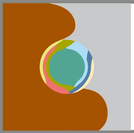

I am wondering if there is a possibility to make white pages transparent in InDesing? I wish to create free shaped pages and was thinking about reaching this by adding white elements of needed forms on a transparent page. Maybe there is another way to change the shape of each single page?

If I understand well, you want to create a book with rounded irregular shapes, is that right? First, you need to create theses shapes on “standard” pages, then fill these shapes with the colours you want to use. Then, you must indicate that theses shapes mut be cut off. So you need to:
  • create a color that you will name “die cut”
  • define that color as a spot color. You can use a dark color (black is good) to simulate it
  • create shapes with a stroke using this color and place these shapes on a separate layer, over the artwork layer
  • do not forget to set the stroke as overprint to avoid that the stroke knocks out the underlying shapes
  • and the most important: speak to the printer/manufacturer

Maybe I have not correctly described my problem. I am trying to get a paper like this brown or sand shapes. I am going to use several colours (not exactly as in pictures). I have to create a file and export it to pdf so that I would be able to create a flip book from it and see something like in the third picture (all pages are shown here). Maybe it is impossible to do something like that with InDesign and I have to find another solution?
