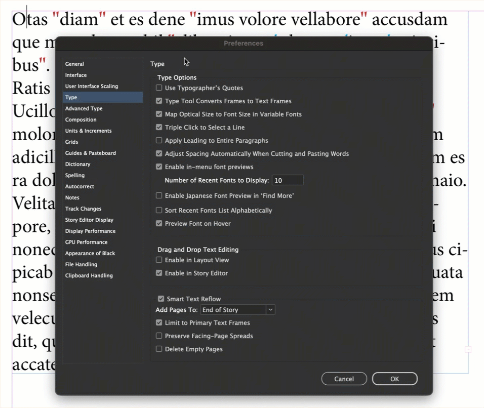

Jul 27, 2024 5:59 PM UTC
Use Typographer's Quotes makes the difference when you use the queries that come free and installed with InDesign. If it is off, they don't work. If it is on, they do.

Barb BinderCommunity ExpertCorrect answer

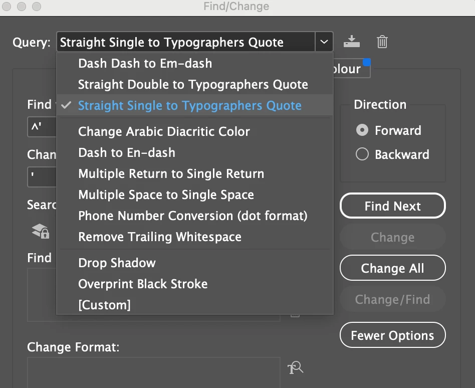

Jul 27, 2024 4:31 PM UTC
Try: Edit > Find/Change and select from the Query drop-down menu: Straight Single to Typographers Quote.
James Gifford—NitroPress
Jul 27, 2024 4:43 PM UTC
Neither of these presets (single/double) has ever worked for me; they leave the straight quote as a straight quote, as the F/R strings more or less establish.
I don't know of any built-in search or feature that can distinguish between left and right typographer's quotes for this purpose. I may well be forgetting something. The GREP above, or something like it, is the only method I've ever found that works.
(ETA: Unless I am missing some subtlety of F/R, these presets are simply broken. The replace marker in both is not interpreted as a typographer's mark, and there is no differentiation for left and right. Has something changed, here, perhaps? ETA2: or is the operation depending on auto-correct to apply the correct polarity of quote?)
