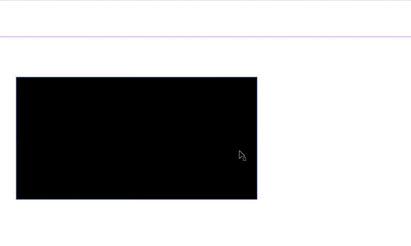

since I go my MacBookPro (15" 2017) I have an annoying bug in InDesign. First I thought its related to the trackpad. But a friend with the exact same specs doesnt have this problem.
When I click on a shape (either with Magic Mouse 2 or Trackpad) sometimes it jumps a little aside. Pretty annoying when you try to work fast and dont want to undo everything over and over again. I insert a gif to demonstrate it. If you look closely you can notice the little jump.
Also, it looks like some click "doesnt count". When I try to select the color in the color menu it cant be selected and after multiple clicking it takes it.
At work on my iMac I never had this problem. Also tried reinstall InDesign. I believe its some third party software that creates this issue. But I dont want to fully reset my MacBook. Is there a way to only boot with InDesign? I think in safeboot also InDesign is disabled right? Or how can I test what app it is or what InDesign setting / Mac setting is messed up?
I think its not my fault how fast I click/ move the mouse, because I just do the same at work (iMac, Magic Mouse) without this issue.
While trying to record the color problem I noticed that my cursor swapped to a small hand icon, like its trying to move the color. I think the same thing happens to my shapes. Like the mouse is holding "too long". Is there a way to control this anywhere?
I hope its related enough to InDesign because I think the error isnt withing InDesign. But its the only program I notice this issue. Non of the other CC programs.
Thanks for your help.
