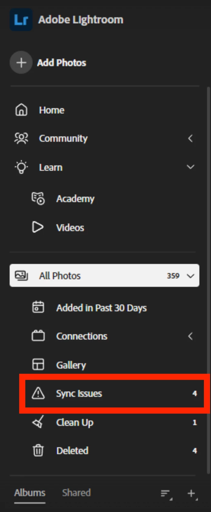

    Please try the following:
    • Open Lightroom Web and check the right panel for “All Sync Errors”.
    • If you see images listed there:
        •    Remove them from that section
        •    Then delete them from the Deleted folder as well
        •    Allow sync to run again
    Important: Make sure those photos are safely backed up somewhere before removing them from sync and from the Deleted folder to avoid any accidental data loss.

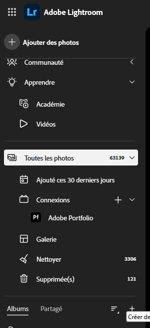

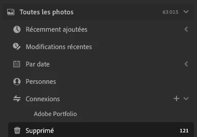

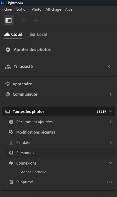

    coustoulin
    Feb 28, 2026 10:52 AM UTC
    Hello
    I am sorry, but I cannot see “sync issues” the option is not visible in the menu.
    LR Web
    LR on PC
    How can I proceed ?
    Anshul_Saini
    Mar 4, 2026 4:02 PM UTC

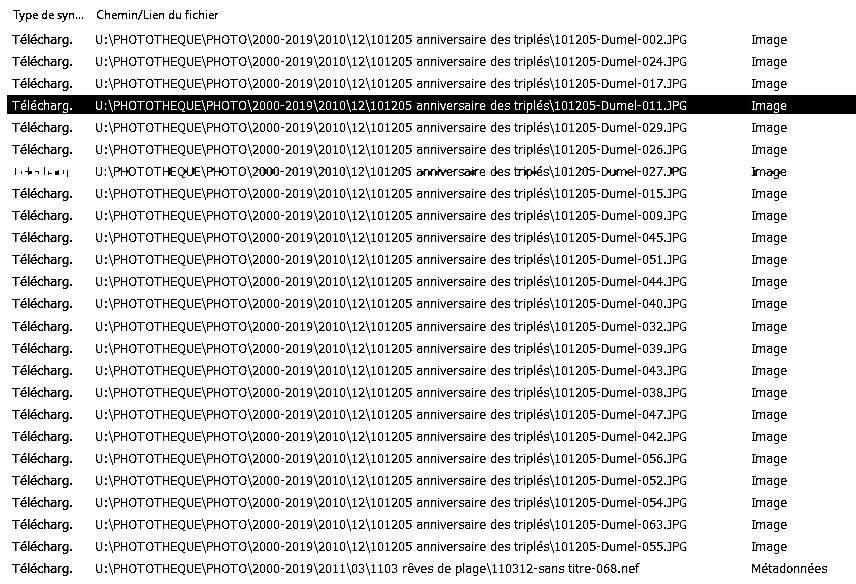

    Thank you for the screenshots, ​@coustoulin. That clarifies things.
    If you do not see “All Sync Errors” in Lightroom Web, that means:
    • There are currently no hard sync error items flagged on the cloud side
    • The 25 assets being uploaded are not classified as “Sync Errors.”
    So we’ll proceed slightly differently.
    Next steps:
    • In Lightroom Web, open All Photos
    • Sort by Recently Added
    • Scroll to the most recent items and check if any thumbnails show warning icons
    If you do not see anything unusual there, then in Lightroom Classic:
    • Click the cloud icon (top-right)
    • Expand the Sync Activity panel
    • Check whether it lists specific file names repeatedly
    Important clarification from the product team:
    • The difference between 63,015 (cloud) and 52,373 (LrC) is very likely due to videos
    • Lightroom Classic downloads videos but does not show them inside “All Synced Photographs.”
    • This is expected behavior and can explain large count differences
    If the number stays frozen at 25 for several hours, let me know:
    • Whether the same filenames appear repeatedly in the Sync panel
    • Whether those files exist locally and on Web
    I’ll stay with you on this.

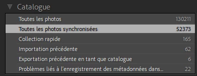

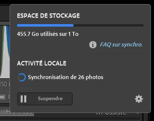

    coustoulin
    Feb 21, 2026 9:46 PM UTC
    Hi ​@Anshul_Saini
    Here is a link to get the new diag files : link to wetransfer
    some additional points  :
    • there are 26 pics waiting indicated in this pannel
    cloud pannel
    • The preference pannel show only 25 pics. All of them are in the folder “Toutes les photos synchronisées”.
    • only 1 is in my LR : the 110312-sans titre-068.nef the others are only on LRC
    • I do not understand the meaning of the info “image”/”Métadonnées” ! what is the problem ?
    List of sync pbs
    • I do not undesrtand why I have 63015 pics in LR and only 52373 in LRC. What are the 10642 pics not known by LRC ? how can I determine whicj they are and why the difference ?
    52373 pics synced in LRC
    63015 in LR
    Please send to me a message to indicate you receive all the info
    regards
