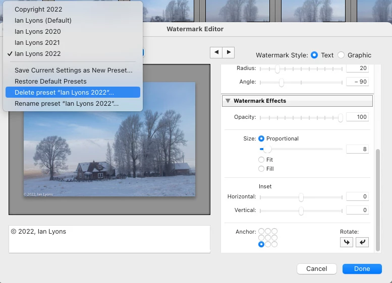

Great news that you were able to remove the unwanted Watermarks, although next time it might be easier to remove them using the 'Watermark Editor' as shown in attached screenshot.
Note that you must first select the watermark text in window before the remove option becomes available in the context menu.

Interesting! I looked at it and yes it seems pretty easy, but none of this information was apparent of a web search even in LRC. Thanks Ian for the guidance!
I did find it easy to batch delete a number of experiment watermarks as listed in my post. Both would get it done.
