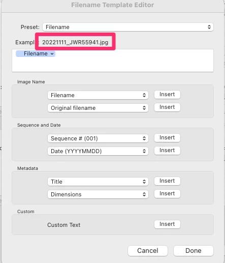

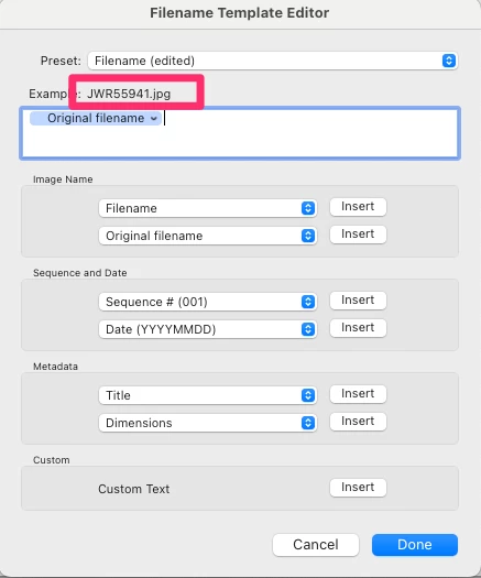

So use the "Original Filename" when renaming during export. See these screenshots when importing an image that I originally renamed during import to add the capture date:
If I use "Filename" in the rename template editor:
But when I use "Original Filename" I would get this:
