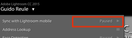

    greule
    March 10, 2017
    I have desktop lightroom (CC), and I installed mobile LR, but my photos are not being sync fro my 7Plus to my desktop.
    When I click in the little cloud icon the message says "All up to date"
    What should I do?
    thank you
    HI Margarida, could you double check if syncing with  Lr Mobile is paused from within Lr CC.... . Just open up the top left activity window as shown in the attached sceenshot....
    Hope this helps.
    With sync enabled you should see your collection which you have created via mobile app under LrCC-> Collections-> From Lr Mobile
    Hope this helps.
