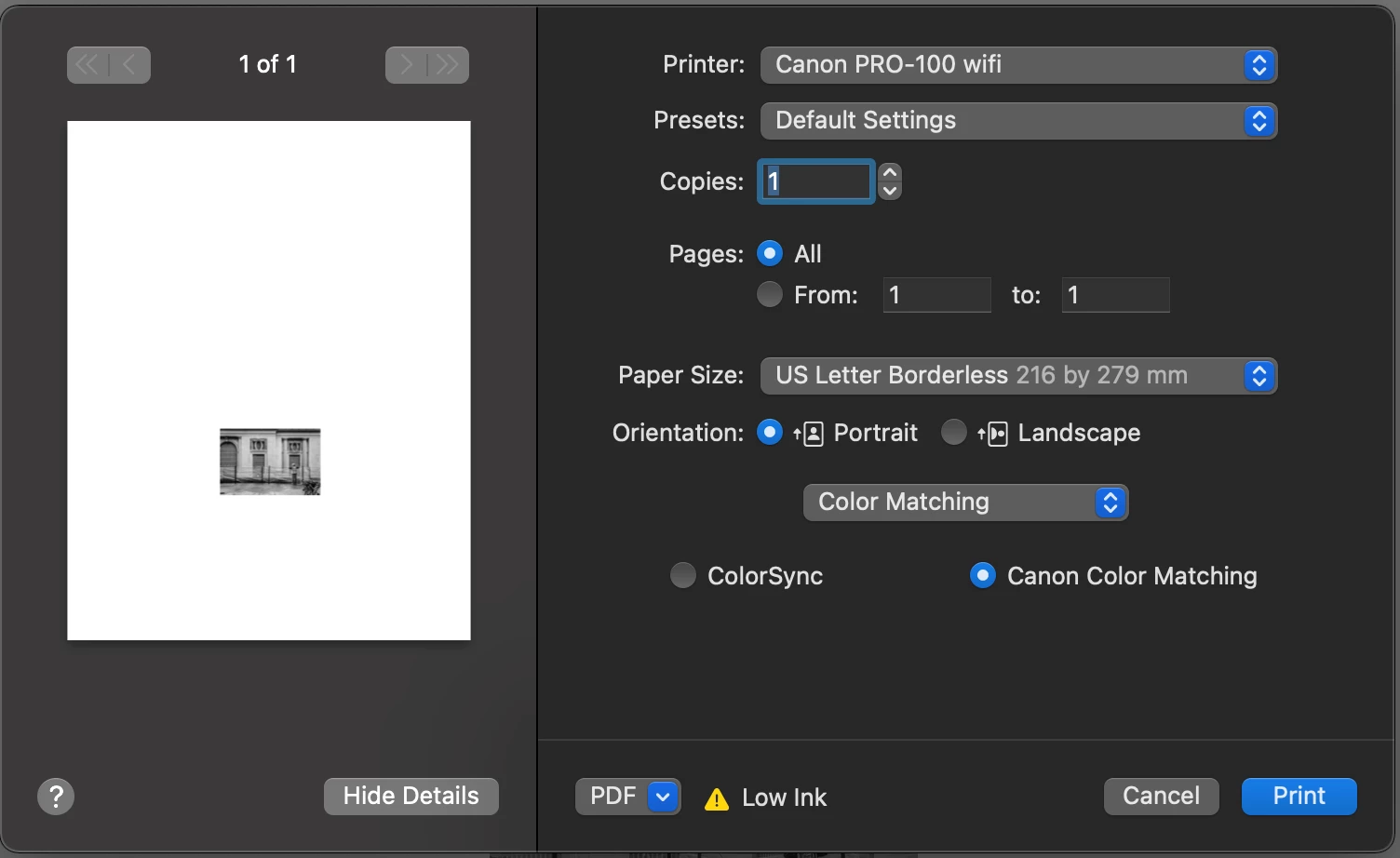

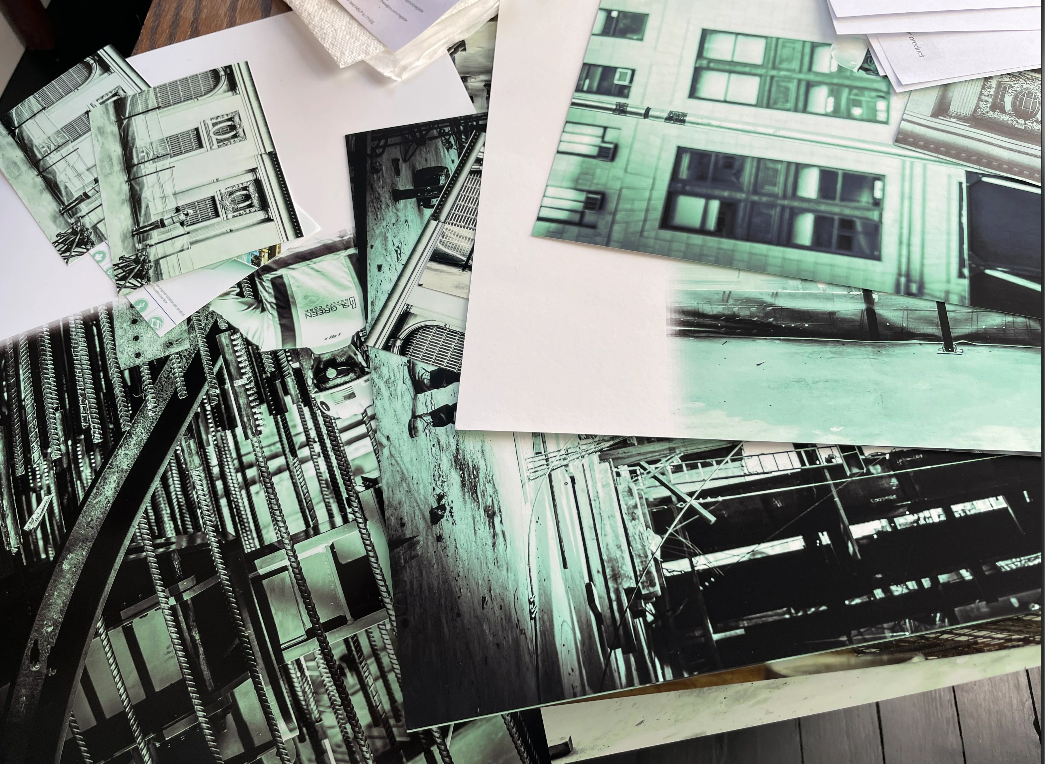

Longtime LR and Pixma Pro printer user. I often make b/w prints and color accuracy has always been on point with my Pixma no matter the type of paper or color/black&white. I've never messed with the color profile settings because I've never needed to. Fast forward to today, I recently upgraded to LR 10 and was disturbed to see a major green color tint to all the 13x19 prints I ran through my Pixma Pro 100 (via USB connection). The black and white prints are most heavily affected. In addition to heavy green tint they seem to be slightly overexposed.
Other details:
- When I print using Preview app it seems to neutralize the green cast mostly, but it still seems strangely overexposed. Should color settings affect exposure also on a b/w image?
- I usually have the profile managed by computer and in computer settings
- In print dialogue I usually have Canon Color Mathcing selected. I tried ColorSync which seemed to slightly improve the results. Why it would improve only slightly has me baffled.
- Running LR 10 and Big Sur on iMac Pro
- Generating PDF within print dialogue works fine like usual. It's only when file is printed

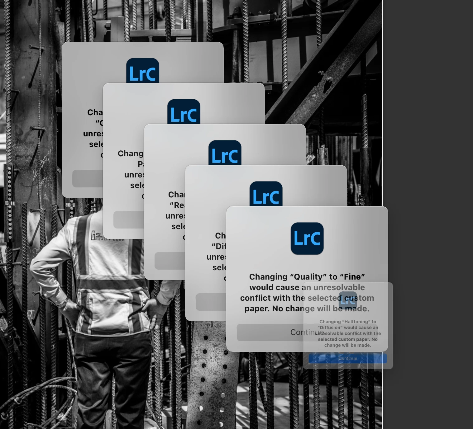

- When I opened LR print module I got a series of strange dialogue boxes and kept popping up. See attached graphic. Maybe this could be related??

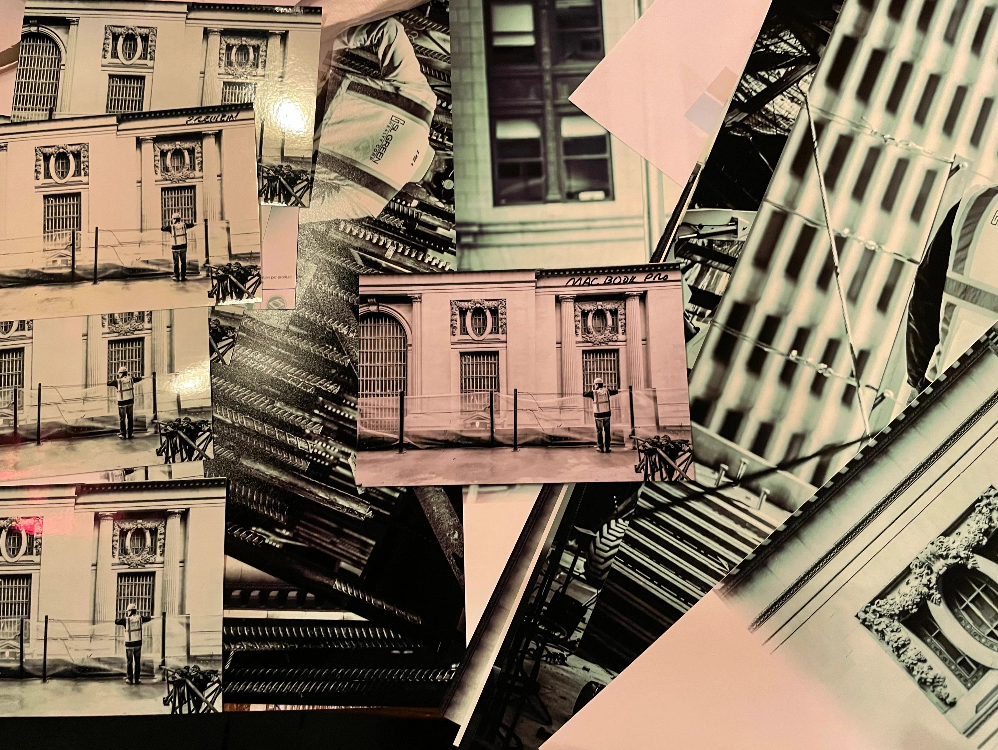

Here's what the prints look like -- keep in mind that my iPhone is adjusting the tint of the shot to account for all the green but  the warmer/magenta-ish shot in the center look b/w in person. After a few came out looking normal, printing from the Macbook Pro started casting green prints like the iMac Pro

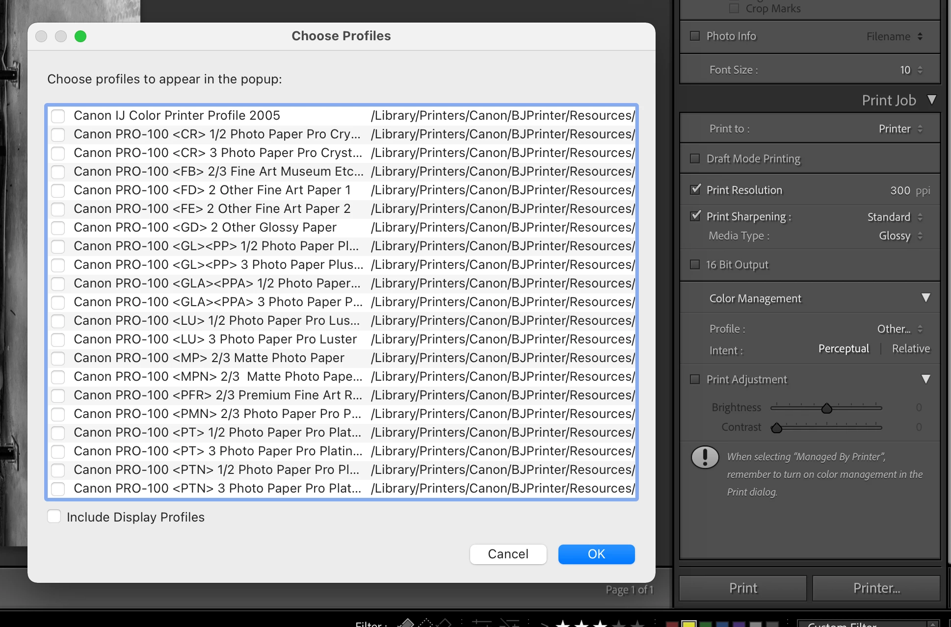

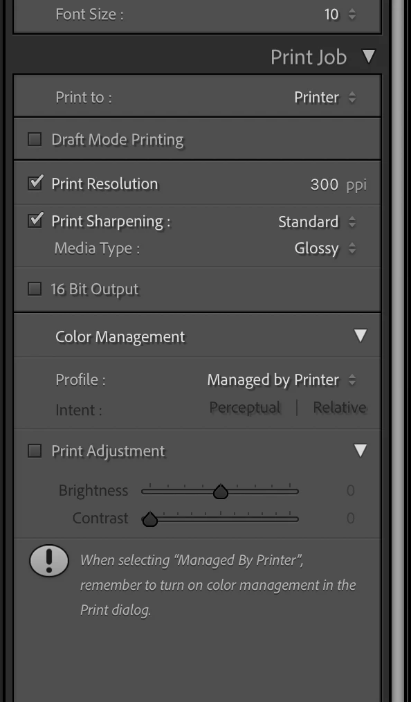

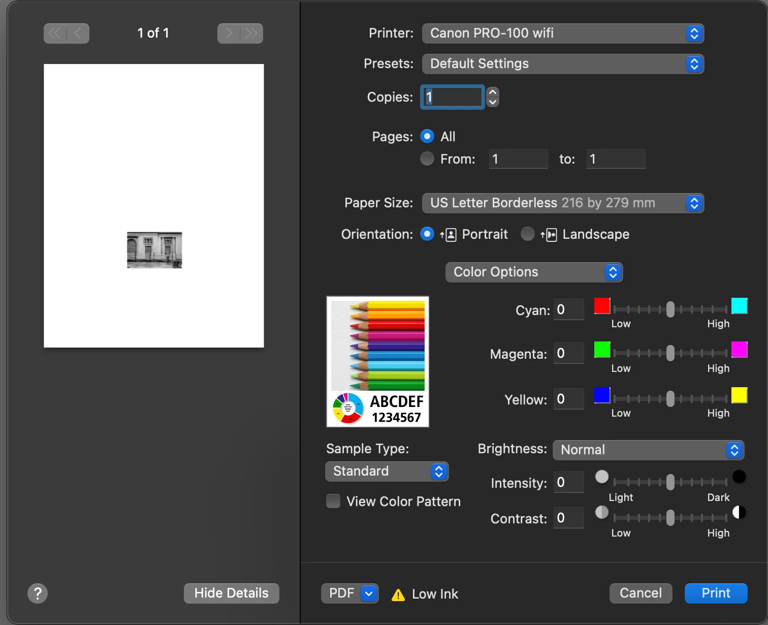

if possible, please share a screen capture of your print settings from Lr and the print driver? It sounds as though you might have two competing color management systems operating. What do you have listed under Profile in the Print module?

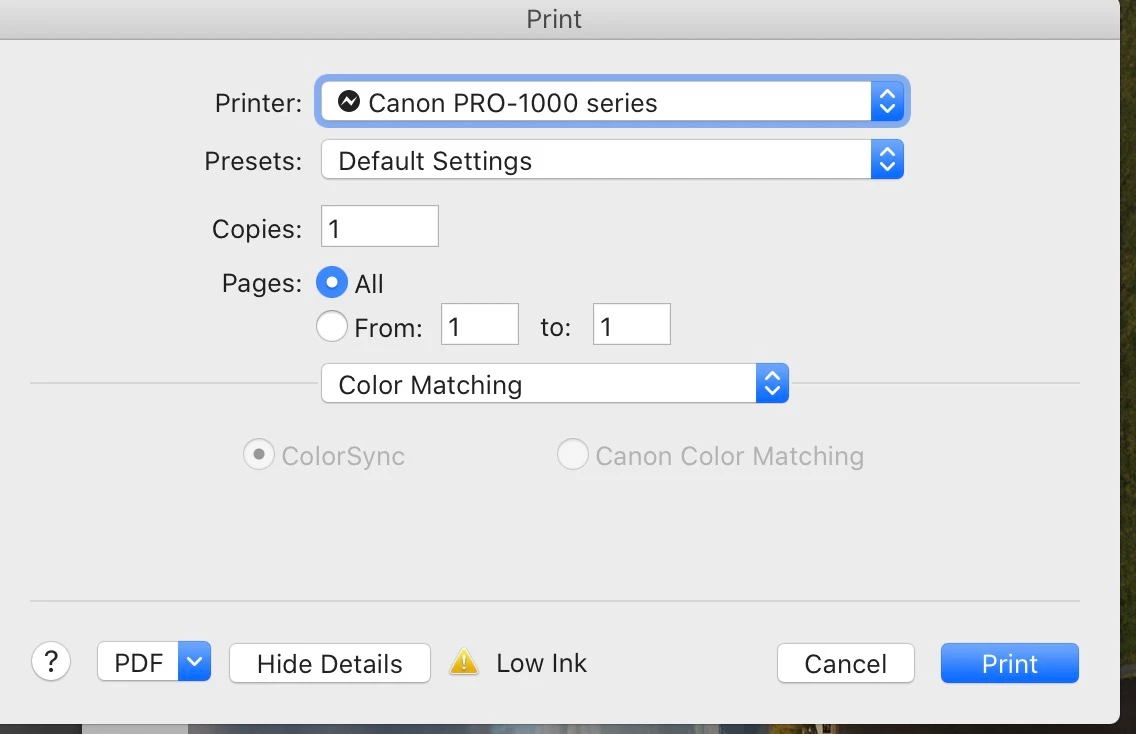

Sure, I have screen captures of settings and prints themselves inserted below. I figured since the issue persists outside of Lightroom that tinkering with the Lr print settings won’t stop the problem in Acrobat or Preview but I included a screenshot of those settings, including the list of profiles, which I've never messed with.

I tried printing in different applications (Preview had better results but issue still persists), different computers, wifi and USB connected, all paper sizes, ‘b/w photo print” checked and unchecked, all with no luck.
I tried using standard settings that have always worked in the print dialogue, as well as tinkering with Color Matching options. Worth noting that some prints seem to have a heavier green tint than others, especially the few that printed via Preview nearly but not quite black&white images, however more recent tests show more of the mint green that are affecting all the prints.

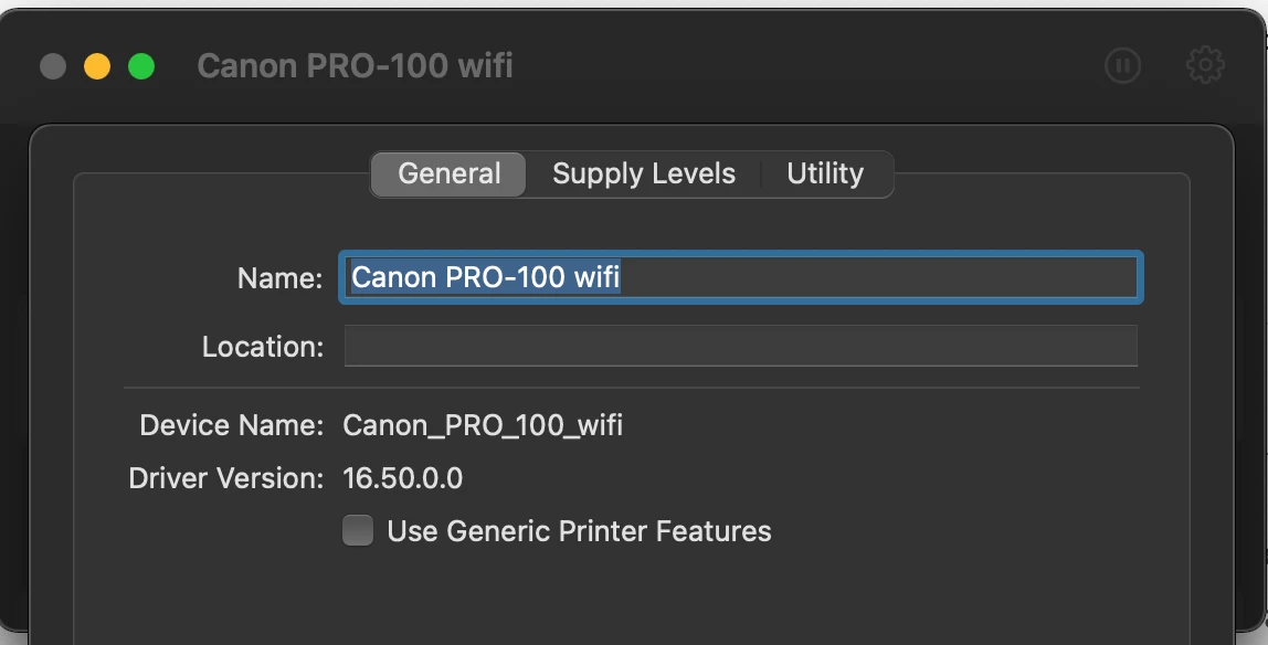

Then I updated the print driver which i believe was out of date and the problem seemed to go away! (It’s currently File version: 16.50.0.0, see screenshot). After the test prints I ran ten 4x6 shots and they looked perfect. Then another 10 and back to the green cast….

Thank you for the detailed response. I might have missed the information, but what paper are you using? I ask because I have found that I achieve the best results when having Lightroom apply a Profile and thus having the application and no the printer handle color management. You have the right idea of choosing the profile that corresponds to your paper and printer.
