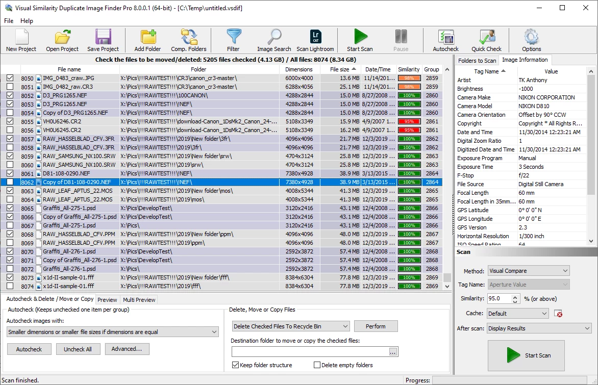

Since I found Visual Similarity Duplicate Image Finder I stopped using those plugins as they scan EXIF data and are very unreliable. This tool provides true image analysis and can find not only duplicates but also similar photos.
Has support for 300+ RAW camera formats and 40 popular image formats - visible on the screenshot below.
There is a short Lightroom tutorial here: Lightroom Duplicate Finder

This software is looking very promising to find duplicates. I am following its development keenly. (The [Scan Lightroom] button looks promising)
But, and this is a warning, or a Caution- The interface TBMK does NOT indicate which of the files has been edited in Lightroom-Classic.
You may have spent many hours in LrC developing one (or both) of these (eg. files as in the screen-clip), so which one will you delete? How will you check that? Delete the 'wrong' one and you have lost all your work in LrC unless you can re-link  the now 'Missing' photo in the Catalog Library to the 'other' file in another folder..
IMO- the Plugin Dup Finders are still currently the 'safest' to avoid 'damaging' the Catalog.

Thank you very much for pointing that out, but I can see instantly if an image is edited in the preview panel. Actually there are even two preview panesl. One is multi-preview that shows all simialr images and the other one is the regular preview which shows two images side-by-side for more details. Clicking a preview image shows a full-screen preview too (this makes them 3 previews sorry) which you can also use to navigate and mark photos without having to close and open it every time. Overall I am more confident using this tool than any of the plugins that are available.
If you want to stay on the safe side you can also move the duplicates to a temp folder prior to completely removing them. Definitely there is no way to "damage" your catalog.
Why I do not like plugins:
1. They can not list similar images
2. They rely on EXIF and list completely different photos as duplicates
3. They are limited only to LR and you can not check if a folder is already imported. The above tool can compare your catalog to a folder so you can check if images in a folder are already imported prior to generating new duplicates.
Of course if you are used to plugins then you will need some time to get used to the tool as it works in a completely different way, but if you play wiht it for a while you will understand that it is much more flexible. It can keep the higher-quality photos automatically, can makr photos by various properties and much more.
I did use those plugins too, but since switching to this one I never needed to go back.
