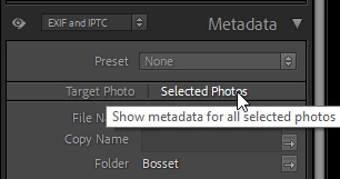

Correct answer Ian Lyons
You need to tap on the 'new' and less than obvious 'Select Photos' button as shown in below screenshot. This enables the ability to apply metadata to multiple selected photos

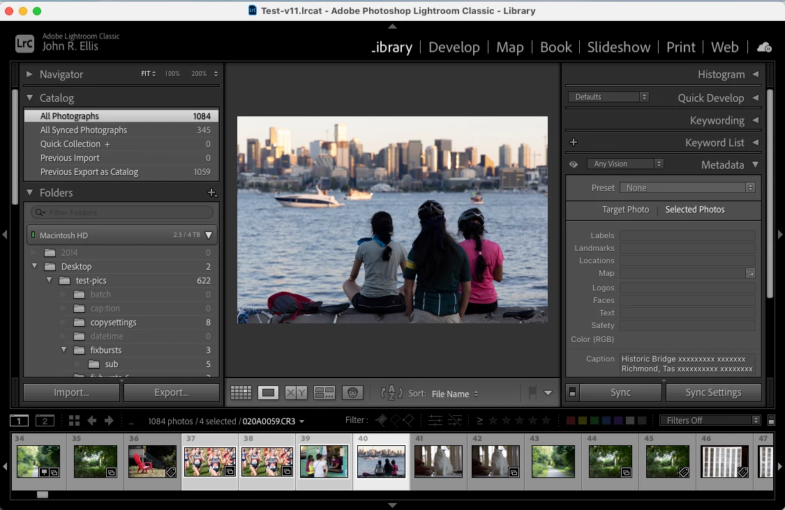

In LrC's Library module, when you are in Loupe view (one image filling the main window) the general idea is that only this active image will be affected by changes, even if the Filmstrip may show several images highlighted. And the same thing for the Develop module, which in effect is always in Loupe view.
In Library: when you are in Grid view though, many kinds of change will apply across all highlighted images (but I don't think all kinds, and see below about Metadata specifically). Library also has got other kinds of view such as Survey - these do not act quite like Grid view so far as editing 'in the batch'.
BUT - you can "force" batch editing in any context by turning on AutoSync, using a switch at the left bottom corner of the right side panels. Any new edit carried out while this mode is active, will apply to all the currently highlighted images. There's an AutoSync switch for Library and an independent one for Develop. I do recommend caution with AutoSync since it is notoriously easy to apply unwanted edits onto a whole lot of images, if you ever forget it's active (and it will remain so if you e.g. close and restart Lightroom Classic). Perhaps make a habit of turning it off except while you are consciously working 'in the batch'.
Finally, the Metadata panel has recently gained a "Targeted Photo / Selected Photos" switch. This switch only appears when multiple images are highlighted. It controls both the display and the changing of metadata fields. When set to Targeted Photo, even if contents of a particular metadata field currently vary for the selected images, you are only shown the contents of, and can only alter, this field for the current active photo. When set to Selected Photos, if a field varies across these images you will see "< mixed >", and any new update will then write onto all these images. There's a warning dialog as below - the menu entry referred to, is the same thing as the switch within the metadata panel.
Note that if you have AutoSync turned on, that will I think override this more subtle behaviour, and always force a "bulk" change onto all the highlighted images.

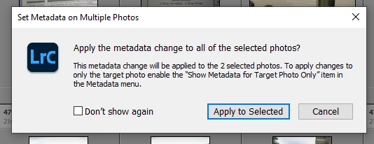

Bug in adding a caption to multiple images in Lightroom Classic ver 11.4 no longer works. I used to be able to select multiple images in Library Module, add a caption, click enter and LR would ask if I wanted to add to all. Okaying or accepting this would add the same caption to all. "Most selected" image seems to work differently in this version.
Expected outcome:
Step 1. Select multiple images in Library Display (note NOT by the filmstrip) grid.
Step 2. Under Metadata>Caption type in a caption.
Step 3. When done, hit ENTER, and approve "adding to all" or some such warning.
Expected RESULT. All selected images used to have the same caption.
Actual Result: Only the "most selected" image has the entered caption.

I just verified that the 11.4 release seems to work the same in this regard as the past few releases. I selected several images and added a caption to all of them at once. It worked. Two things to note: it must be done in Grid view, not Loupe view, and the "Selected Photos" switch must be set (up near the top of the metadata panel, just under the Preset dropdown; it will only be visible if multiple photos are selected).
This "Selected Photos" switch was the change of behavior several releases ago that caused so much angst and this whole, long thread.

I can answer your first question – click Selected Photos at the top of the Metadata panel.

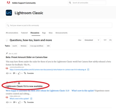

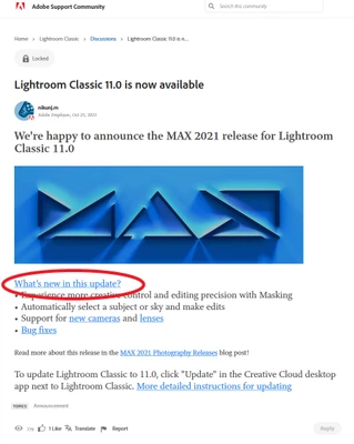

At the Adobe Support Community, in Lightroom Classic, Under Discussion, right near the top, notice the document link that is ALWAYS provided when updates/upgrades are released. Here:
I have encircled the link in the screenshot above, go in the actual web page, and click on that link
Notice the link within that document that I encircled, on the actual web page, click on it
That brings up a document Adobe ALWAYS posts at updates and upgrades. Several articles may be included. Especially at upgrades. Notice that I circled two, you will want/need to bring up and read both. For now, for the subject at hand, on the actual web page, click on that one circled in blue, the one about Metadata
