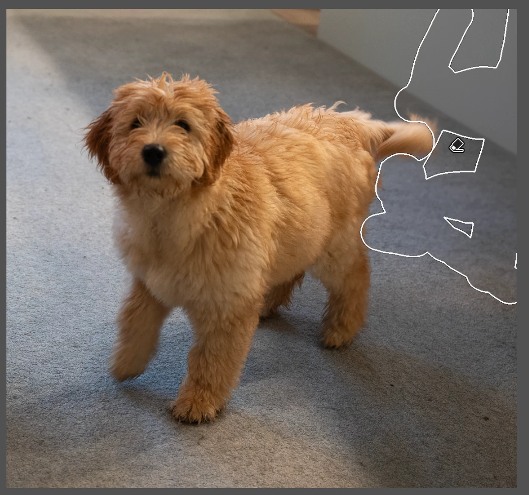

Sep 4, 2025 1:54 AM UTC
[This post contains formatting and embedded images that don't appear in email. View the post in your Web browser.]
@Maximiliano_Favilla1975: "I want to eliminate a fan, and all it gives me are spots, white or black, but it never generates the fill."
With your screenshot, Generative AI Remove did a pretty good job when I selected the shadows below the fan as well:
Please attach here a full-resolution JPEG exported from the original, unedited photo, to verify that the same selection works well on the full photo.
