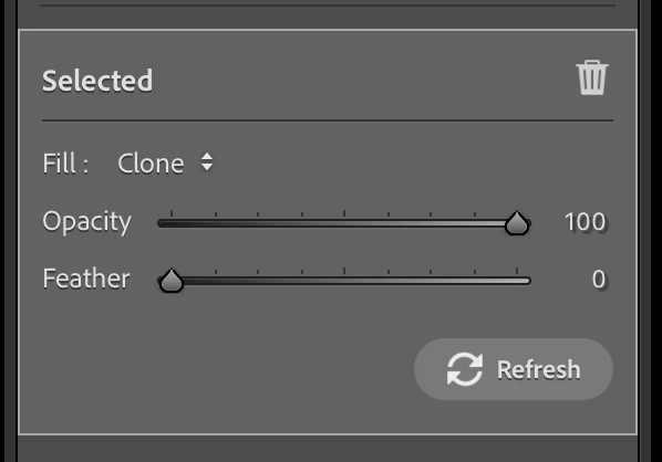

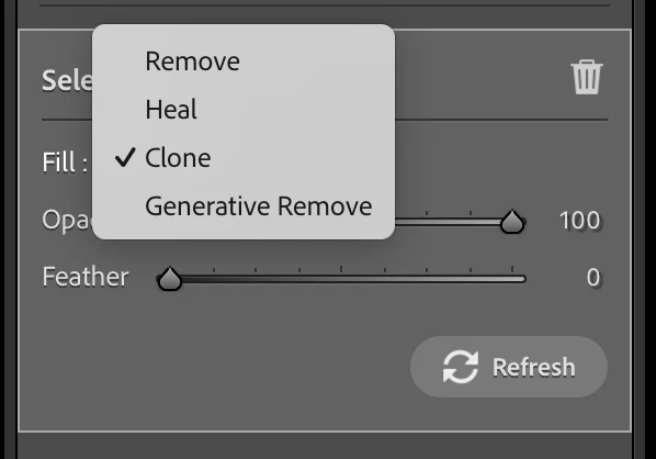

Please let us feather the selection like in photoshop.
Idk why opactiy made it in when the goal of this to replace something in the general image but here we are.
