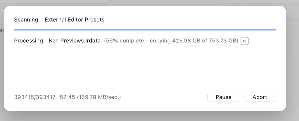

I need an expert's opinion and advice.... What would normally take just a few minutes now goes on for hours of incredibly slow backup time when it gets to this... 'presets' part of the backup of the lightroom catalog. Is it necessary to include this? My take on it is that it is incredibly encrypted so it making the backup software work hard to actually reproduce and backup... Yes, it does backup successfully and eventually, but I'm thinking I'm wasting time backup up the Lightroom catalog this way. Not backing up the actaul files as they are on external drives but just the 'catalog' that Lightroom uses to locate and sort and organize what is in the catalog. Someone who understands what is going on, do I need to go through this long abnormal backup process of 'presets', or, do you have anything to say or recommend... Tia, Ken

In addition to all other good advice from @Conrad_C and @Ian Lyons, the size of your "Ken Previews.lrdata" is ridiculously large. This suggests to me that something has gone seriously wrong here and LrC has lost track of much of its content. LrC now culls the Previews to prevent them from filling the disc, so how your Previews could get to 754GB in size doesn't make sense if everything was working properly.
As for External Editor Presets, I have no idea what that is: it's not in my ... Previews.lrdata.
The simiple solution, as @Conrad_C has provided, is to delete "Ken Previews.lrdata" and then let LrC rebuild it as necessary.
While you are at it, it might be prudent to delete "Ken Helper.lrdata" as well: LrC will recreate this when next launched. Better still, just rename it "Ken Helper-OLD.lrdata" to begin with, let LrC recreate "Ken Helper.lrdata" and check there are no problems. After running for a while without any issues, then you can delete "Len Helper-OLD.lrdata".
Do not delete or rename any of these while LrC is running. Close LrC first.
Ken.lrcat is your catalog: do not delete. Ken.lrcat-data holds your AI Masks and Generative AI Removes: don't delete this unless you want to regenerate all your AI Masks and Generative AI Removes, which could result in unwanted changes, especially for Generative AI Removes.

What it’s processing is the file "Ken Previews.lrdata". Because the filename ends in "…Previews.lrdata", that is a cache of previews for a catalog named “Ken“ (full filename “Ken.lrcat”). There are two important things about the preview cache: It’s expendable (if it is lost, Lightroom Classic automatically rebuilds that cache anyway), and it can grow to be huge which will take over your storage and slow down backups.
quote
…incredibly slow backup time when it gets to this... 'presets' part of the backup of the lightroom catalog. Is it necessary to include this?
By @Ken Nielsen
Note that it is not backing up a large presets file. It says it’s only scanning External Editor Presets (analyzing it for changes before backing it up). The file that the backup app says it’s actually processing (backing up) is the "Ken Previews.lrdata" file.
And in fact the "…Previews.lrdata" file in the screen shot has become absolutely massive. 753.7GB is over 3/4 of a terabyte — many times larger than the catalog file itself — so you are waiting for that extremely huge file to get backed up, and that huge file is also taking over a lot of the free space in your backup volume. At 753.7GB, that single cache file might be taking up more space than all of the other data on your Mac combined; remember that the base models of today’s Macs start at only 512GB of storage!
What to do about it (some of these have already been mentioned):
  • There is nothing wrong with backing up that way, but assuming your backup software has an exclusion filter, use that filter to exclude all "…Previews.lrdata" files from backups. Again, these don’t need to be backed up because they’re just expendable caches.
  • You can also use the relatively new option in Lightroom Classic Catalog Settings / Previews called Limit Preview Cache Size. I set my preview cache size limit to 10GB.
  • Or, you can do what I used to before Adobe added the Limit Preview Cache Size option: When my "…Previews.lrdata" file grew to be over 30 or 40GB, I would just delete it, because I need to keep space free on my limited MacBook Pro internal storage and I knew Lightroom Classic would start over and regenerate it anyway.
In my case, I have the preview cache excluded from backups, and even if it was included it would only be 10GB (compared to over 750GB) because I have limited its size in Catalog Settings.
A note about the backup feature built into Lightroom Classic itself: It backs up only the catalog, not the "…Previews.lrdata" file or other associated files like presets.

I've got to include this question: what is the difference between 'previews' and 'presets' and can they both easily be eliminated from 'backups' of lcat data which I gather is the true backup of the catalog structure that links the entire Lightroom catalog together with the image files on disk?
Ian Lyons
May 30, 2025
You appear to be using a third party backup solution. The built-in LrC backup backs up '.lrcat' and '.lrcat-data''. Previews are not included because they can be rebuilt.
No you don't! Use the built-in backup!

I'm using the built-in backup to backup to my hard drive. Then making a backup of that copy to an external drive. It's when I make a backup of that external drive that it slows down incredibly slow. From what I am gathering, I can eliminate the 'previews' from the backup of the external drive as Lightroom can reconstruct them if ever need be. Does this sound correct to you?

Thank you... These 'presets' seem to be the problem and from what I gather, they are not needed as a part of making a backup as Lightroom will reconstruct them if they are missing? Is that true?
Conrad_C
May 30, 2025
See my reply below…it is not about presets, it’s about the Previews file. Focus on the
"…Previews.lrdata" file that your screen shot clearly shows has grown to occupy over 3/4 of a terabyte!
Yes, the Adobe reply missed this critical point. It talked about excluding presets, but doing that will not save you any time or backup space. Previews are the problem, not presets.
(Presets take up almost no space, previews can potentially take up many GB of space.)
