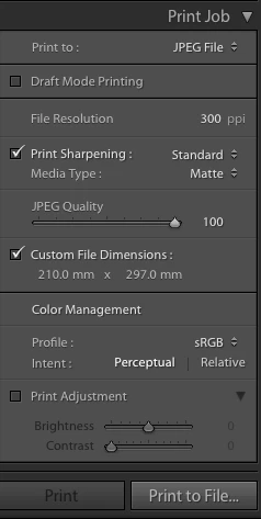

The bigger filesize from the print module is likely because you selected jpeg quality 100. That is never necesary and jpegs from cameras never use quality 100 so your original file probably wasn't at that quality setting. There is no visual difference in prints from quality 85 up. I tested this thoroughly and it is just not possible to see it. A second factor is that you have output sharpening specified, which will increase the complexity of the image and therefore the jpeg filesize. Lastly, we do not know the resolution of the original image. Perhaps you are upscaling to hit 300 ppi, which will also increase the filesize.

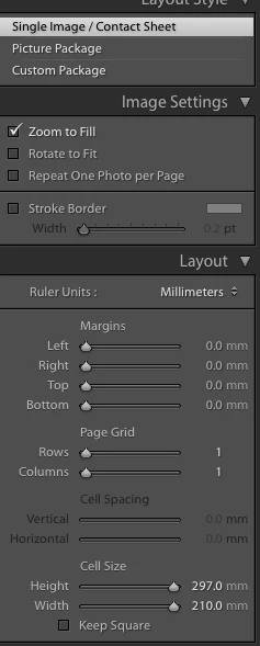

I'm seeing 210 x 297mm on the image for paper size. Check all of the settings as shown below, which is what I used. If your still seeing  209.99 x 297 mm paper size on the image preview I suggest resetting LR Preferences file as outlined at the below link. I suggest renaming or moving the Preferences file so you can easily restore it if of no help. Make sure to first close LR. When you restart LR it will have ALL of the settings back to their defaults. Change ONLY the settings in the Print module as shown in my screen shot and see if the white sliver and paper dimensions in the image preview are fixed.
https://www.lightroomqueen.com/how-do-i-reset-lightrooms-preferences/
"I've tried several and when the cell size is 210 x 297 or 3508 x 2480, the exported file always comes out at 3507 x 2480. "
As mentioned it's probably due to rounding when file dimensions are in mm due to files Resolution being in inches (ppi). I would call it a bug because simply using two decimal places in the calculation will provide the expected results. Regardless the missing one (1) pixel will never show when output to a printer. Due to print head to paper alignment variations all printers use a small amount of bleed to insure there is no white border on borderless prints.

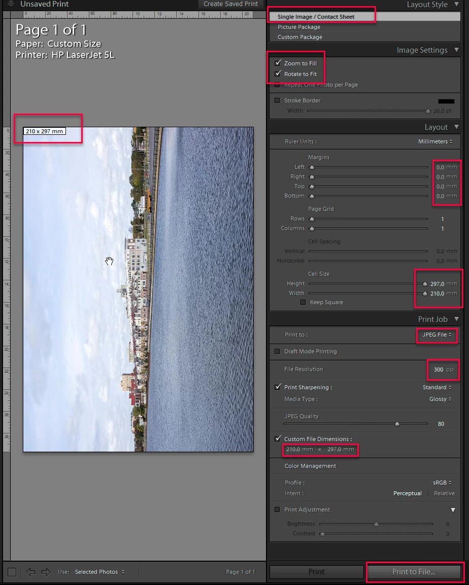

Karen, you keep changing the target objective, which was originally to add a 10mm stroke border to the JPEG output print file. Either way I can not duplicate what you are seeing with Margins set to 0 mm or 10 mm. The JPEG output file is 2480 x 3507 pixels due to rounding errors, but I do NOT see the "tiny edge of white" as in your screenshot. The best way to figure out what's wrong is to provide the original file with ALL your settings applied including crop, etc. You can do this by exporting the file to DNG file format and uploading it to Dropbox or other file sharing site and pasting the share link in a reply here.
BTW what does it look like with your settings if you simply set the Margins to 10 mm, which was the original objective? It works perfectly on my system.

Hi - sorry for the late response.
Ignore my comments about resizing under the Develop menu before printing. I think I'm making it more confusing than it is.
So I have my original image and want to print to file at A4  or  210 x 297 mm. Below are my print options.
The output for an A4 should be 2480 x 3508 px and mine comes out at 2480 x 3507 px!
And as my picture below shows, in lightroom there is a tiny edge of 'white' on the right that simply won't go! Also corroborated by the image size, which is 209.99 instead of 210.
I hope that makes sense and hope you can help once more! It's driving me crazy! 🙂
May 22, 2020
Forgot to include this pic!

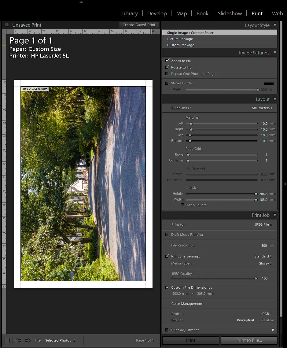

You can create a 10mm white border using the Margins settings as in the below example. To keep the border uniform you will need to check 'Zoom to Fill' which may crop a small amount of the image area dependent on the actual image aspect ratio and target paper size. Leave it unchecked if a non-uniform border is acceptable. You also need to set the Print Sharpening for the target paper type (Glossy or Matte). The below example uses a standard uncropped camera image with a 2x3 aspect ratio and target paper size of 203mm x 305 mm (8" x 12"). A very small amount of the image top and bottom is cropped. You can reposition the image crop by placing the curso over it and holding down the left mouse key.

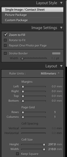

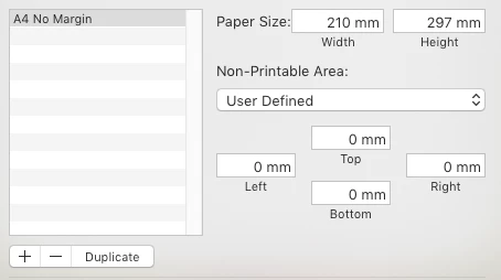

Hi Todd - I'm hitting another issue which is preventing me getting my exact required print size.
Under 'Develop' I have scaled the image to 210 x 297.
In the Print Module/ Page Setup I've got a custom size set - borderless, 210 x 297mm (or A4 in UK).
I've got no margins under the Layout Panel and the cell size is also 210 x 297mm.
However, when you look at the dimension 'label' on the image itself, it is fractionally off at 209.99 (there is a tiny white edge showing on the right - see image below) The 'zoom to fill' adjusts the height by a fraction to the right size but does nothing to the width and I can't figure out why!
There is also a white edge along the bottom of the image that disappears when I 'hide' the rulers. So I guess that's just some type of shadow and not actually margin?
The output of the photo with or without the white margin (top tip by the way) is fractionally off due to the above issues and I need it exact.
Any ideas? Thanks so much!
