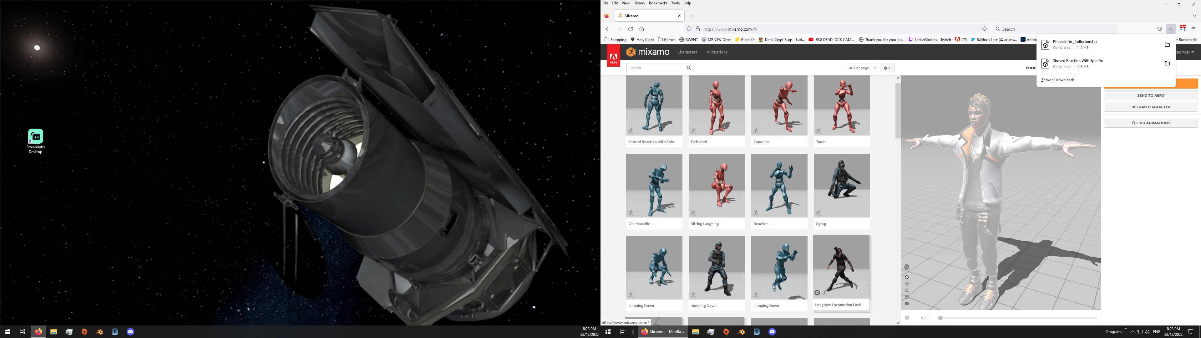

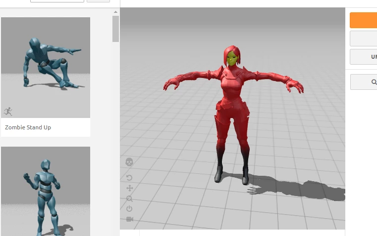

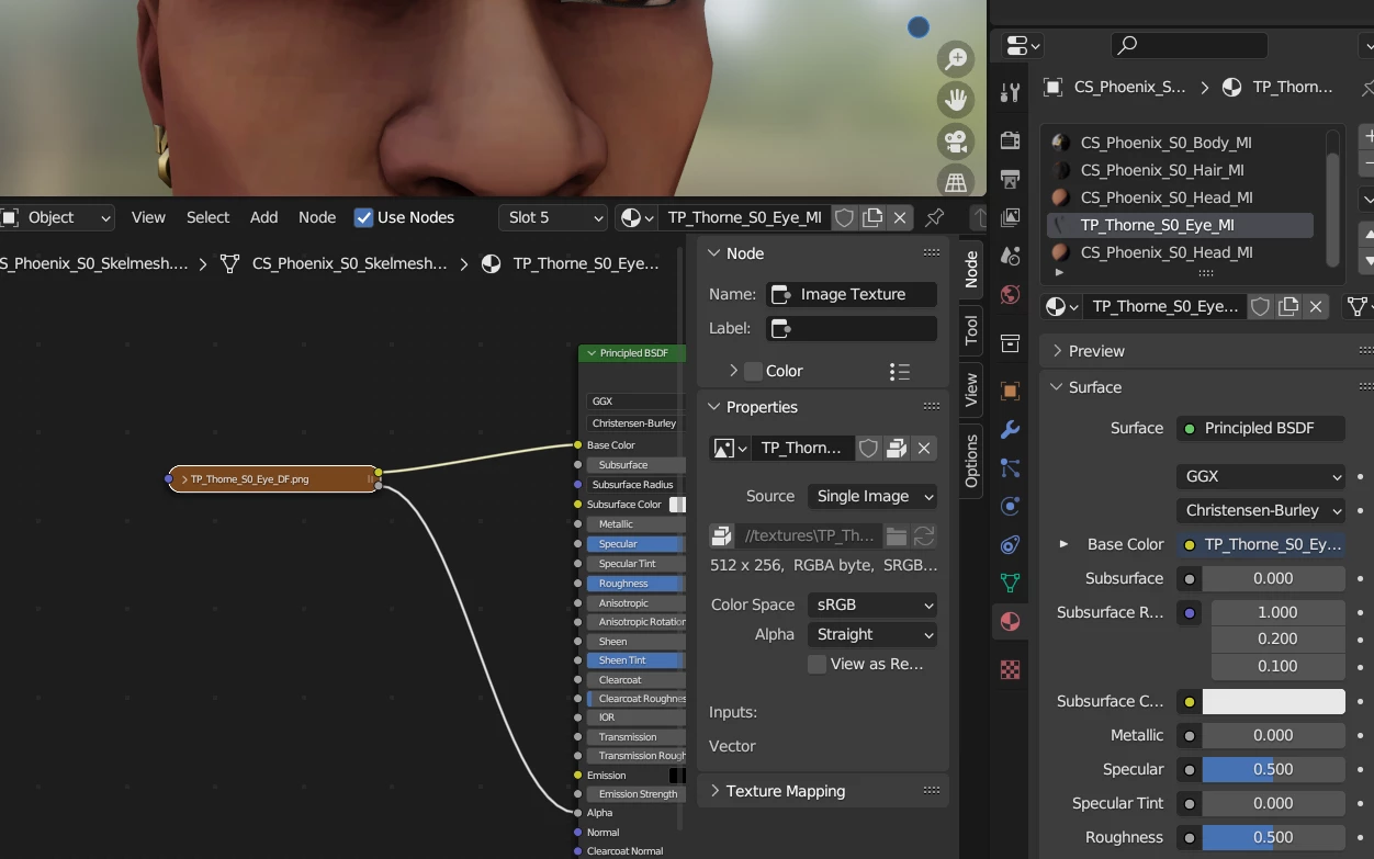

i can see your model has got textures so you could rig it in Mixamo then download the model and swap textures later... i also see your Blender screenshot shows you still have shading information attached to the model and that is causing Mixamo to misread it i.e, your model has more than 1 set of texture imformation in layers and Mixamo is only reading one layer
if you look at my model you see its a disfuse type file... thats also why Mixamo looks so metalic.
you can remove the shading information within Blender then add a texture image box, disfuse box and output box [adding another texture image box with the normal map is optional]
i'm on holidays for a week now but happy to come back after xmas but shading at its most basic is when you tell the model to glow with light and the textures act as a filter for that light... you intend to use Unity which doesn't use that type of shading so a disfuse / normal map will give better reults and Unity does use Apple drivers so the metalic look shouldn't be an issue

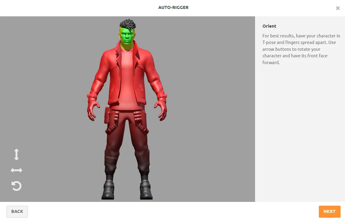

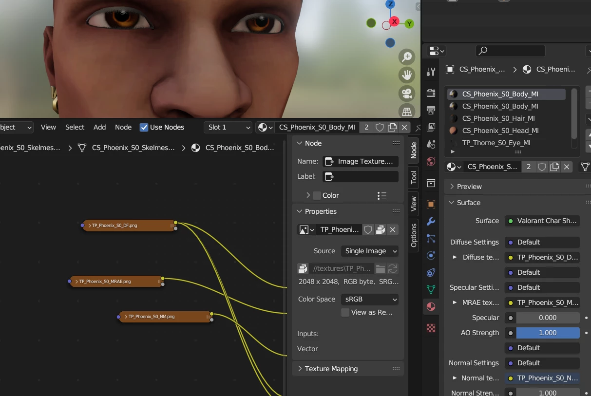

Hi. Thank you for your reply. The file that you attached works in mixamo! However, I would still like to do the entire process my self so I can do it for other agents/models in the pack and just for future reference.
Because of your reply, I was able to change all the .tga textures into .png. Once I did that and exported the model as a .fbx and imported it into mixamo, I still got the same result:
Could you outline the steps of what additional things you did to make it work in mixamo? Also, maybe I am choosing the wrong settings while exporting/importing the .fbx file in blender, so can you mention what those are as well?
Sorry for the incessant questions, but I would like to understand/learn this so I can fix problems like this in the future myself (plus, there is still the task of getting this into Unity which I will have to figure out).

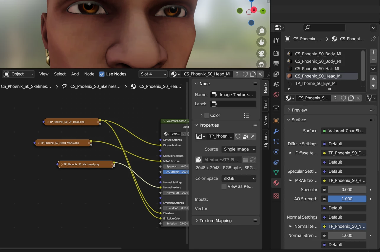

Just for your reference, here is where I am currently (changed all .tga textures into .png):

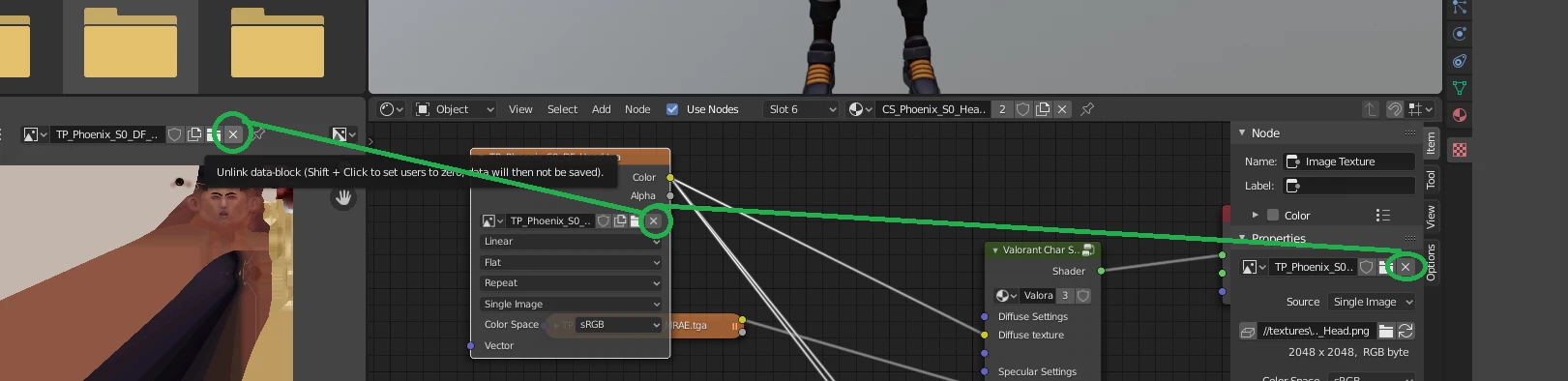

step 1 remove the current tga file by pressing the X [see image]
step 2 now press the open to pick the new image i.e Png or Jpg

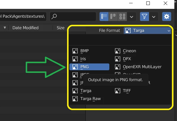

if your screen is wide enough it will now display the texture on the left you can hit the dropdown menu to set it to "image' if its on view and then press the "save as"
step 3 i made a folder called textures for this example and i recommend you do the same then change the file type in the top right right from Targa to something better like Png or Jpg*
save each texture you want to use as a new file so perhaps not the teeth then swap the Tga texture out with your new one and export your model from Blender and you should be good to go

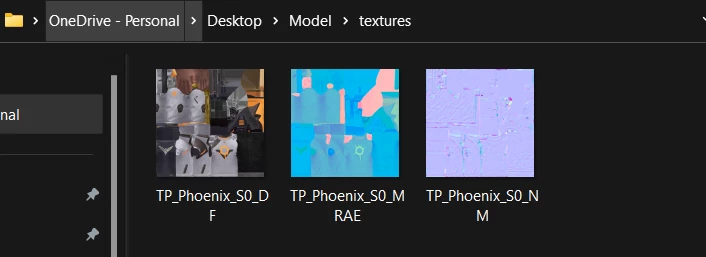

I was able to follow up to the point where I can save each texture as a png in the /textures folder I created:
However, how do I replace the tga one with this? When I choose the png picture as the source, it still shows up as tga:
