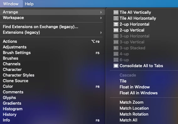

@dudej70268332 if you can afford it, having multiple screens go a long way! Even when I am teaching at the school, I have three screens. When I teach at home, I have two, plus my two tablets.
But to answer your question, this has happen to me, if my HDMI cable or USB-C comes out acidentally. I always work with the Application Frame on, and use the different tiling in the arrange in View. If by chance, I get  stuck. I can quickly 'Consolidate All to Tabs' to quickly get all up again, and then Tile it again or place where they should go on my second screen.
