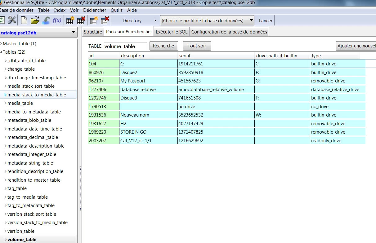

The location of the files in the database is stored in two separate pieces.
a- as you are expecting, the path of subfolders under the letter of the master folder of that drive
b- the internal database code of the drive, which describes the properties of that drive:
    - the most important one is the internal serial number read by Windows from the specifications of your physical drive
    - the drive letter assigned by Windows either on the first connection of the drive or by yourself as you could have done.
    - other info like drive type (builtin or external), drive denomination in Explorer...
So, the full location of the file is the full path starting with the drive letter followed by the path on the drive:  "E:/myphotos/Year2022/.....
The organizer keeps track of the various drives used in your catalog in a separate table. From the media table you have an internal (never displayed) numerical identifier for the drive from which the two pieces are found, letter drive and path, and which are concatenated to produced the full path you would use to specify a file yourself in the explorer.
Users who are proficient in sqlite database management and Windows commands could solve your problem by editing the media and/or volume_table. That what explained in an old conversation some ten years ago but my bookmarks have disappeared in the forum upgrades...
