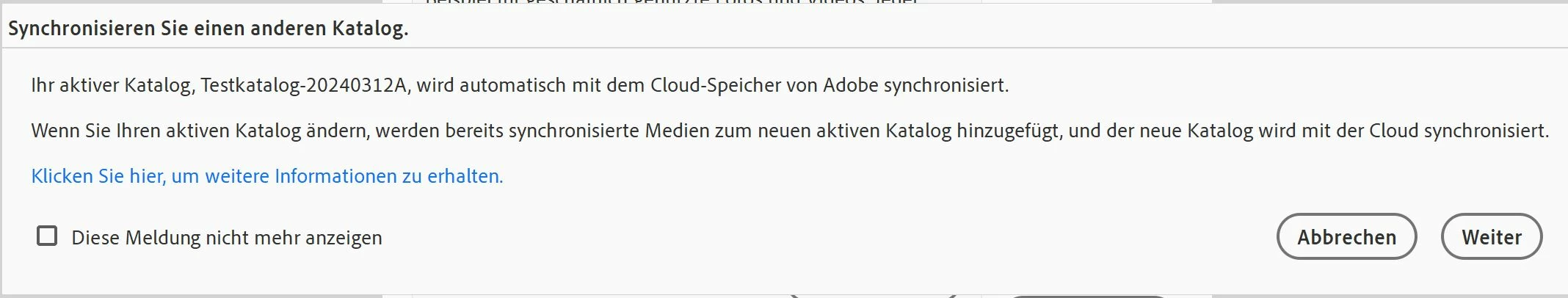

If Autosync is only available in the English version I cannot understand what goes on when I try to create a new catalog:
I get a message telling me that the current catalog and the mediafiles referenced will be uploaded to Adobe, and I have to confirm this.
Further there is still the UI bug with Preferences as I described earlier.
Mar 12, 2024 9:15 AM UTC
Correction: The message appears when I change to another catalog (not when creating catalog) - sorry.
Here is the message I get (sorry but it is in german language):

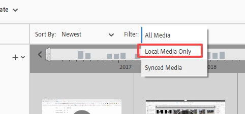

What happens if you press Ctrl+K and then the down arrow key several times?  What should happen is that the Organizer's Preferences dialog opens and you can move between the tabs until you reach the Auto synch tab.
Auto-synch should be turned off by default for a new catalog.  However, any images that have previously been uploaded to the Elements Cloud/Web will appear automatically in a new catalog.  These can be filtered from view using the Local Media Only option from the Filter dropdown menu:
Since there appears to be a bug in the German language UI, I will report it to Adobe.  But it would be helpful if you coud give some further information:
