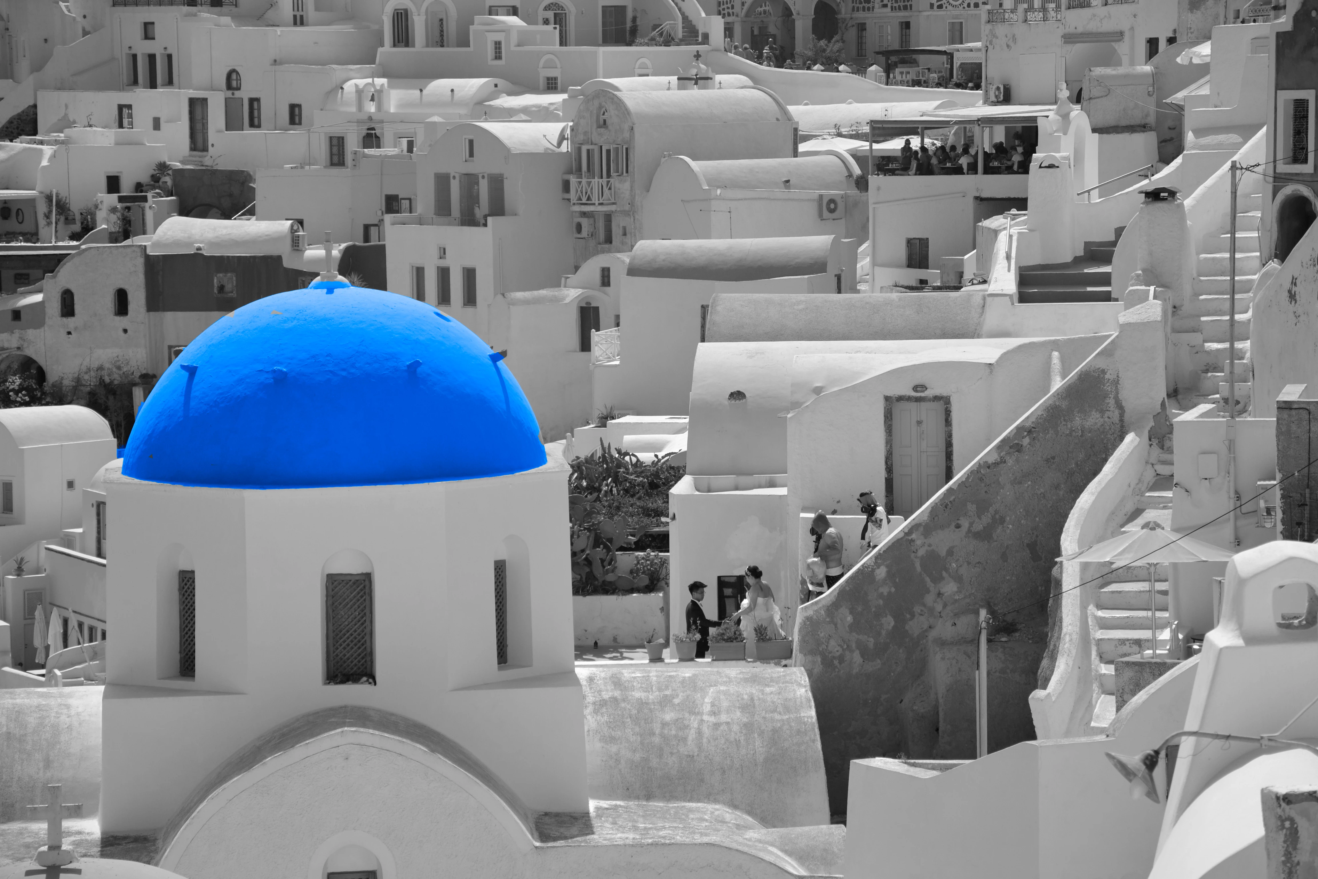

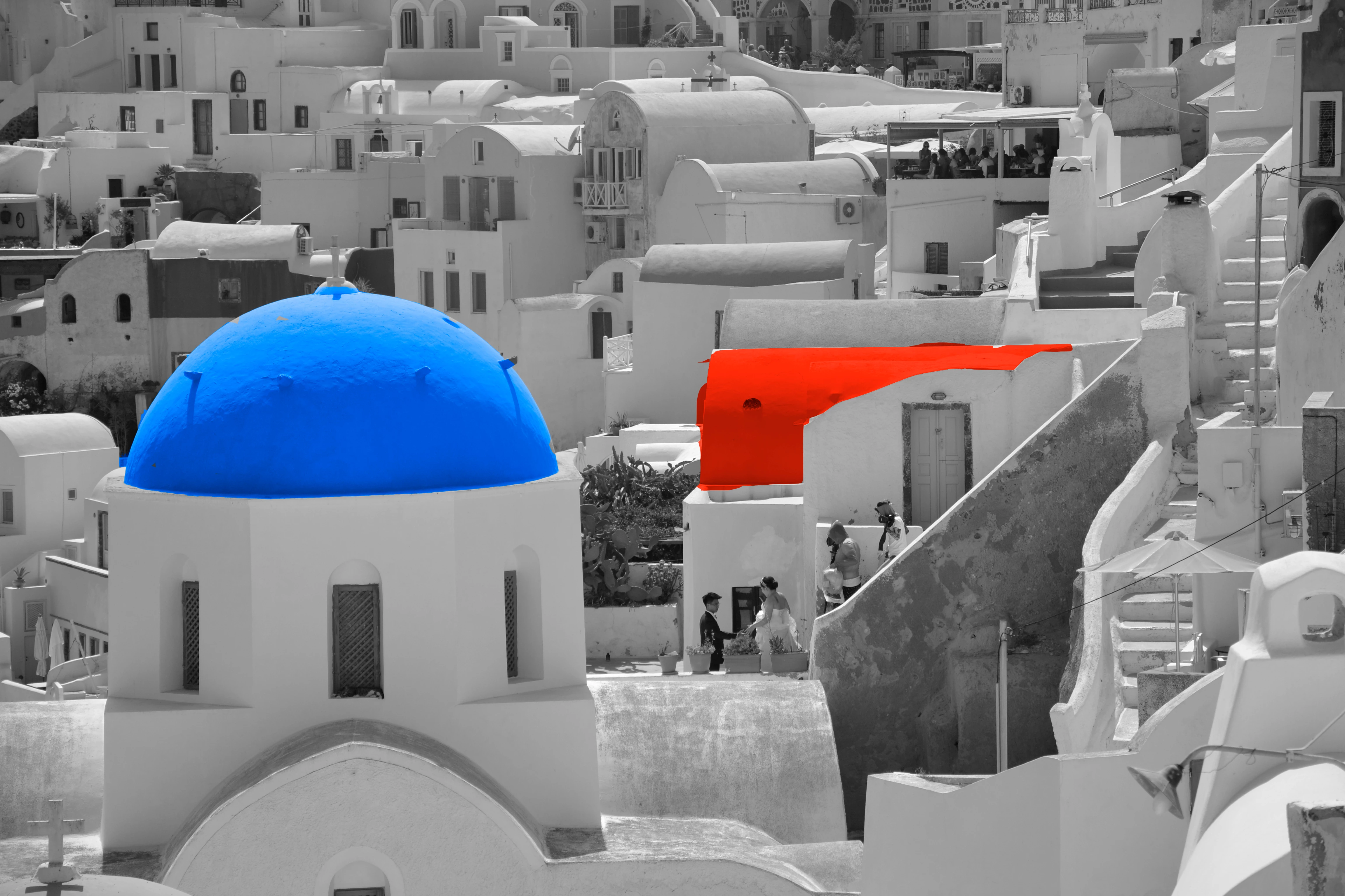

    Yes, it is possible.  Here is one way:
    1. Under the Image>Mode menu, make sure the black and white image is in RGB Color mode.
    2. Create a new layer.
    3. Change the blend mode to Color.
    4. Select a brush ().
    5. Select your desired color for the roof.
    6. Paint over the roof with the brush.
    7. Voila!!
    You may want to play around with the type of brush, the opacity of the brush and/or the layer opacity.  You can also make a selection of the roof to make the painting easier.

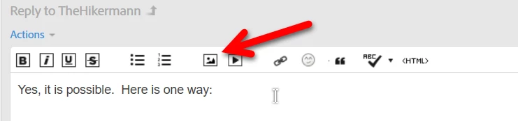

    And for future reference, pictures can only be attached to a post using the forum, not via email.  Simply click on the Insert Image icon:
