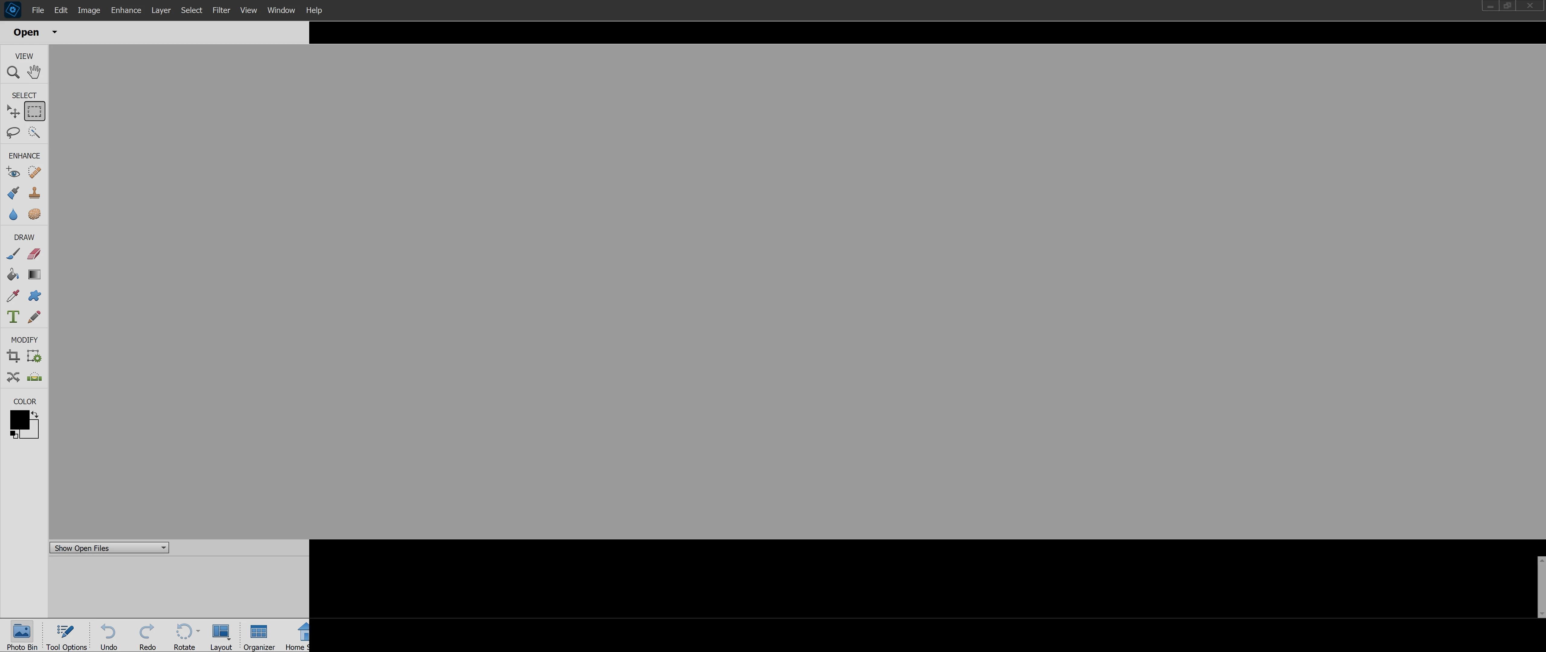

I'm using Windows 11 (but the same problem occurred with Windows 10) and have Photoshop Elements Version 21.0 installed.
As shown in the attached file, part of the upper panel showing basic, guided and expert views, and also part of the lower panel are blacked out. So I have to move my cursor around and guess where the basic or expert views are located, and when I open one of the tools, much of it doesn't show, nor do all the photos that I have opened because they are in the blacked-out area.

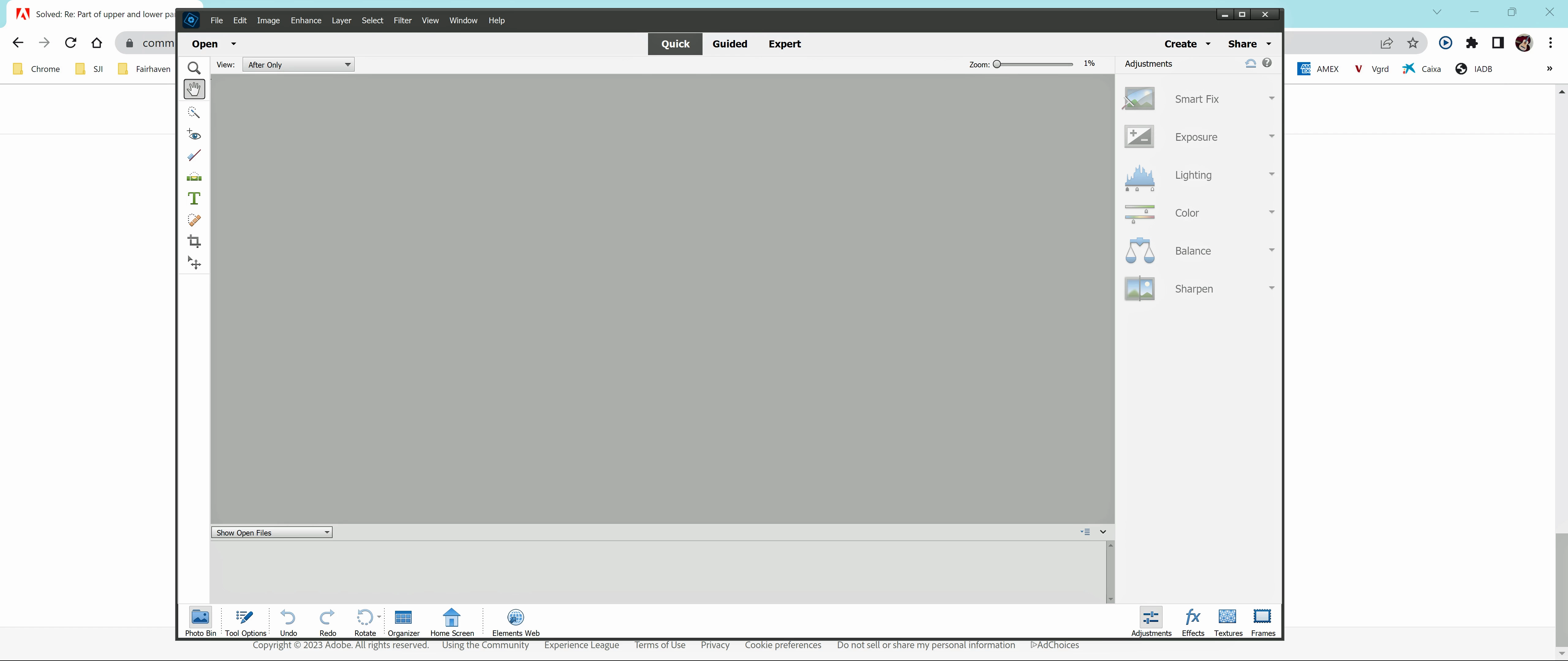

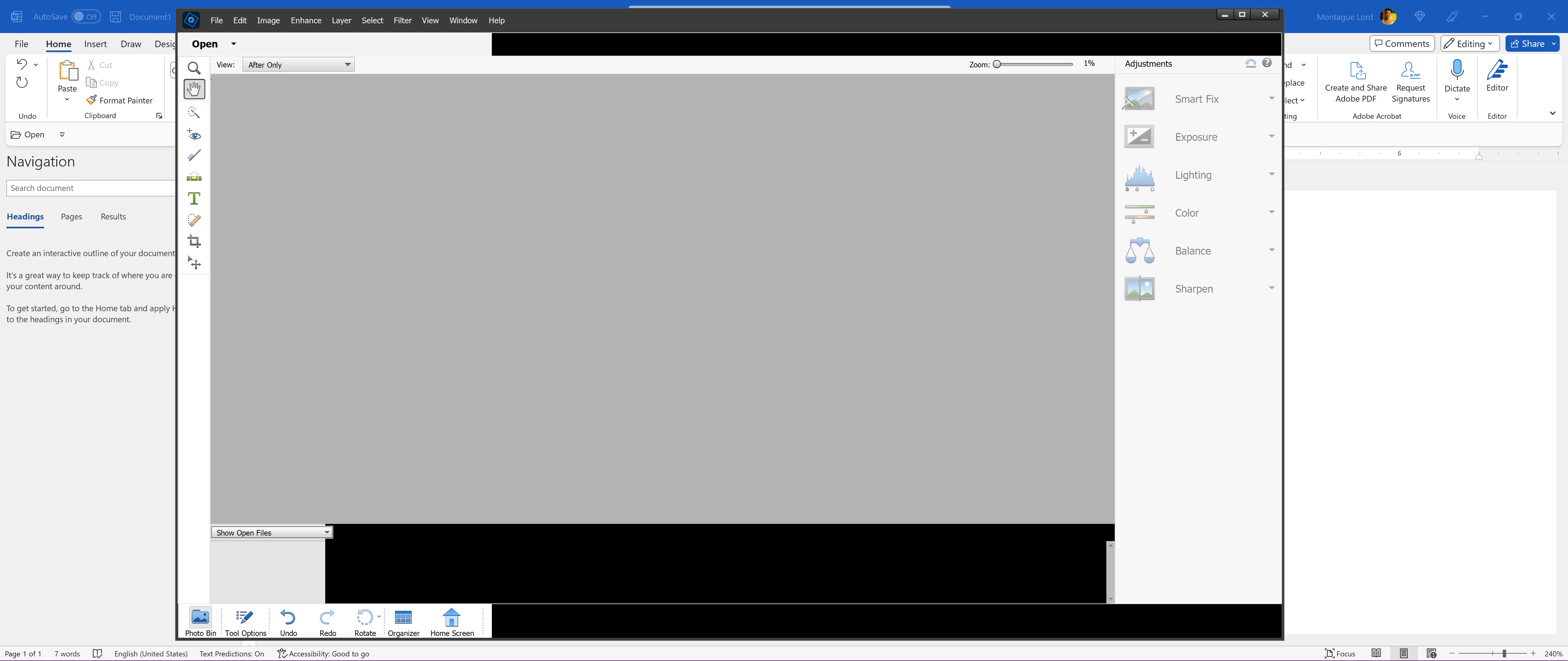

Greg, attached are two screenshots:
Screenshot 1: Photoshop Elements opened with it already in windowed mode. Result: Editor menu control options become available without the black bar.
Screenshot 2: Photoshop Elements opened in full-screen mode and then changed to windowed mode. Result: Editor menu control options retain the black bar.
My ultrawide screen display is set at the recommended 5120 x 2160 resolution.

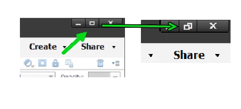

@trueLuminus, as an alternative to changing the screen resolution, try my other suggestion of getting out of the  Maximize window option by clicking on the middle of the 3 Windows boxes at the top right of the Editor's window.   You can then reduce the size of the window so that the Editor menu control options become available without the black bar.
