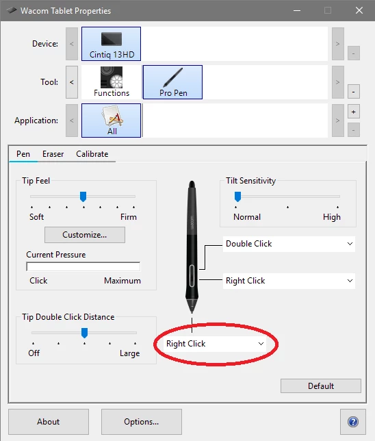

I know this is a really old issue, but since I had this problem and NOTHING seemed to work for me, I thought I'd post a solution I've found and the only one that seems to work. It's a bit of a hassle but so much better than not even being able to use the program whatsoever.
1. Open Wacom Tablet Properties (leave Windows Ink on)
2. Go to the Pro Pen tab
3. Double click the primary "click" option
4. Change it to "right click"
NATURALLY this is like changing the left click on your mouse to be a right click, but within the program itself, there is LITERALLY no difference between the two. In older versions of elements there doesn't seem to be a difference between left and right click, so within the application itself it's basically as if you changed nothing, except pen pressure should start working correctly.
The only issue with this solution is that when you're finished working in the program, you'll want to change the "right click" back to the standard "click" option, but like I said - that's really a trivial issue compared to not being able to use pen pressure at all. Hope this helps someone.
