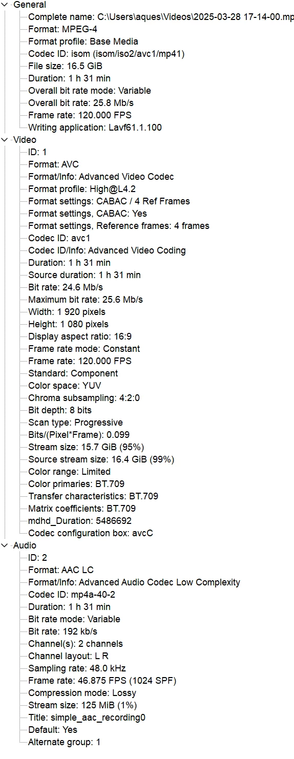

You could use Shutter Encoder to convert the files (before editing) to ProRes LT or even ProRes PROXY format (within Shutter Encoder) for easy to edit formats. Try reducing the frame rate in Shutter encoder also: https://www.shutterencoder.com/en/

Try a different output codec, like (Quicktime) ProRes LT (or even Proxy). As for your footage, it's typical h.264. Again, export a short bit, see how it works out.
Mar 30, 2025 5:09 PM UTC
So I've tried the 60 fps it did't seem to change much for exports and the current sequence. I've updated the bit rate to 30 and I've posted the "tree".
