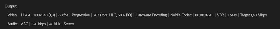

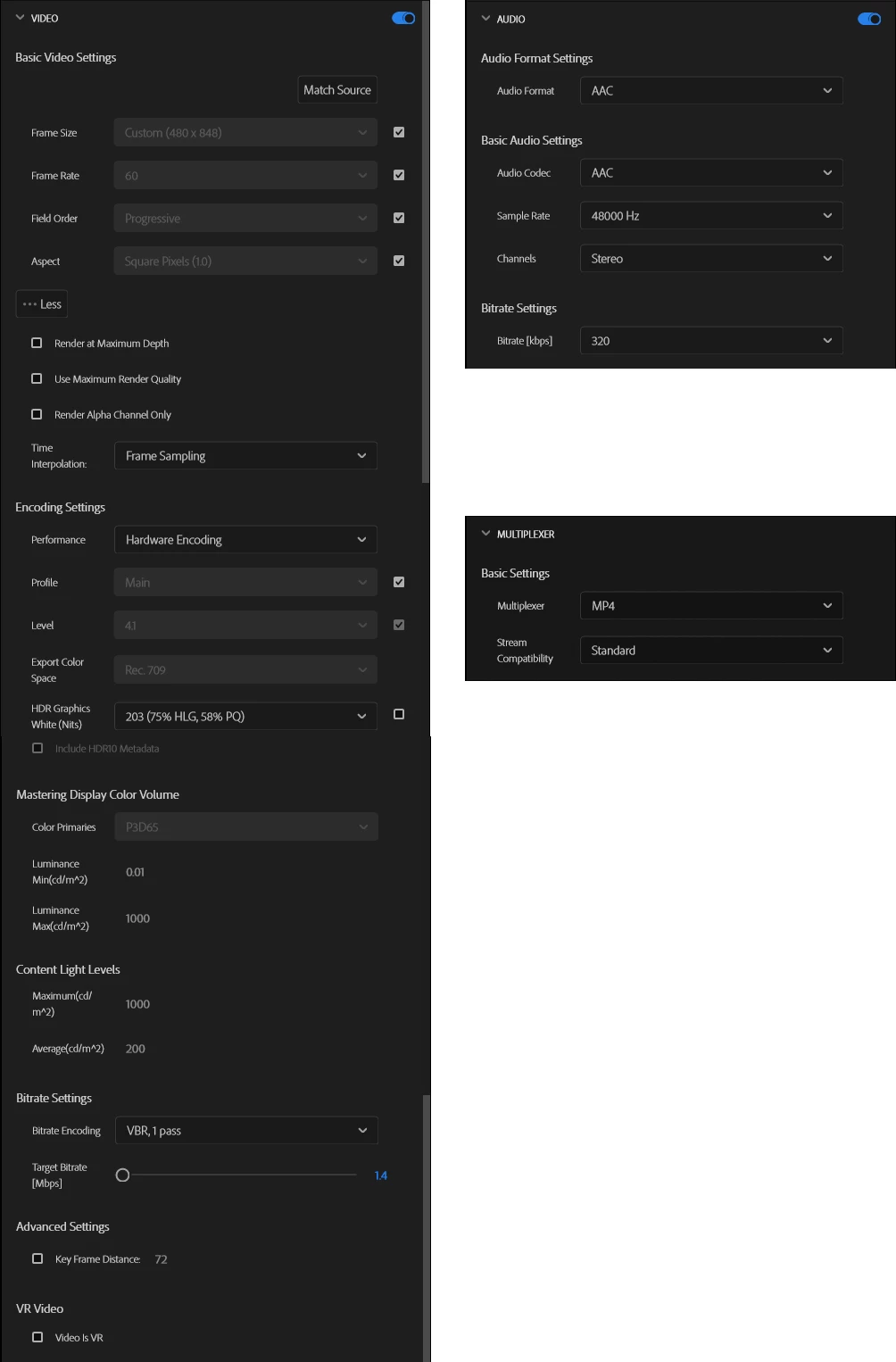

svens82Author
Nov 25, 2024 5:43 PM UTC
Hi @jamieclarke
Yes, the Multimixer is MP4.
All these screenshots are from my current video, but this appears in 4 out of 5 clips.
jamieclarke
Nov 25, 2024 4:56 PM UTC
Hi @svens82 - We need to see all of your export settings not just the summary.  If you can screenshot all of your video and audio settings that would help a lot.
Did you check the multiplexer?
