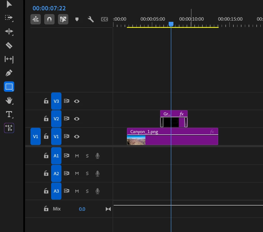

Attached is a simple capture of a timeline with a graphic on it (V1)
Drag the rectangle onto the preview screen where you need it with V2 track enabled above. It will create a track with the graphic of the rectangle on it.

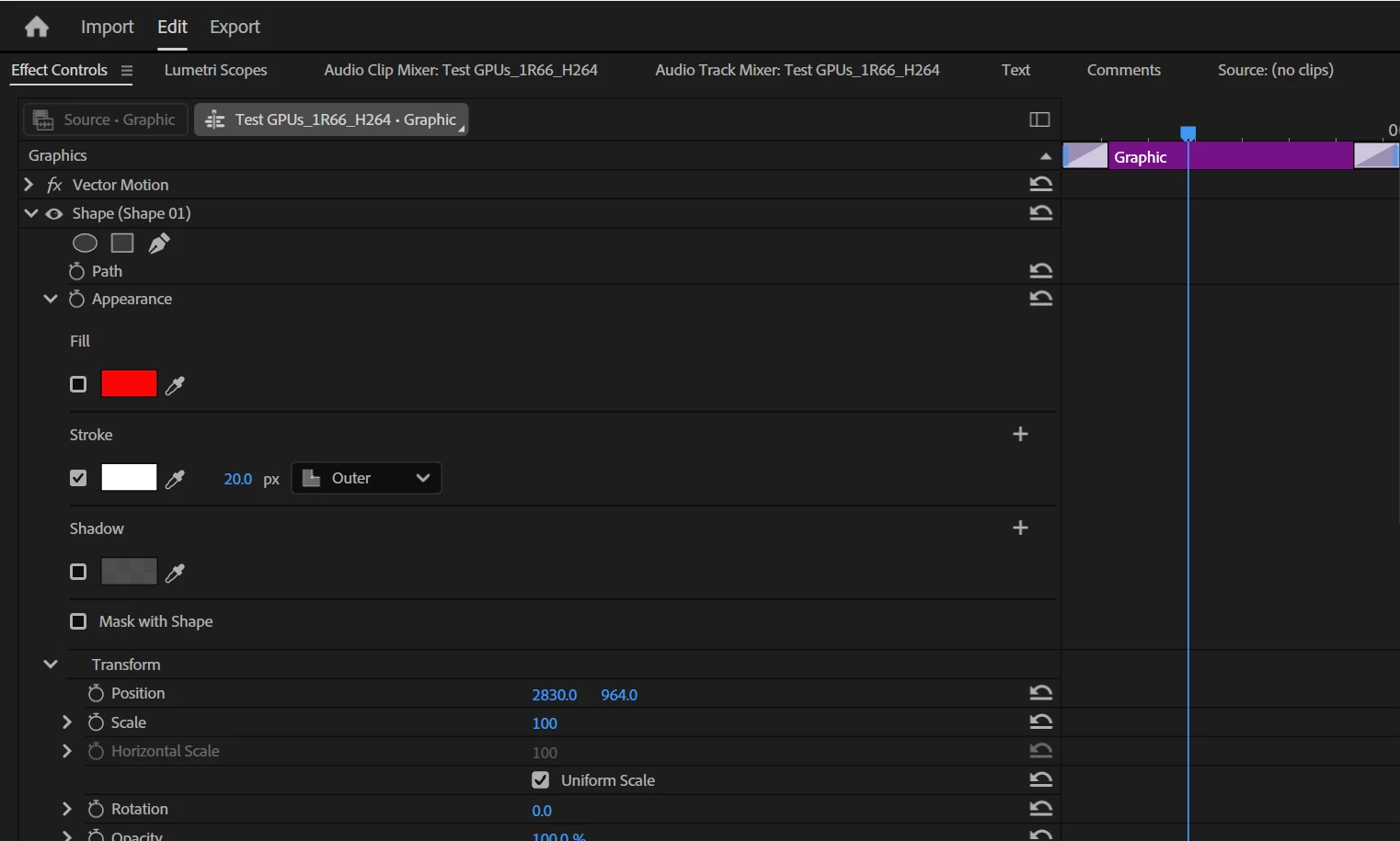

Define your settings for the rectangle in the Effects panel under the 'Shape' category, position scales line width etc

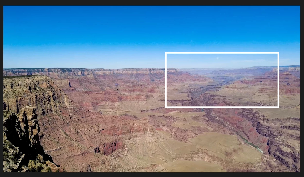

Finished result of preview window with graphic. Simply define length it appears by increasing and decreasing the length of the graphic clip on V2.
You can add a cross dissolve for example on start and end of the graphic clip so it blends in and out smoothly.
