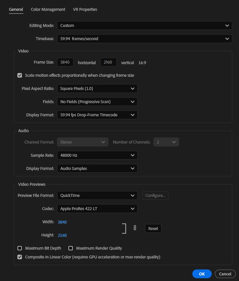

jamieclarke
Jul 31, 2025 2:20 PM UTC
Hi @RedBengal - Thanks for submitting your bug report. We need a few more details to try to help with the issue.
Please see, How to Report a Problem.
Can you post a screenshot of your Sequence Settings?
Sorry for the frustration.
