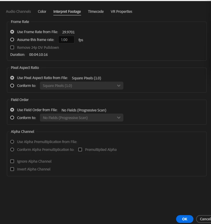

Aug 13, 2025 12:53 AM UTC
@jamieclarke  10 minutes ago this clip worked. I applied a LUT, then removed it, and now it's frozen. The others I haven't applied a LUT to at all.

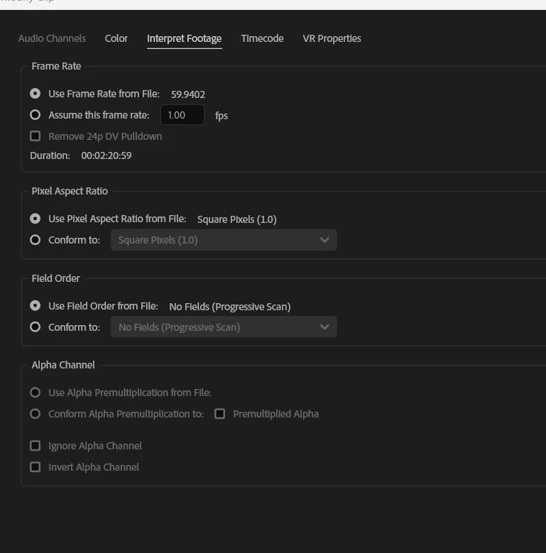

Aug 13, 2025 12:39 AM UTC
@jamieclarke  Found one more. Screen grab here.

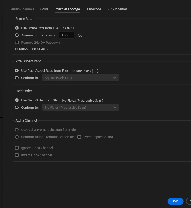

RedBengalAuthor
Aug 13, 2025 12:36 AM UTC
@jamieclarke  Sorry I've been away from this. Here is the screen shot. Right now it's just this one file, that I have three seperate clips from in the timeline.
